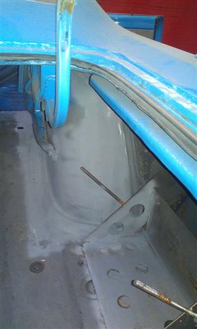

Anton has been busy again, building Lee's Mustang engine and making Don's tubs a little bigger.
IMAG1294 (Small).jpg (25.08 KiB) Viewed 2449 times
IMAG1293 (Small).jpg (61.79 KiB) Viewed 2449 times
IMAG1288 (Small).jpg (28.03 KiB) Viewed 2449 times
IMAG1287 (Small).jpg (95.8 KiB) Viewed 2449 times

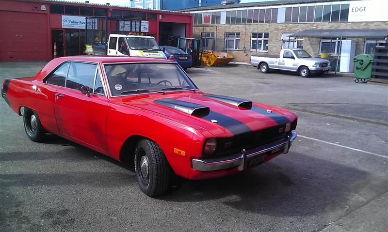

And another one arrives for work, Sam's Dart, what a pain in the butt it is to fit headers to an A body, but it will be worth it in the end..................How do you guys with a big block get on fitting headers in an A body.
And yes Matt you are right.
IMAG1400 (Medium).jpg (75.71 KiB) Viewed 2027 times
Don
Posts: 1844
Post by Don »
bad enough fitting them in a b body del, i've got mine off at the mo and they're a pain in the 4rse, chopped them back as far as i can so as to stay 3.5 all the way through :? Sams dart lookin good :thumbright:
