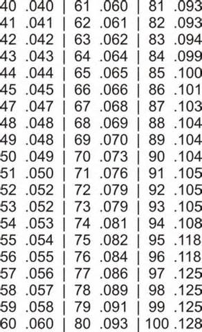

Posts: 8368
Something to remember when jetting- Holley jet sizes don't refer to the actual hole size, it's just a numerical reference number, eg a 99 Holley jet is 0.125"
If you have MaxJet jet's, they're referred to by actual drilling size, Luckily they're easy to spot!
Holley jet chart.jpg (40.76 KiB) Viewed 1281 times
