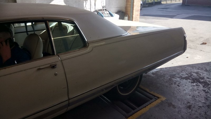

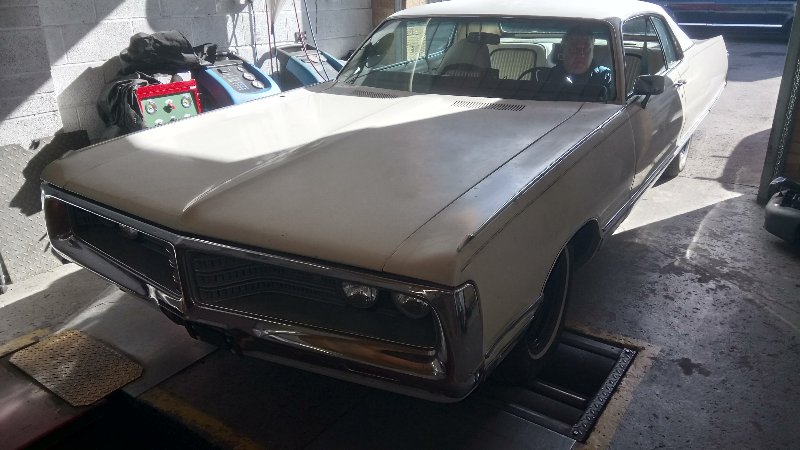

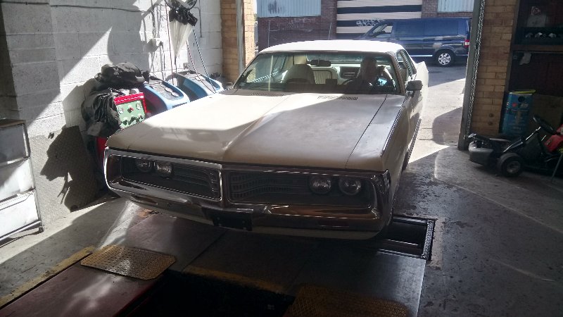

MOT time today....passed with no advisories... Im chuffed!
She drove well and pulls like a train! Bit of a stumble off idle but better when warm. think its carburettor related so will have a read up etc.
Just filling in the registration docs so will hopefully be cruising round Brum in her soon,
Cheers Steve :D :D

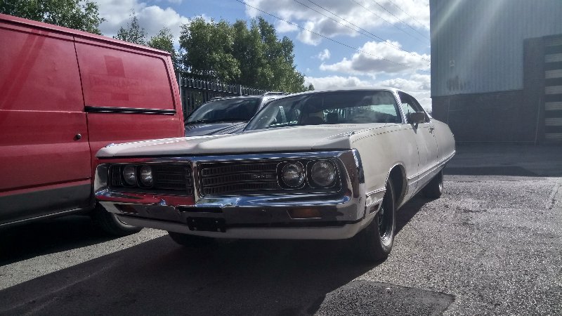

Few pics...
Posts: 7613
Re: Steves 72 New Yorker
Few more...

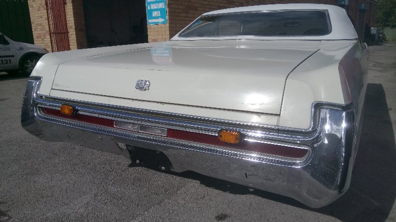

But you really need to lose those amber lights!

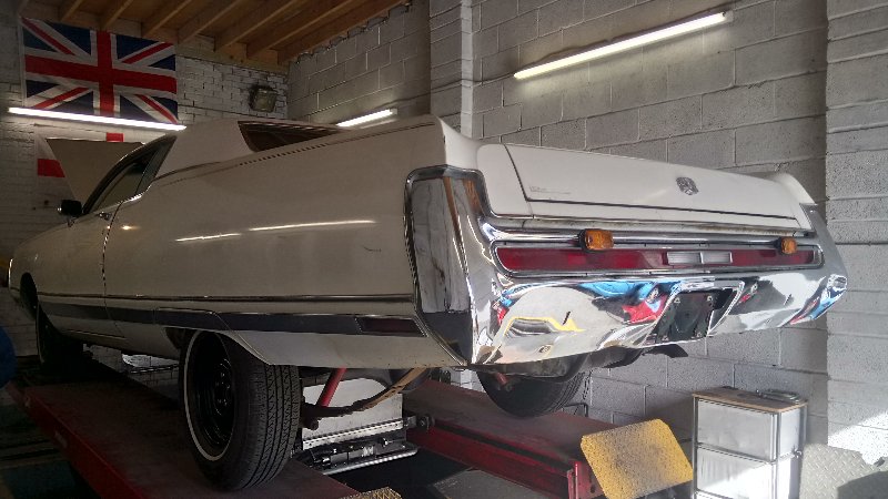

Yeah Stu....but I had to get it through the MOT and although the guy I use is good as gold, needed to see orange at the back. I have rewired the original lighting with orange LEDs into the second light apertures in from both sides. Looked great until I moved the car ready to take for MOT and realised that they don't show through the frosted section of the rear light glass and are only visible when viewed side on. I plan to move them out to the end lenses on both sides but it was 'any port in a storm' one hour before MOT time. I was working in a very confined space next to a fence so couldn't view them straight on. Another option would be to very carefully cut out a section from the original lens and match a section of orange to it. Then I could somehow drop that into the cutout. I wanted to keep the marker lights as far out as possible but wish now I had wired the indicators into both extreme outside pods and the markers in pods 2,3, 5 and 6. Anyway, it got me through and I can now tinker to get the original look back. Pity the back up lights are so central (pods 4 and 5)
Cheers Steve
