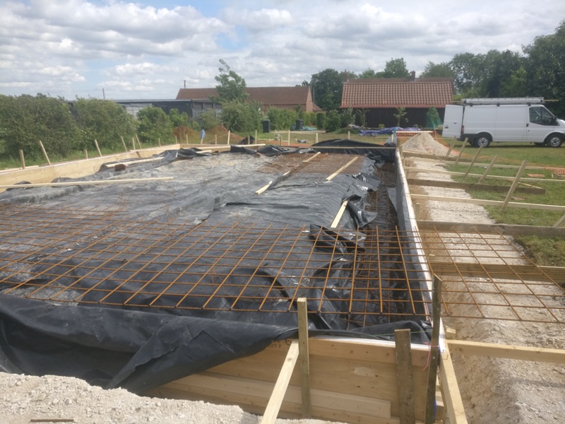

Super Sloth wrote:Can you explain what the cream gravel does and why you've dug a moat around the perimeter?
Genuinely interested - I just have no idea how a building goes together! :oops:
Hi,
Sure thing - we removed 850mm down all the way over the entire area and filled it then with all the hardcore, compacting in 150mm layers.
Then removed the deep areas seen for the concrete to collect in, as the base is a structual raft rather than your normal 'pad' design under each building support you might see on a farm for example.
Reason for this is the clay soil conditions and hedge nearby. Also this has to be much better build to meet building regulations as this will be occupied by humans rather than just cattle/hay.
It has been over designed.

Shuttering done with a lot of wood.
A lot of A393 mesh and rebar to the designed spec

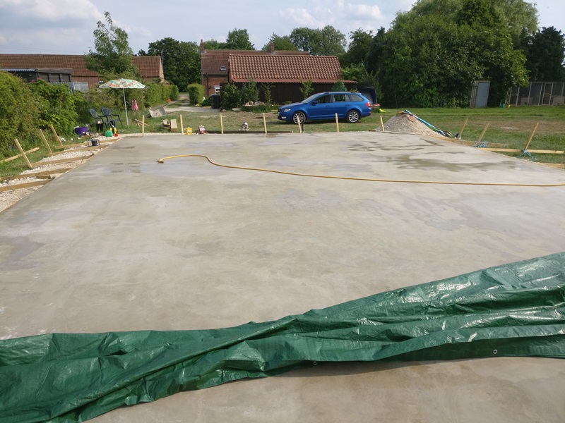

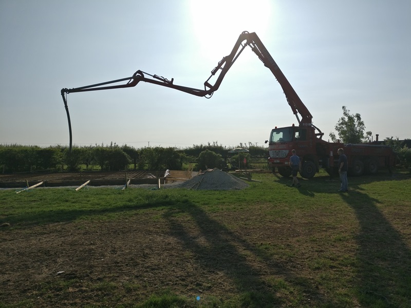

update, concrete in. 36m cubed.
Damn that was hard work, happy with the finish though :D

thats alot of concrete how many inches deep are you going for the floor? looks like your over engineering it , definately better in the long run :)
life is like a box of chocolates you never know what your going to get next
GJUK
Posts: 2486
Post by GJUK »
Hello,
its 200mm thick over the entire slab, at the edges it is 800mm deep.
Yes - it is not going to move anytime soon :D
48 hours since the pour and no cracks so far :thumbright:

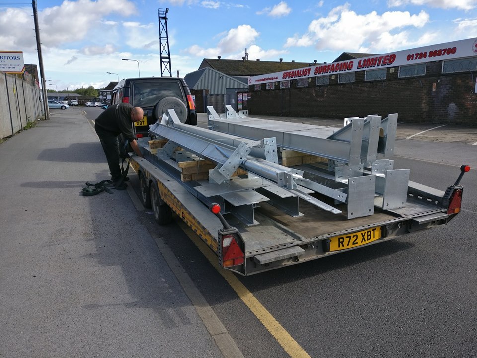

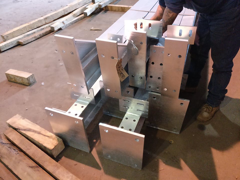

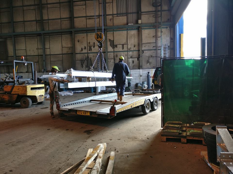

So the frame was picked up the other week:
GJUK
Posts: 2486
Post by GJUK »
pic

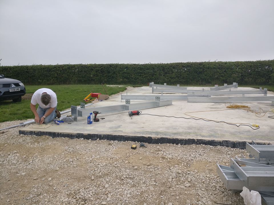

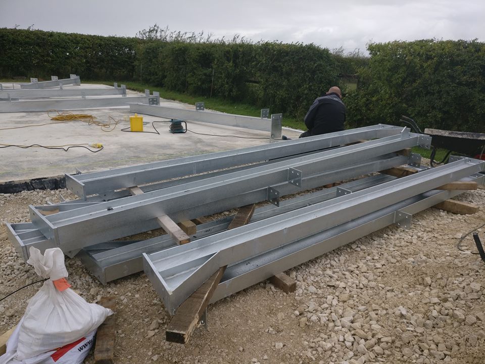

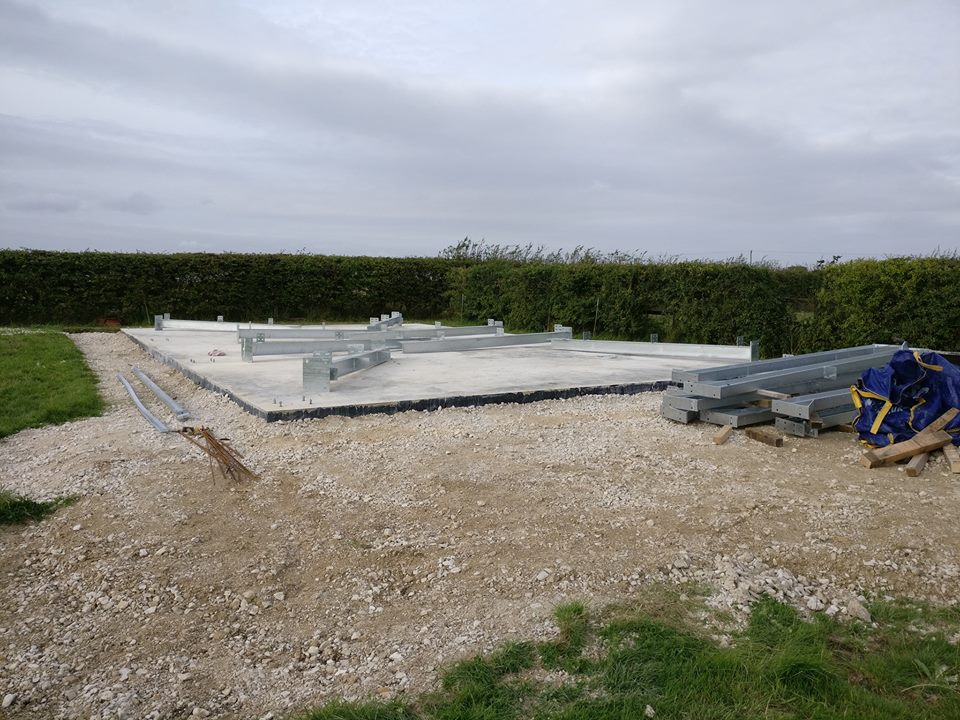

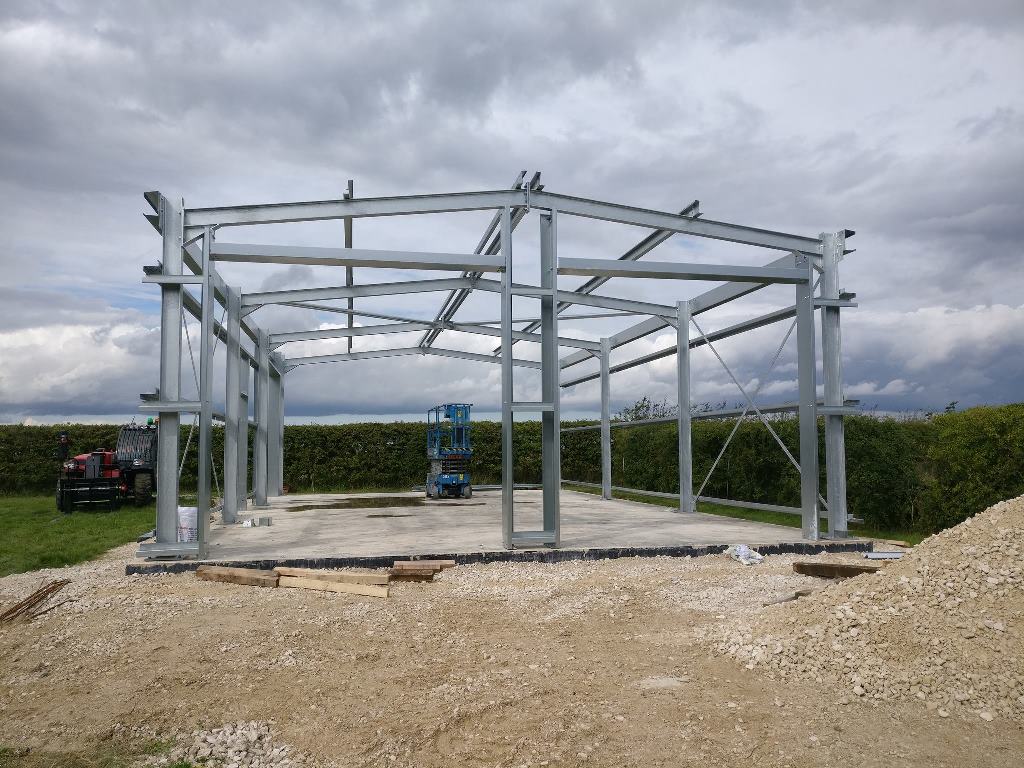

Build has started - epoxy bolts in.
GJUK
Posts: 2486
ta-da
