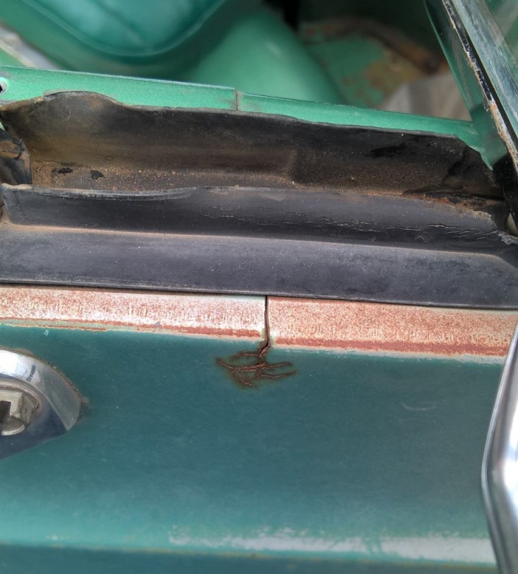

Last night I repaired a crack in the front pass door and waxoyled. 5 more doors to go...

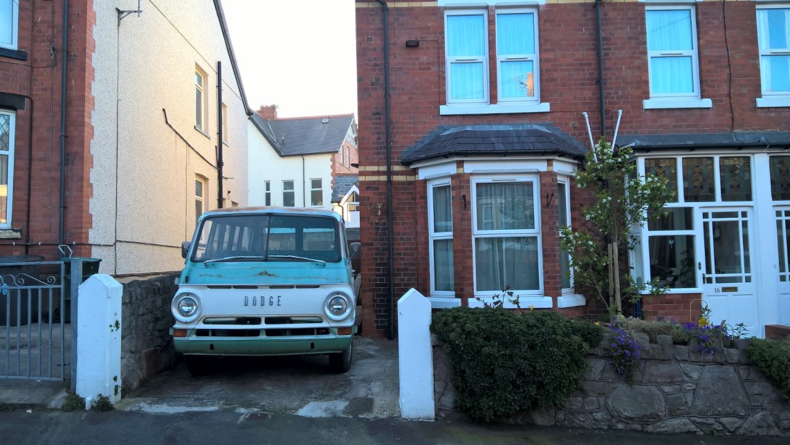

Pic 1- Safely in it's new home. It's actually slightly smaller than the Truk so I can get it on the drive and work on it easily :thumbright:

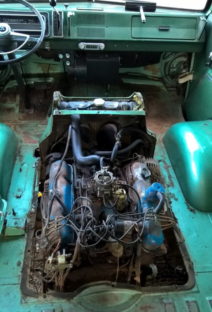

Pic 2- The motor after days of cleaning. I know it doesn't look it, but it was basically all one colour before- I scraped off half a bucketful of gak, literally. It weighed 8lbs!
I have some chrome rocker covers and an elec dissy to go on at some point.

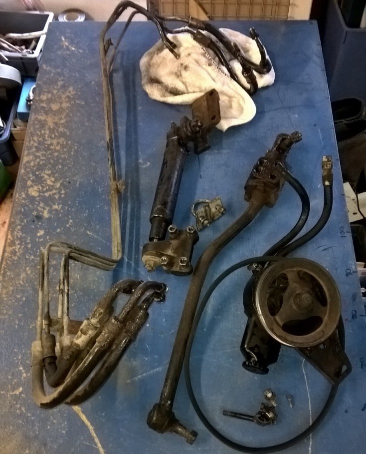

Pic 3- This is the entire power steering system removed. The drag link (right of centre) is the part that's replaced to convert to manual. The arm from the steering column operates a 2-way valve at the top end, sending fluid to the left or right of the ram (middle of pic). One end of this bolts to the leaf spring shackle, the other is U-bolted to the steering rod. Quite clever in it's own simple way!

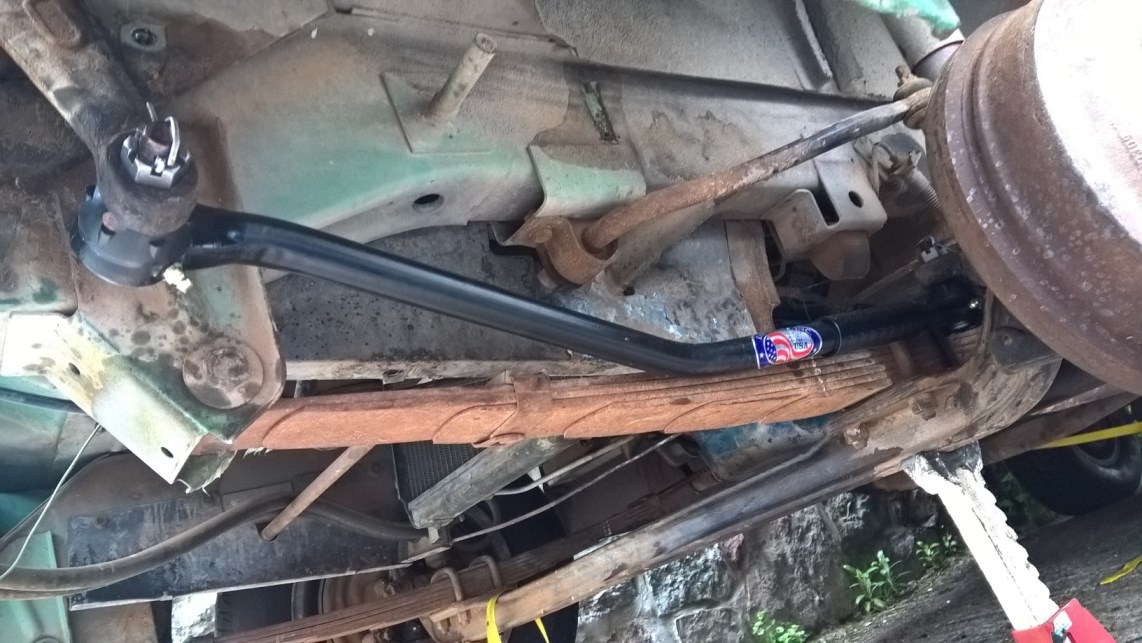

Pic 4- The new manual drag link

I forgot to say although it starts and runs perfectly, it stalled as soo as it came off fast idle. I stripped, cleaned and rebuilt the carb and it now idles perfectly :D

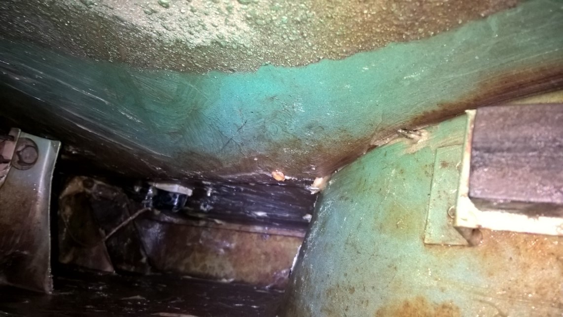

Pic 5- Strange cracks in the top of the passenger door, on the inner and outer panels. I did some delicate welding and only lost about 1" square of paint. I'm not painting the Bus so I wanted to do as neat and non-invasive a job as possible.
Pic 6- Once the welding was done I got inside the door, scraped and hovered out the compacted desert dust which is everywhere! and slapped in a load of Waxoyl.

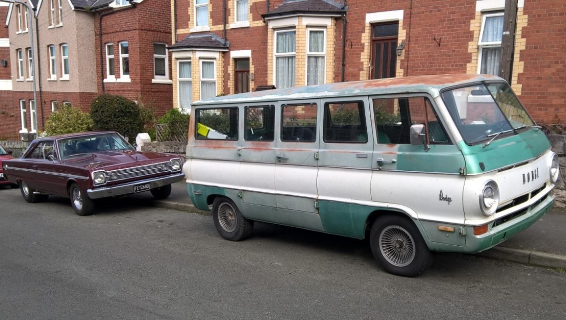

Pic 8- There goes the neighbourhood 8-)
