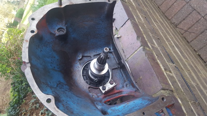

I have a car bellhousing coming, It shold make all the differance. The input shaft should be in the back of the crank flange by abut 22/24 mm ;)

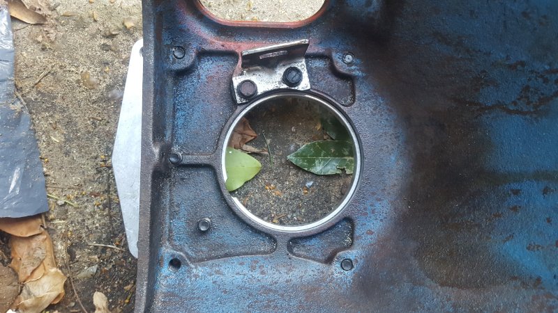

aim for something like this
bell mounted to block with flywheel on
block on its side
move the trans into the back of the bell until the end of the input shaft sits into the hub of the flywheel to the point where the spline end is level with the fiction face.
measure the gap between the back of the bell and the front of the box.....
that gives you your wiggle room on adapter thickness
by bell had offset lower left (in picture) mounting hole right on the side of the adapter
so i drilled and tapped two more holes
belt n braces and all that. would have been fine with just 3 bolts but...you know. toss up between an adapter that could easily be centred into the bell housing hole or one that would be a pig but had more space for new holes
centreing was key for me so i had to cater for the 4 offset mounting hole in other ways
Paul coffy at modern driveline was very helpful has a 67 falcon loves a ford, knows nout about chryslers but affable helpful and his adapters are $100 to 200
way cheaper than the $700 or so necessary to extract similar out of castlemaine rod shop or dellow conversions/automotive in oz

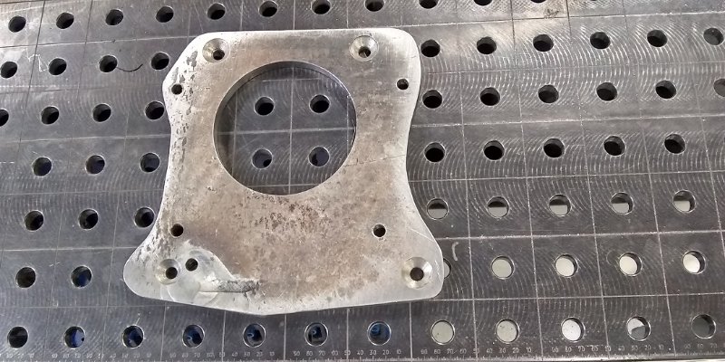

Thanks Dave,

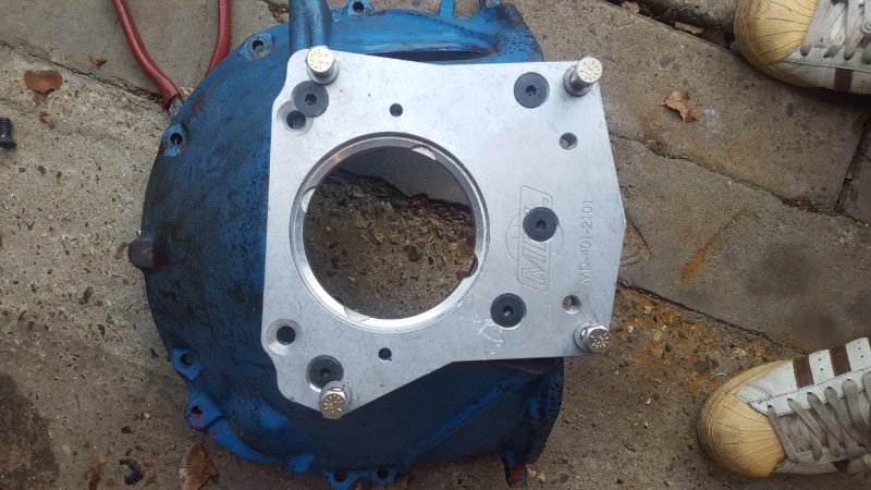

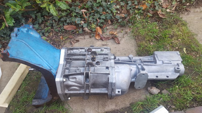

This is what ive have made to mate them, I used the centre hole to line everything up.
Just need to drill one more holeImage

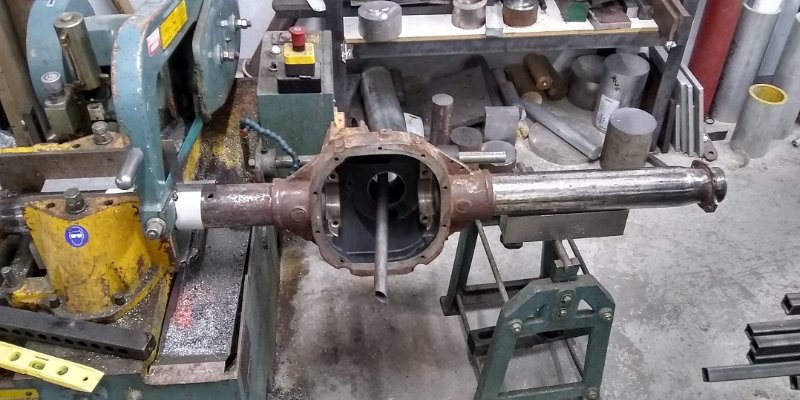

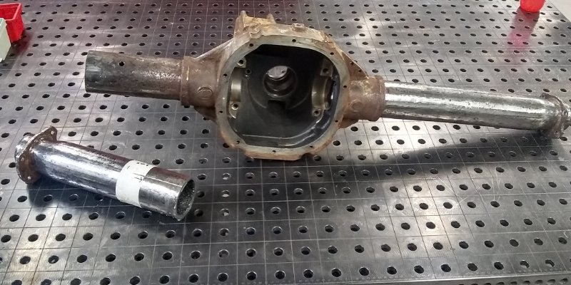

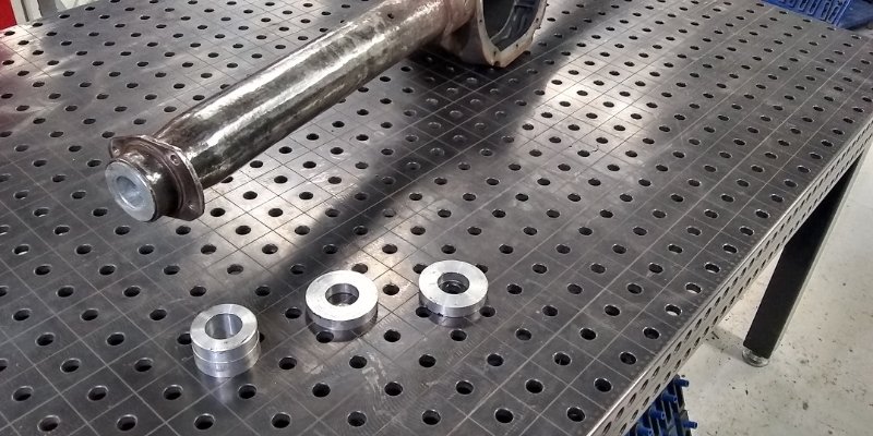

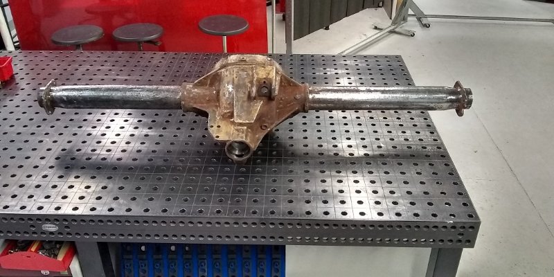

On the rear axle, I found out that the mustangs 7.5 rear axle may not be up to the job of running a V8.
Ford Explorer, as these things have an 8.8 LSD rear axle beefy enough to take the V8
I need to narrow the axle so I can get some nice deep dish wheels on the car, I was going to have this done by someone .But decided to give it a go myself :unsure:
After fighting with the 70kg rear axle on my own to get it out, cleaned it up and cut off all the original mountings.
TIB3300
Posts: 631
Location: Sheffield
Re: Cortina MK3 V8 MOPAR
Post by TIB3300 »

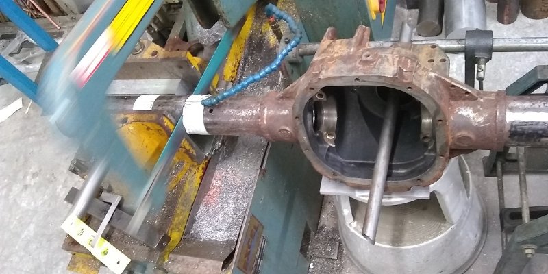

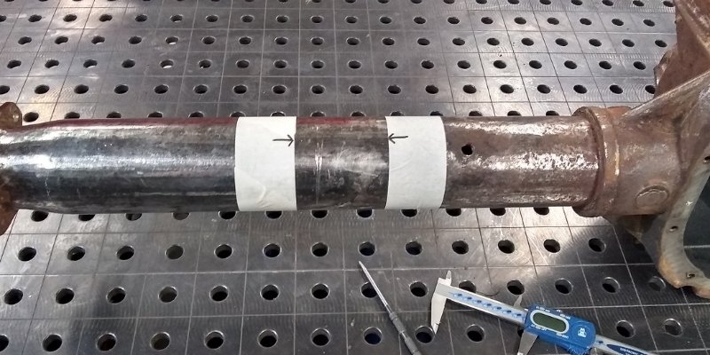

The thing with the explorer rear axle is these axles are actually narrower then the cortina by 10mm,
But I want to narrowed it by another 3in, I was going to buy some Moser shafts made to measure at a cost of £460 + vat and carrage.
But after some research and noticing that one half shaft is 3in shorter then the other. It made sense just to buy another short shaft £80
So after mesuring both the long shaft and he short shaft, I figure I can cut the casing down by 77.598 mm
