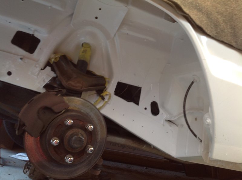

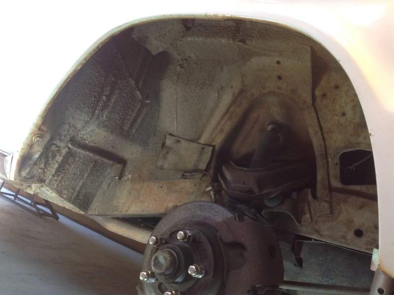

So having scraped off some of the underseal to weld in the floor patches, I found a load more loose and missing so stripped it all back as far as I could, cleaned things up and gave it a shot of converter and a couple of coats of enamel.
Floor 60.jpg (48.75 KiB) Viewed 13773 times
Floor 61.jpg (69.92 KiB) Viewed 13773 times
Floor 62.jpg (53.62 KiB) Viewed 13773 times
Floor 63.jpg (64.56 KiB) Viewed 13773 times
I've only got room to work on one side at a time easily, so now to turn her around and do the other side.... :(

Hmm, no great skill needed, just stubbornness/stupidity in spending god knows how many hours with debris,rust, underseal or paint getting in your eyes, nose, mouth, hair and down the back of your neck.....
Oh well, here goes.
Floor 64.jpg (65.17 KiB) Viewed 13720 times
Floor 65.jpg (66.03 KiB) Viewed 13720 times

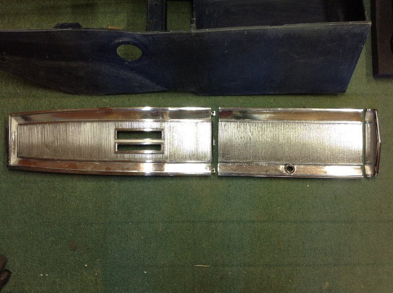

I'd never realised until looking at some interior pictures recently, that the smooth band round the ribbed centre section of the main chrome panels is supposed to be painted in a sort of satin silver colour ! Looking closely there are traces of it left at the ends, so I guess I'll redo this, possibly even use a slightly blue tinted silver which might look nice.
Floor 73.jpg (89.41 KiB) Viewed 13604 times
Really not sure the best way to handle the ribbed sections though, super hard to clean and the chrome is a bit pickled. I was vaguely considering spraying that section satin black, or also the silver/blue and then trying to wipe off or cut back the raised ribs, or maybe I'd be letting myself in for some sort of hell... :-k Anyone got any advice , what have you guys done with these bits in the past ? :help:
