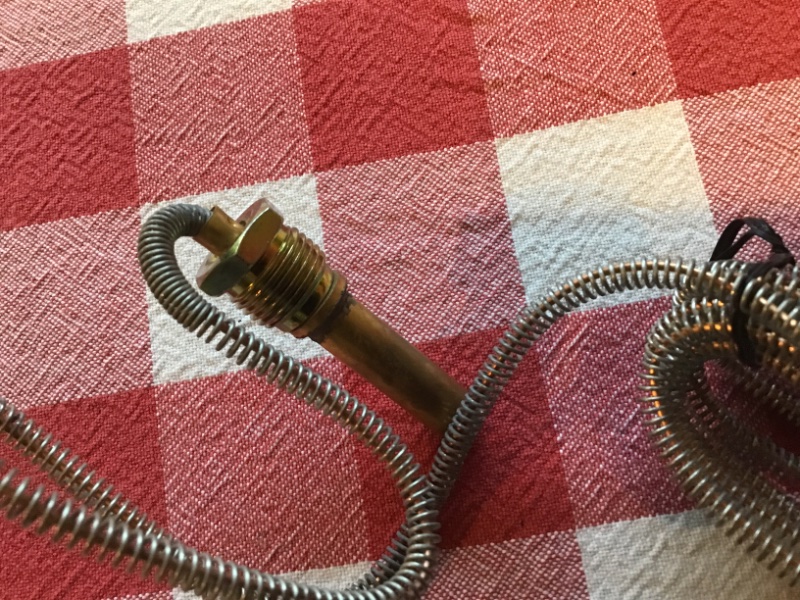

Yes, that was my thought process, but as Miles said, can’t really see where else to run it. Maybe I’ll see if I can find something to lift it, similar to wire separators or something.Dave999 wrote: Wed Oct 13, 21 9:21 am if its some kind of sealed capilary tube with themometer mercury or alcohol in it yes it will
the sender is supposed to supply the heat that mades the liquid inisde expand and move the pointer. you will be getting heat from the heads as well. so gauge will always read as a combination of heat from the water at the sender and heat from the head.

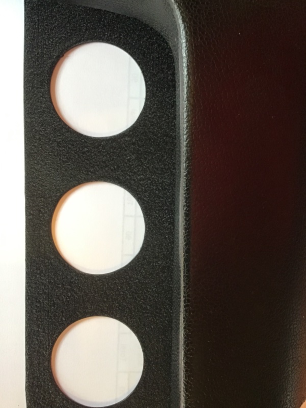

I hate not being able to get on with stuff, drives me nuts. Waiting for paint to dry and parts to arrive. The good news is, the wrinkle paint was just as easy for the front of the plate, so that’s done now other than waiting another day to let it really harden.

Don’t sweat the capillary tube, you don’t need to accurately know the coolant temperature to the degree , cold, normal or omigod is fine for the average road car.

Blue wrote: Wed Oct 13, 21 3:08 pm Don’t sweat the capillary tube, you don’t need to accurately know the coolant temperature to the degree , cold, normal or omigod is fine for the average road car.

Plate should be cured by tonight, so will test fit the gauges again. Very pleased with the finish against the trim, looking forward to seeing what it looks like against the ribbed finish on the dash.

Quick question on the water temp gauge, at the manifold / sensor end of the capillary tube, does this need sealing in somehow when connected? I dunno, ptfe tape or a blob of something, or is it fine as is? Take it I’ll have to drain the coolant half way or similar.
