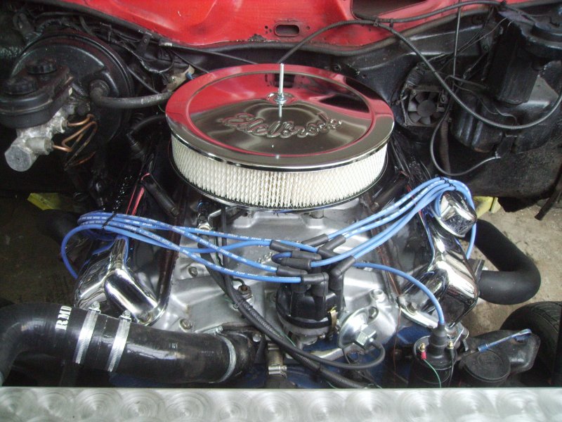

the carb kit and matching (to the rocker covers) edelbrock air filter arrived this afternoon so we can get them sorted tomorrow. that'll allow us to test the gearbox which of course is easier now the prop's fitted and the brakes work.
Re: big block to go in ashley's zephyr
not much today but the carb's fully rebuilt and sat back in place. we'll have it running again and set up tomorrow.

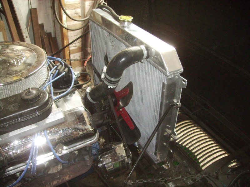

with the carb bolted on and everything connected up (including the return springs we'd forgotten) we fired it up and ran it through the gears a couple of times before checking the fluid and adding another litre.
then..... disaster!! ash loaded up the box in gear and the fan chewed it's way into the ally rad' bending the fan blades at the same time. aaaarrrrrggghh! so with the option of replacement at this short notice out of the question we had to lay it flat, squeeze the damaged tubes flat and clean them with brake cleaner. then we mixed up some fibreglass filler and squeezed it into the damaged areas, waited for it to set and blacked that side of the rad's core. then refit it and run it again, only a slight drip now so ash' got a radweld (i know i don't like them either but needs must) and run it again. this appears to have stopped it, fingers crossed
we looked into the reason for so much movement to allow fan/rad' contact and what appeared to be a good gearbox mount was only hanging onto it's bonding by a thread, doh!. againg getting a replacement this late wasn't an option so we welded a couple of bits of scrap across the 'join' effectively making it solid. oh no you say but wait..... the gearbox crossmember on mk3 zephyr's is rubber mounted at the chassis so we're good. next we trimmed the plug leads to neater lengths and added roadkill wire seperators as the new ones were too loose to hold these ngk leads. now just the flip front to fit and we're done, oh and even more cleaning as everything right back to the bootlid is covered in water drop marks.

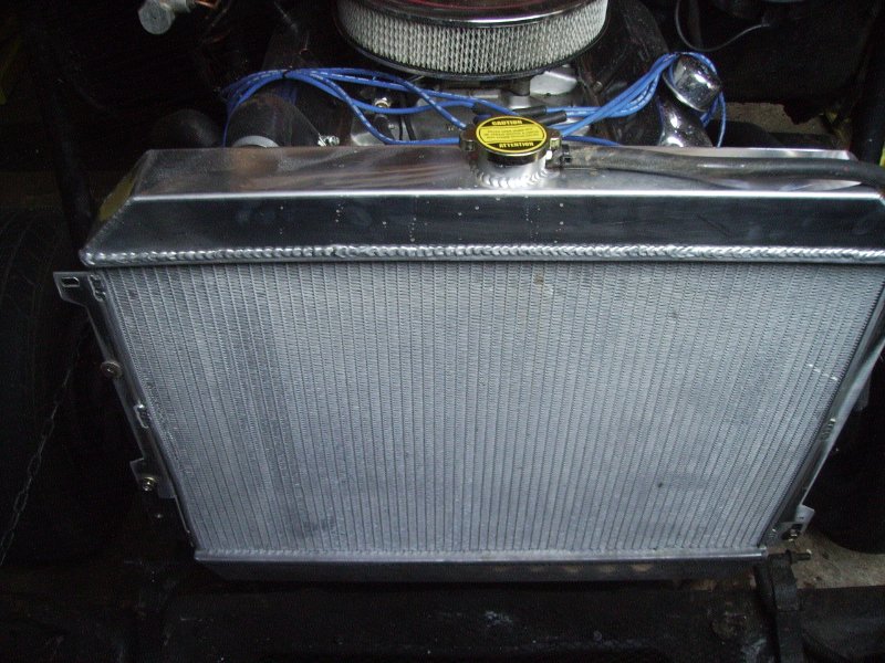

we've got the new big block mopar ally rad' mounted to ashley's zephyr over the weekend. handily the hose fittings are the same sides as a ford fe too so just some minor hose trimming to connect it up. we now have at least an inch and a half between the rad' core and the fan so contact there again is almost impossible.
- IMG_0001 (127).JPG (123.83 KiB) Viewed 10040 times
- IMG_0002 (86).JPG (123.26 KiB) Viewed 10040 times
ash' drove it home yesterday. he went through the town to get a takeaway and said it started again easier and by the time he got home where the temp' gauge used to read 1/2 it was only 1/4. sounds good to me
