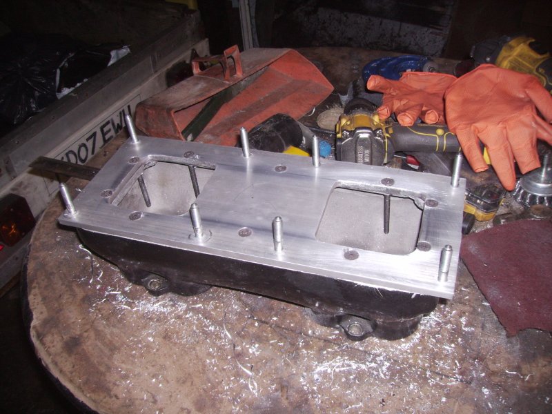

today we tapped the stud holes in the ally plate and loctited the studs in place. next it's neatening the edges/corners and drill/countersink it to bolt it to the tunnel ram.

a little more done today, just need to cut the bolts to length ready for final assembly. that is once all the black paint's stripped off. it wasn't much but it seems more..... which is good. :thumbright:

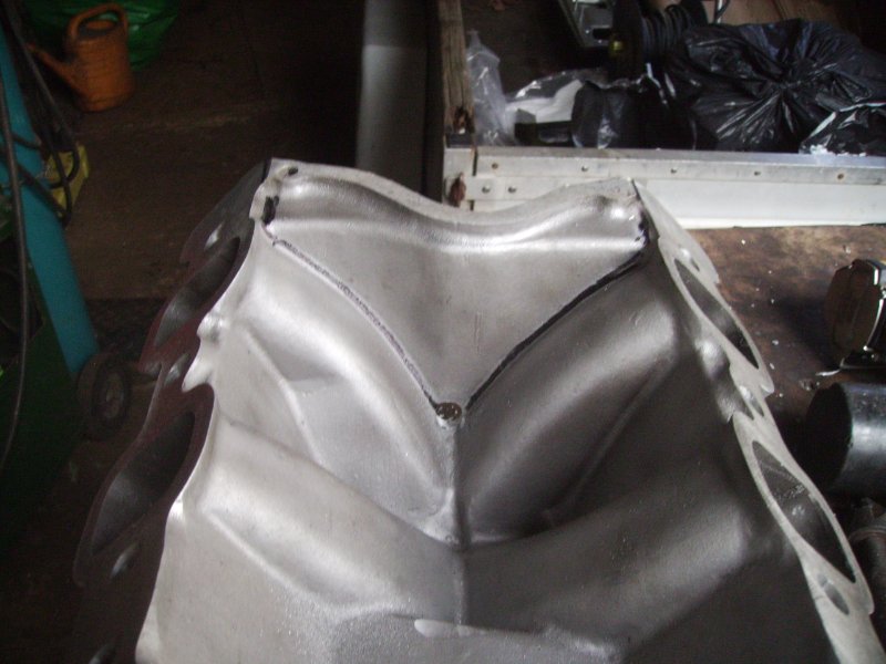

Posts: 1645
Re: a bit of this and a bit of that

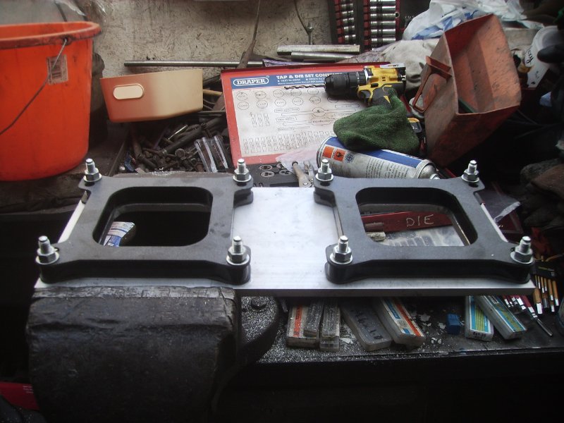

today we set to on the tunnelram base with my (lidl's own) sawzall and a couple of grinders. all the bits that interfered with the adapter are now gone and it fits a treat. the corners/edges of the carb plate are smoothed off and the super length bolts are all cut to length. we're waiting for blast media now to remove all the paint from what remains of the tunnel ram Image
:D . it's done as far as modifications go so that's another job ticked off.

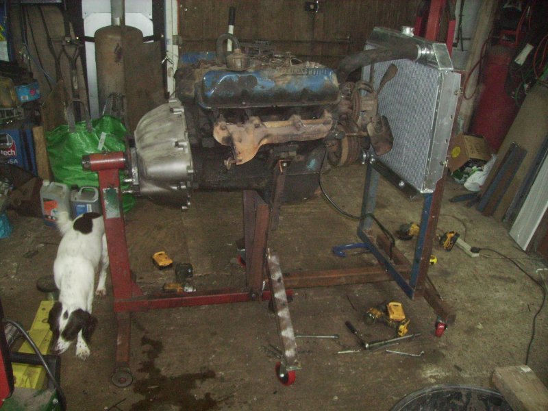

we made a start on the run stand today.... finally. we grabbed my engine build stand from over the road as well as 1/2 of the 2" angle iron work bench ashley saved from a skip at a place he worked. first job was remove the seized carb from the 360, redrill my lift plate to suit and bolt that in place. then we could lift it up and remove the iron bellhousing and clutch and bolt on an ally fmx bellhousing. then the build stand's mounting 'spidery' thing was bolted to the bellhousing and slid into the stand. we cut a 2x4 to sit under the sump down tom the stand which held the engine slightly uphill, ideal to run it. lastly before dinner stopped play we cut and bent some more 2" angle and bolted them to the engine mounts while pointing down to the middle 'leg' of the stand. the plan is the engine will be held at those 3 places and the whole shebang will be stabilised by a cross beam on an extension of the middle leg to which a radiator and dash mount will bolt. either side of the cross beam will be new swivel castors keeping it all mobile.
hopefully we'll get it done ready to test the 360 by some time next week (read... next weekend, lol). we'll get more use from it once we've built ashley's 352 and later my 390 so it's all worth it. plus by just changing the engine mount section it can take other engines too.

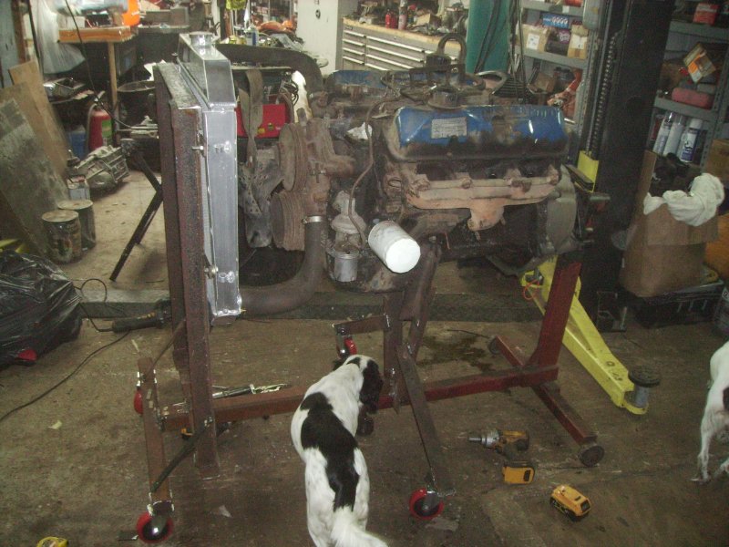

Posts: 1645
we got all of the run stand frame made today and the radiator mounted with top and bottom hoses. we added the front crossmember with castors as above but i wasn't happy with the engine's stability so we also put a stabiliser off of each side's engine mounting leg. that fixed it, it's solid now.next it's add a 'dashboard' so we can moniter the vitals and have an ignition switch. oh, and we'll have to fit a battery/fuel tank tray too. we're getting there though and by removing 1/2 a dozen nuts and bolts the engine build stand is back to stock and the rest breaks down to 3 seperate bits so not too bulky.

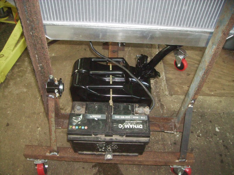

had a bit more time on the run stand today. we got the gauges, ignition switch, solenoid, battery tray and clamp and fuel 'tank' tray and 'clamp' all fitted. next it's wire it all up and fit the new distributor, coil, new starter and s/h carb to the engine. we're getting there. oh and yes the jerry can's held down with a bungy strap but as it'll need to come off to fill it each time it's fine. it's nice and sturdy so....

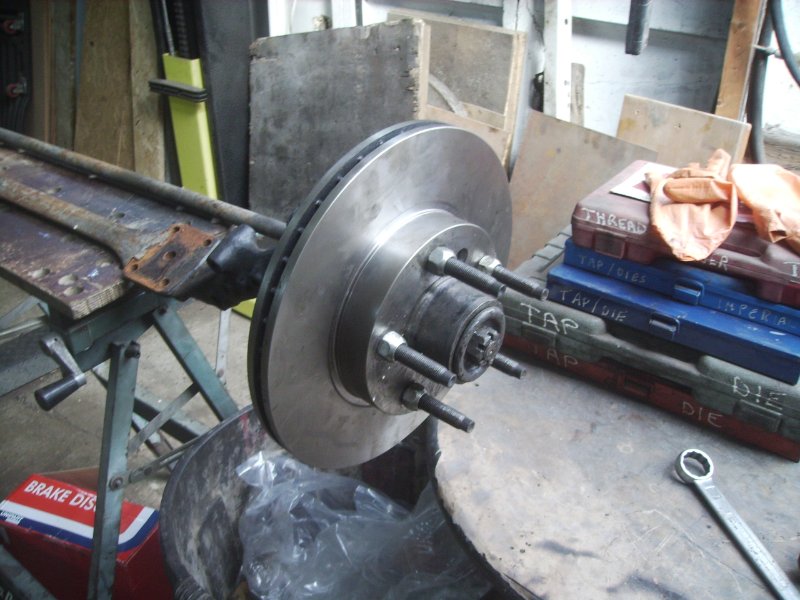

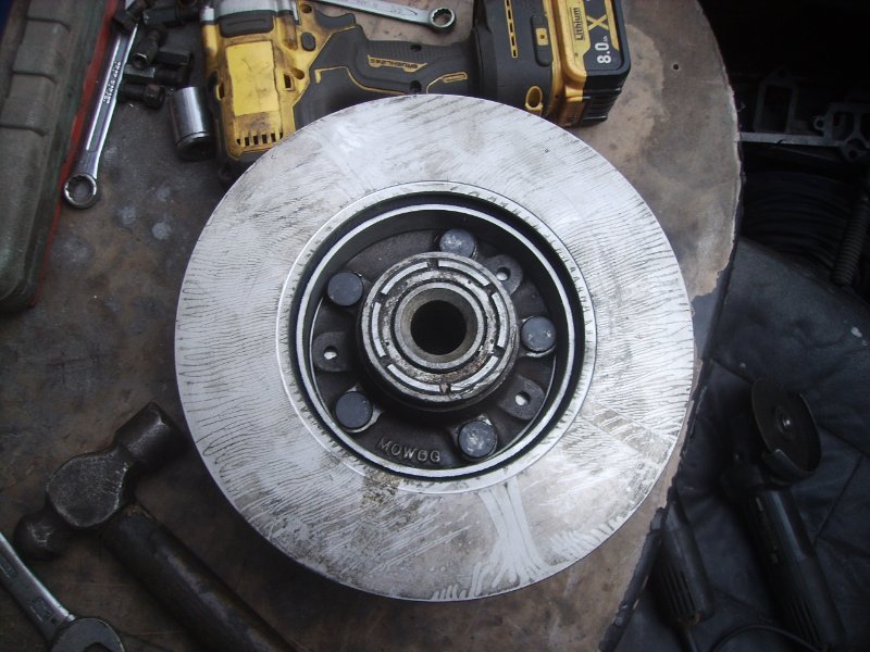

today we got on well. the wolseley axle got clamped in the workmate and the drum brakes were stripped off. the bmw discs arrived (same jag/chevy pcd as the wolseley) so we chucked the hubs into the lathe to turn them down to match the discs centre bore. they're bolted together now and refitted to the axle ready for when the subaru wrx 4 pot calipers and brake pads arrive. then we can position those over the discs and make templates for caliper brackets which in turn get transferred to steel plate. more to come when bits arrive.
