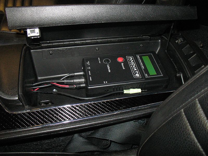

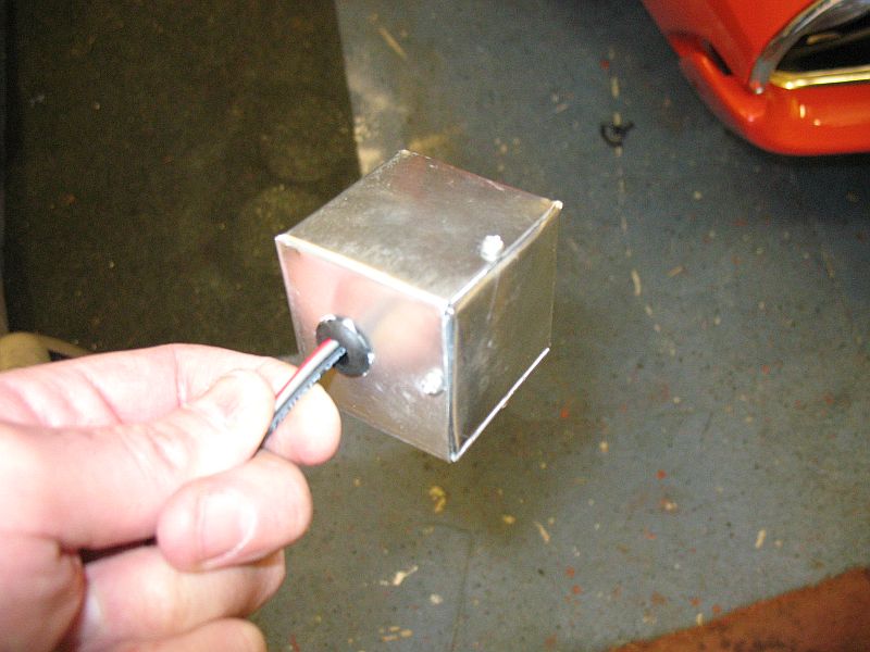

One thing I did do was make a little ally box for the 5 volt power supply I made to power the MAP sensor I have fitted on the intake. I have fixed the box up under the dash out of sight.
I also ran wires for the LM-1 recorder meter under the center console so that the meter can sit in the console box when recording during a run.
It will be recording air/fuel ratio, RPM, and manifold vacuum and the software will plot those together on a graph. I am going to try and blag one of our old laptops from work to display the results at the track.
I ran an audio jack cable for an ipod into the console box too.
LM-1 meter. I didn't want this flying about if I get out of shape on the track.
Power supply for MAP sensor.

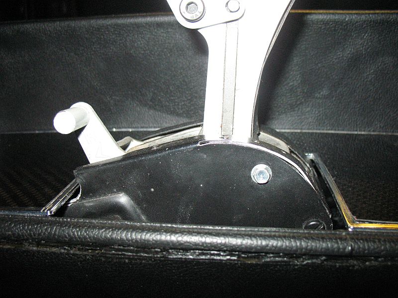

Almost forgot. I got the console top to fit flush around the shifter as well.

top job on that that shifter dave, is it sat on the original slap stick mount? i gather you cut some of the ally casing on the shifter cover to raise it ?

There are a LOT of mods to the shifter cover to be honest.

so is it sat on the original mount or not? im looking to change mine at some point so info would be of help, hence why i ask :thumbright:

Oh sorry. I welded in a base plate for the shifter. Had to do some minor cutting of the stock metalwork.

thanks mate, looks like its a lot less hassle fitting a hurst quarter stick than say a b&m unit :thumbright:
