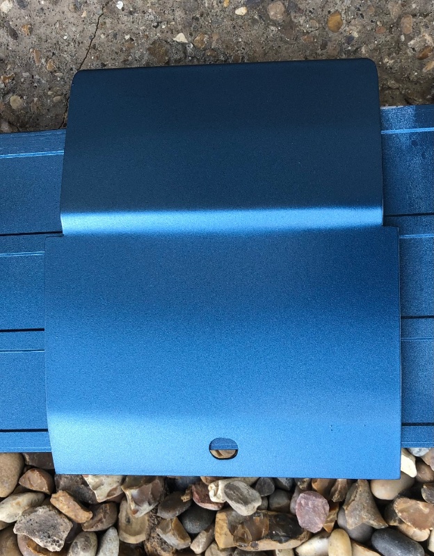

I was planning a B&Q trip for my speaker cover, but if I’m mounting the tach to it, was worried it would be too thin.

That’s quite a large panel so unless you can bead roll it for rigidity you might consider using a bit of steel sheet instead.

I can’t, so I will. :D

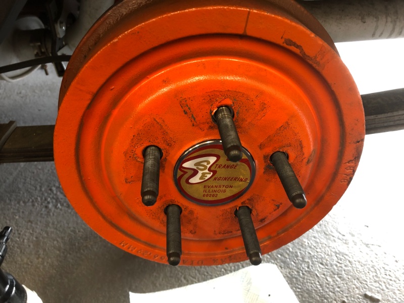

Long wheel studs and a bit of delete panel paint age to kick the week off…

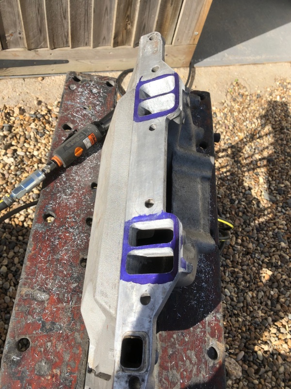

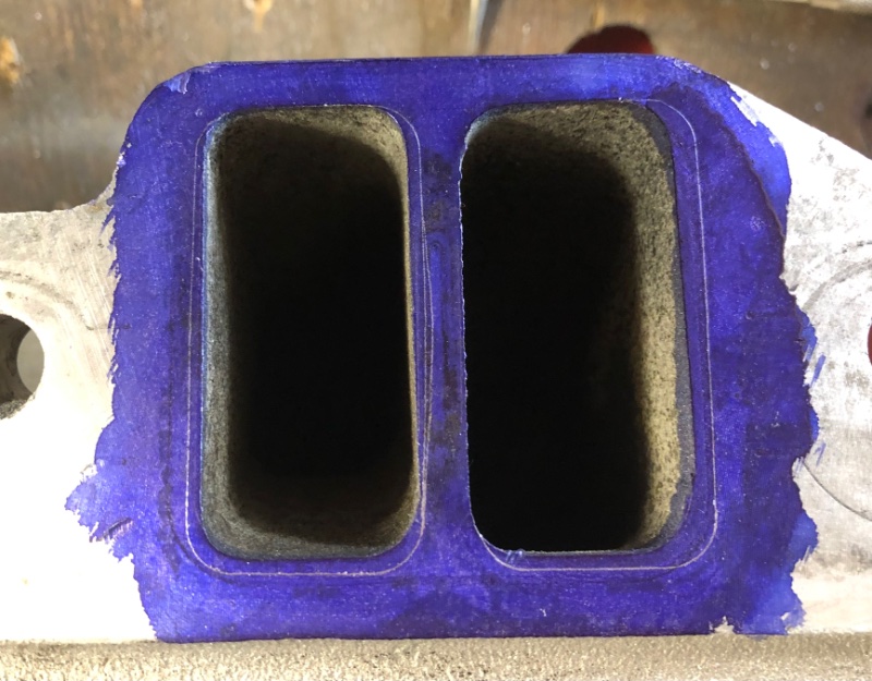

If you’ve never port matched an intake manifold, this is why you do it, the ports are always off to a lesser or greater degree. I do a deep match going about an inch into the manifold,

That panel looks great painted. :thumbright:
What attachment are you using to port match? Have Dremel and spare manifold…. Tempting…. :help:

I use an air die grinder. Not sure a dremel has a big enough chuck to take a high speed cutting bit.

got one of these, (you need a chunky compressor for an air one)
https://www.toolden.co.uk/power-tools/d ... 9LEALw_wcB
turned my garage into a "dark satanic mill" black dust and metal bits everyhwere, magnetic screw drivers all grew beards
so i now use it OUTSIDE only
does give you cramp in the hands eventually
it is much like an angle grinder, intent on nicking off in a direction where it should not go in order to cause mayhem.
a light touch, slow and steady is the way
basically a small milling machine in your hands dpending on tool used. get tools with a decent length shaft so the body of the grinder is not obstructing your view of the work being done. stubby short ones are easier to control but you can't see properly
check out cartridge rolls as well. good for finishing...even pattern etc

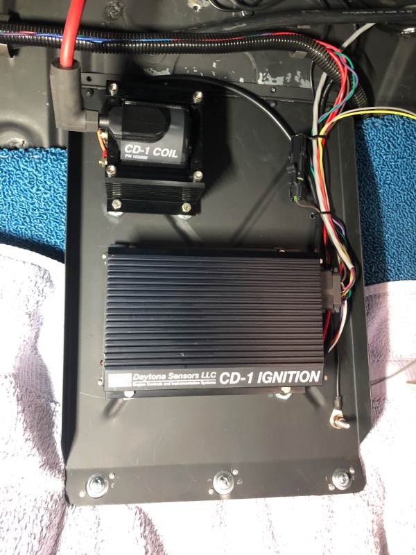

Just waiting on a couple of bits so I can finish off but it’s basically done.

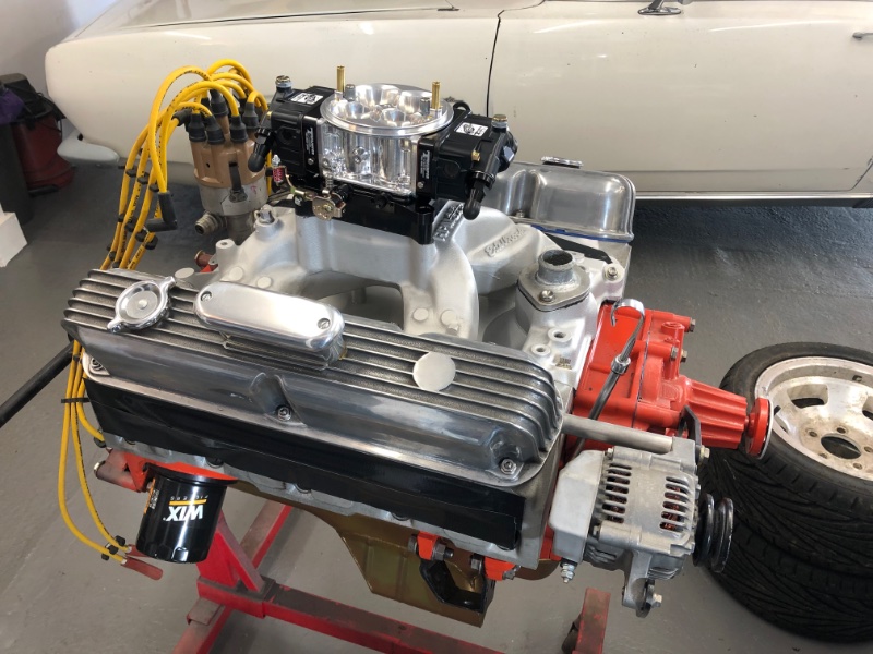

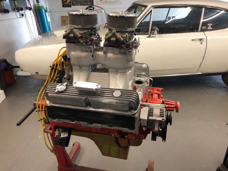

408 from my Valiant is being repurposed for the Barracuda. Unfortunately the tunnel ram won’t fit under the hood so that goes back on the Valiant. For the Barracuda it gets an air gap manifold and a custom built billet carb from that crazy guy in Utah…
Posts: 6750
Re: Blue's Barracuda
Looks a sexy carb 8-)
