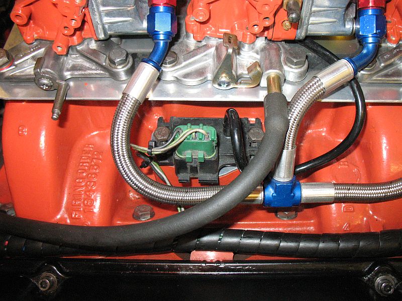

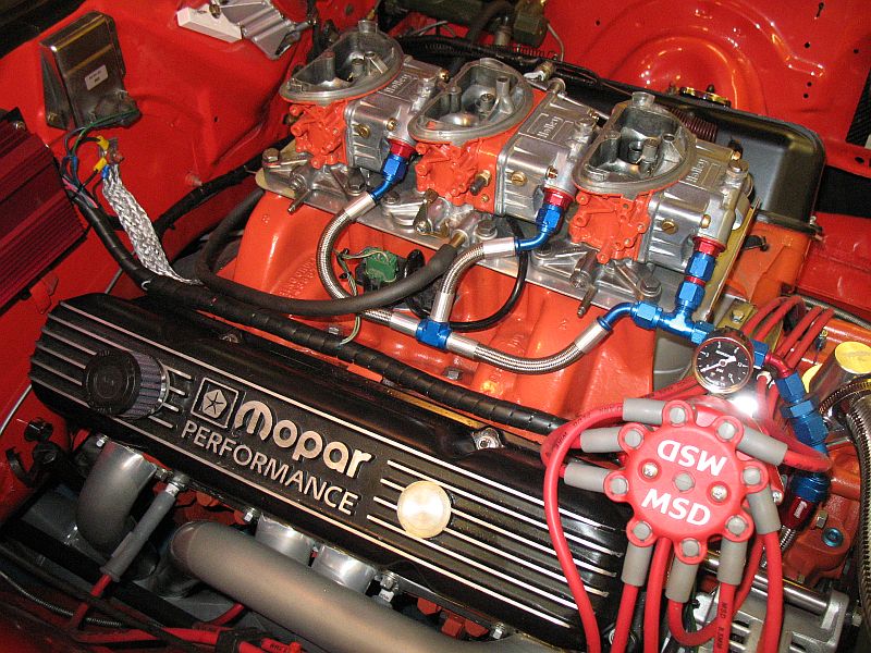

Got the MAP sensor wired up tonight and started doing a tidy up on the wires around the engine bay. Spiral wrap is good but you don't have end up scraping your knuckles on everything as you wind it on. :lol:

sweet,makes me feel sorry i sold the runner when i see the six pack carbs 8-)
AllKiller
Posts: 15191
Post by AllKiller »
Thats such a neat looking set up with the aeroquip hoses...much better than stock 8-)

Yeah those fuel lines from ProMax are really nice.
I will have to give that MAP sensor a shot of paint once I have made sure it is working correctly.
I just have to break my back and join some wires up under the dash this week and then I will fire the engine up and try recording some data.

All that trouble I went to getting those fuel lines, now you are using braided! :roll:

Jeff wrote:All that trouble I went to getting those fuel lines, now you are using braided! :roll:
I used those lines for years though Jeff. :thumbright:
They are just too narrow for my needs now. Still got them stored though. ;)

Dave wrote:Got the MAP sensor wired up tonight and started doing a tidy up on the wires around the engine bay. Spiral wrap is good but you don't have end up scraping your knuckles on everything as you wind it on. :lol:
I know you have just scraped your knuckles, but that spiral wrap is going to melt with engine heat. Trust me, i know! Unless its some special heat resistant stuff. Personally i suggest the flexible plastic stuff like most modern cars use.
Dave-R
Posts: 24752
Post by Dave-R »
Engine has been up to temp a few times already with no ill effects. But with the hood up.
I will keep an eye on it Roger. If I need to change any wiring it is easier with this stuff.
I have correct type insulating wrap I can use if there is any sign of it deteriorating. Thanks for the warning.

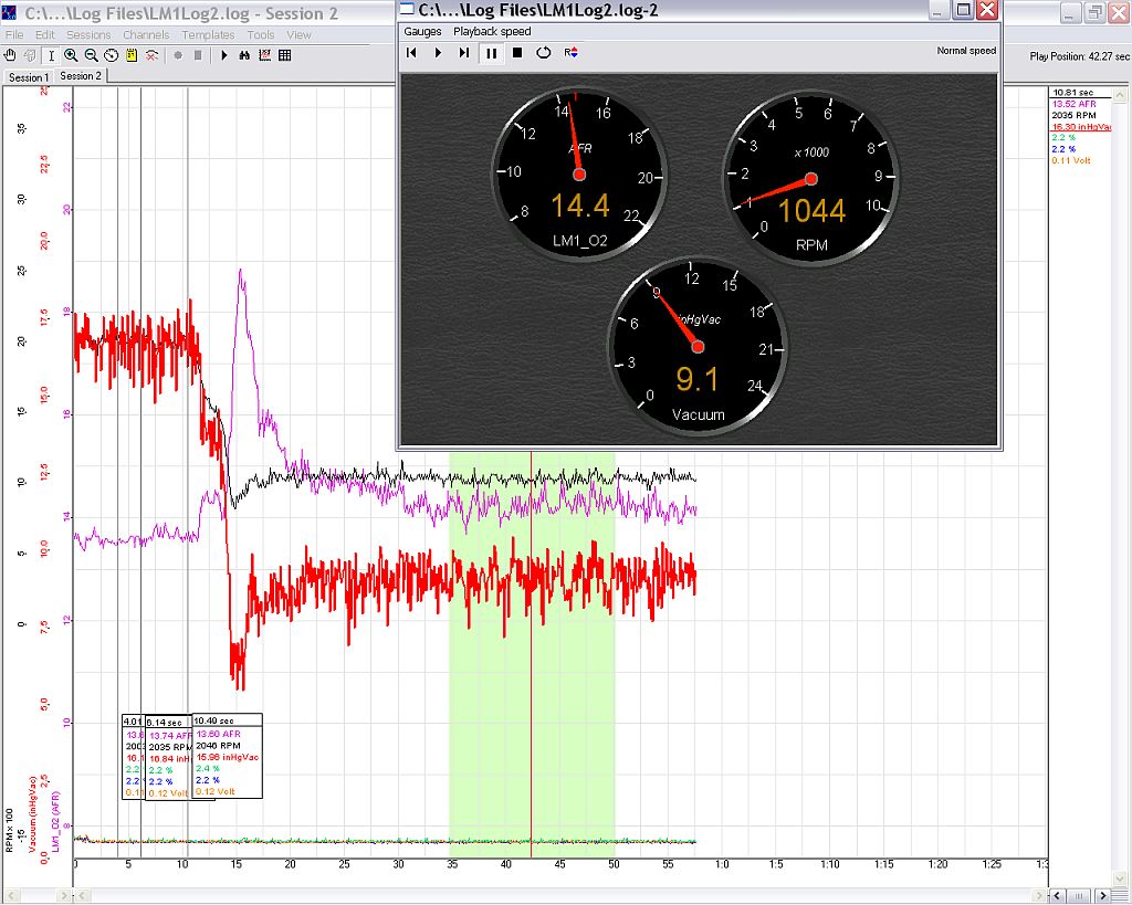

OK I am back to working on the car again. Had a death in the family so the car had to take a back seat for a while.
I had a go at some data acquisition this afternoon. Not sure if I believe the vacuum reading or not. I will have to check it against a normal vacuum gauge. It is about twice what i used to have with the old cam.
RPM is around 1000 at idle. I would like to loose about 50-100rpm if possible. So I will need to make the holes in the throttle blades a touch smaller than they needed to be with the old hydraulic cam.
Got 16 degrees initial and 36 total advance at the moment. So a little work to be done on the distributor curve before I start messing with the carbs.

Very technical Dave, being able to check the data after every run puts you leaps and bounds in front of everyone else 8-)
