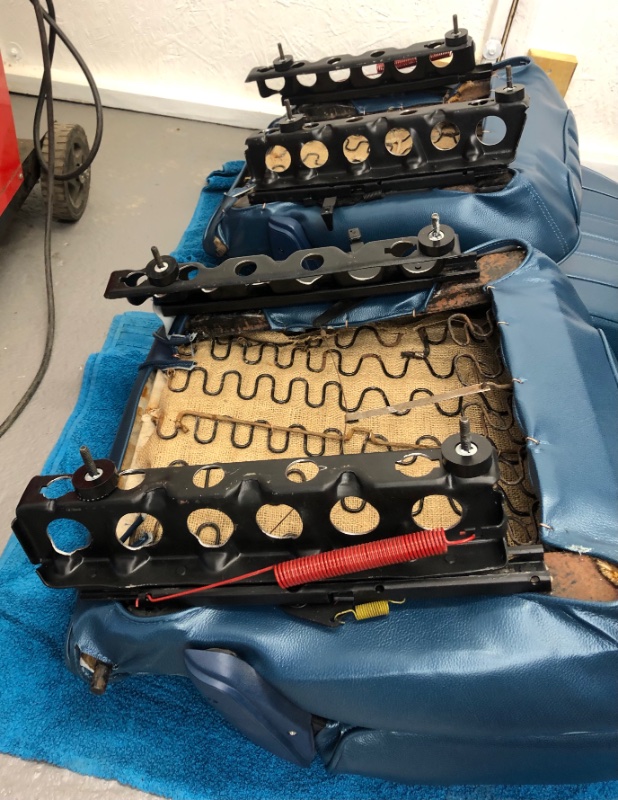

Couldn't resist "massaging" some stuff while it was off the car...

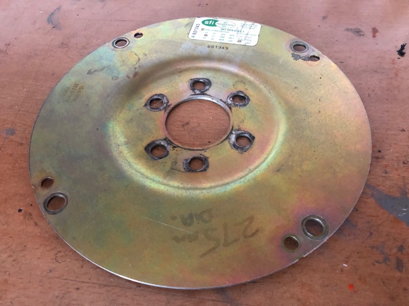

B&M are no longer producing a neutral balance flexplate for use with a 904, so I had a 727 one turned down to the correct diameter, hopefully this will do the trick.

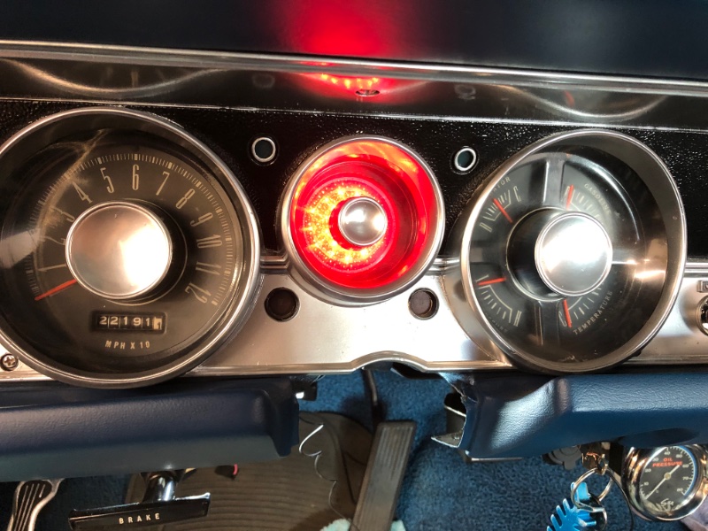

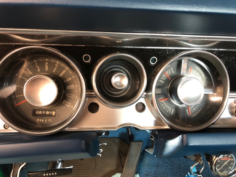

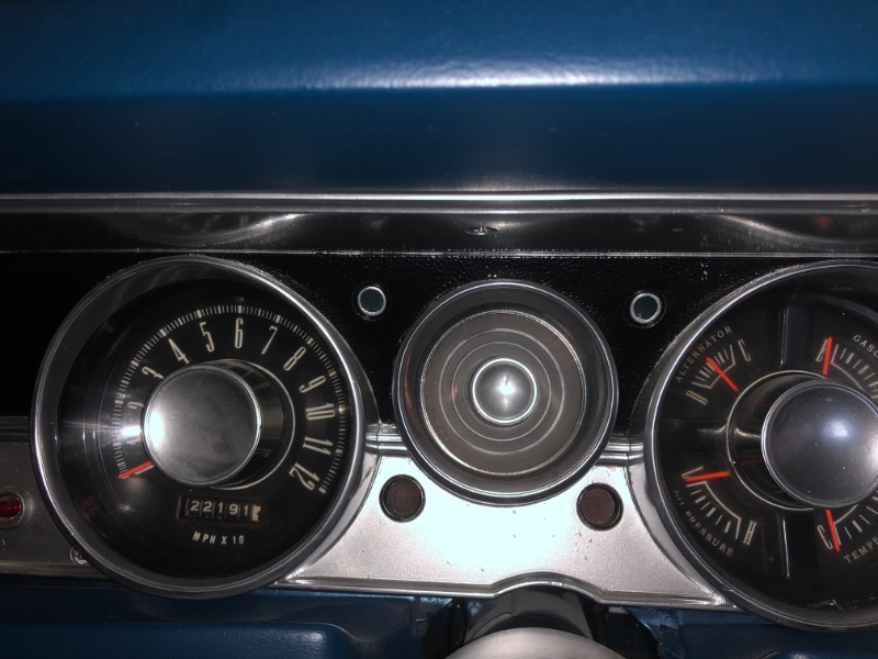

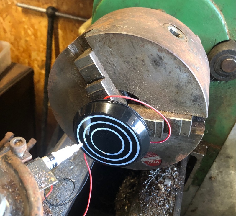

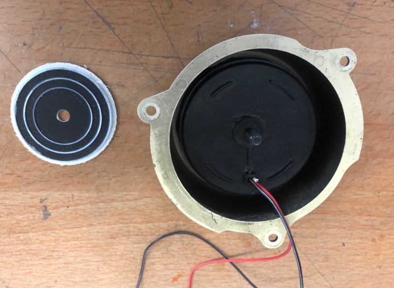

My new ignition system has the ability to operate a shift light so I wanted to fit one. I’m not a big fan of “stuff” so I had a think about how I might incorporate it into the existing layout. On an A body rallye dash the central dial comes blanked off unless a vacuum gauge or tach was optioned so that seemed the best location.
Posts: 14598
Re: Blue's Barracuda
I found a suitable black faced flat LED lamp on eBay and used a paint pen and lathe to replicate the pattern of the blanking plate. Cut out the centre of the blanking plate and glued the LED in from the back.
Posts: 14598
Boom!
I wondered what you were doing with that. :shock:
Brilliant solution and can’t imagine you’ll miss it in the heat in battle! :D
Awesome. 8-)

Ace, what a great idea :thumbright:

Excellent! Great solution :thumbright:

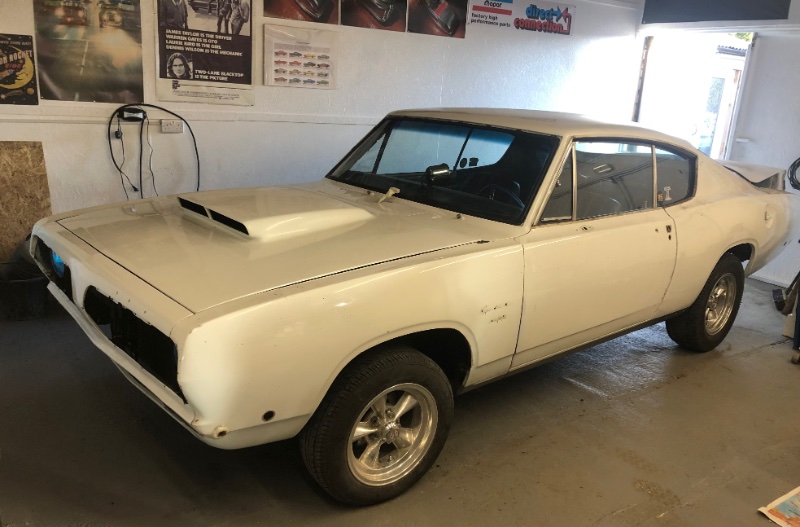

Paint guy had a cancellation so only had a couple of days to get the new screen in and de trim the car. Goes in Tuesday so should be back for Crimbo…
Posts: 14054
B5? Or whatever the engine bay is already? :-k 8-) :salute:

Blue wrote: Tue Nov 09, 21 5:25 pmBoom!
Hal 9000.jpg (38.64 KiB) Viewed 3677 times

RobTwin wrote: Thu Nov 25, 21 1:18 pm B5? Or whatever the engine bay is already? :-k 8-) :salute:
Very much so!

Mark B wrote: Thu Nov 25, 21 2:24 pm
Let’s hope it works out better that that did!
