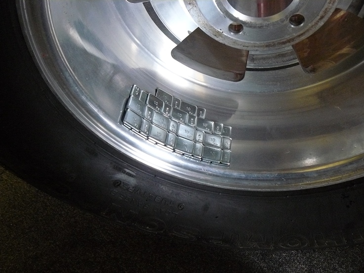

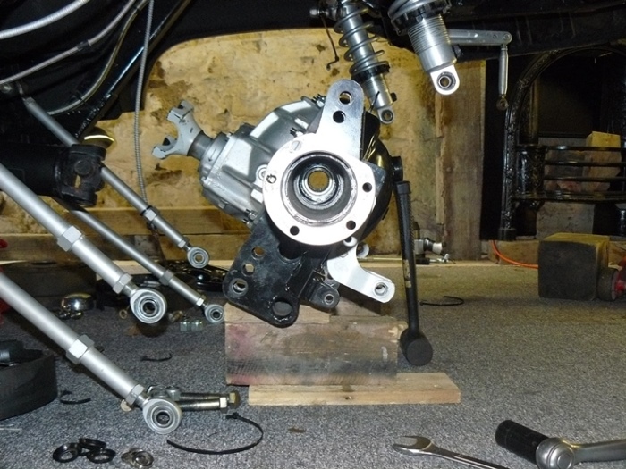

Axle rebuilt and refitted.
Brakes rebuilt & bled.
I found a better tyre shop- I managed to get one wheel balanced, check out the weights!!
I even polished it to celebrate :thumbright:
The other tyre however, is the dodgy one.
I'm going to try taking it off the rim, check the tube, reseat it, etc.
Obviously it won't fit on the tyre shop's bead breaker :roll:
Tomorrow I'll be inventing my own...

Wow. That's Some weight !!!
I've always found I need more weight on bikes with spoked wheels that run a tube !
Probably a connection some where ?
At least you can hide them on a car !!!!
Going well mate. Look forward to seeing it run
