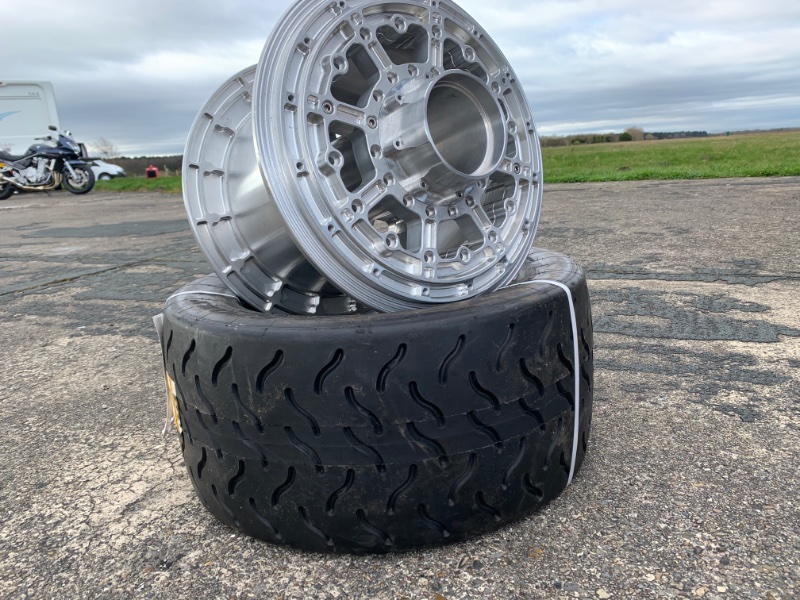

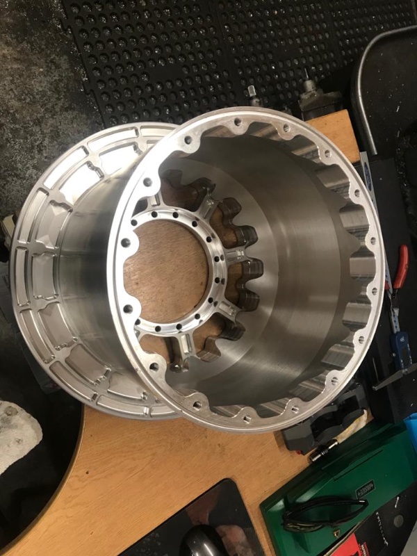

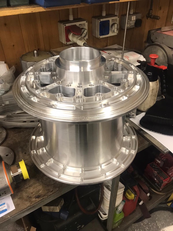

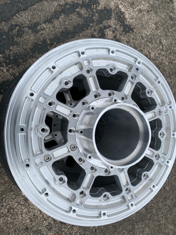

Re: Fifty shades of Jade

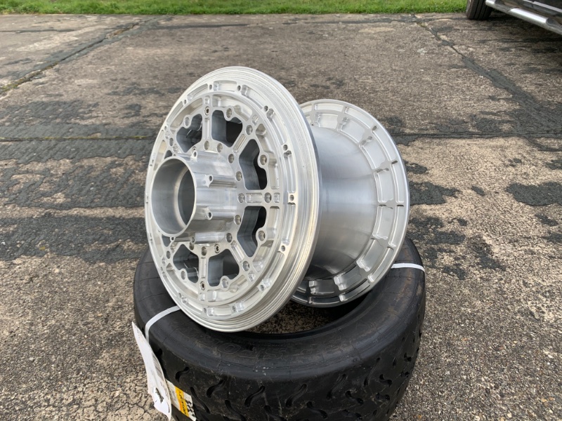

Now that's a class piece of machining :thumbright:
Posts: 1444
someone has to say it..... that's wheely good ;)

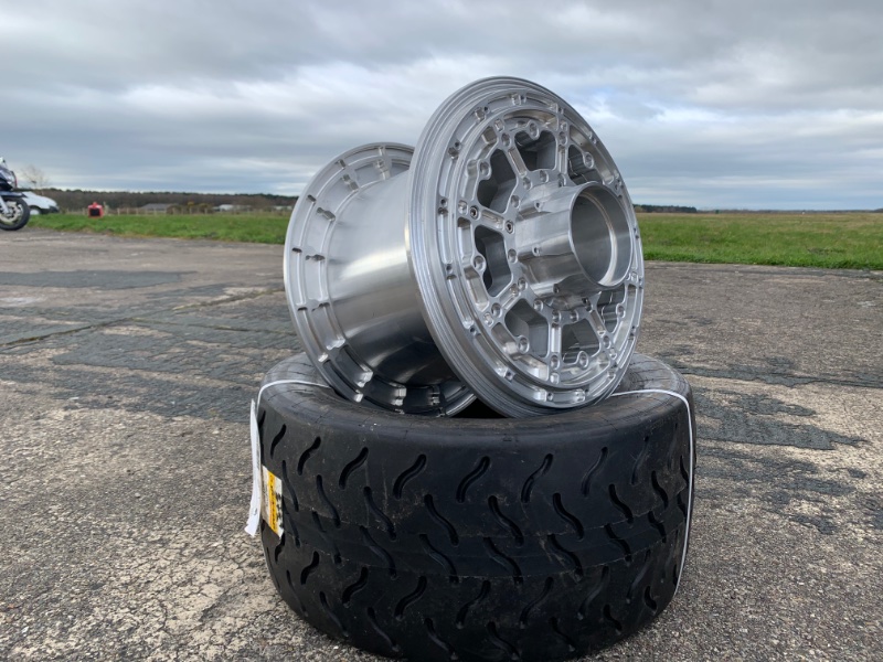

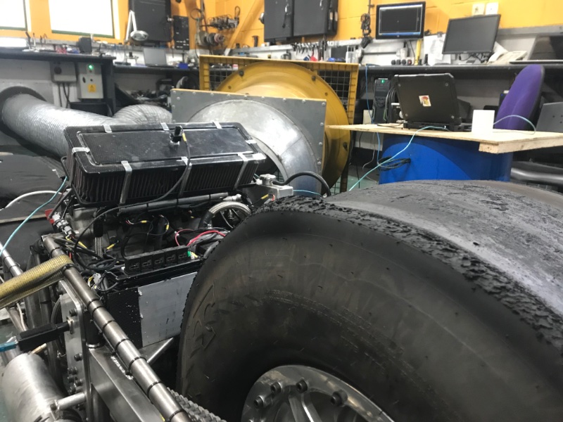

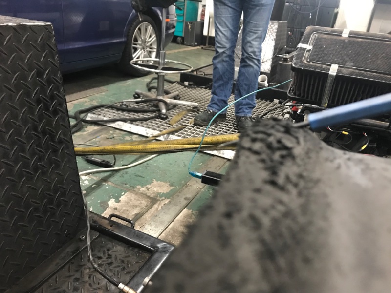

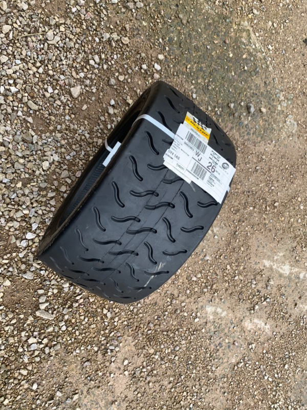

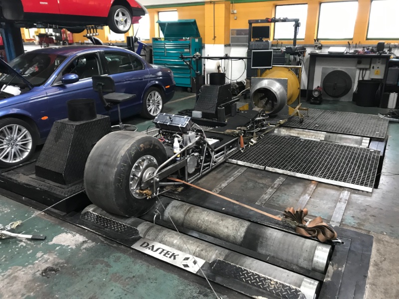

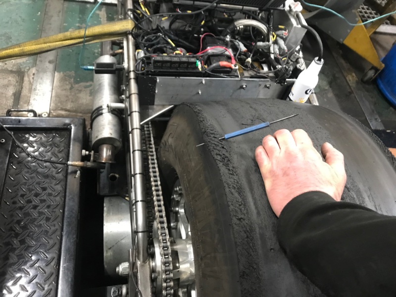

ooh Street Tyres? :wacko:
Stu Twin wrote: Tue Mar 30, 21 1:41 pm ooh Street Tyres? :wacko:
Correct well spotted
A few years back on the last bike we Destroyed a tyre in 30 seconds on the dyno. :roll:
Don’t put drag slicks on a dyno !!!
Learning from my mistake I found a hard compound gravel rally tyre for an old 911 for £50 new old stock which we will use for dyno testing only.
Post by DougieJ »
The work on that wheel is stunningly beautiful - I just love it

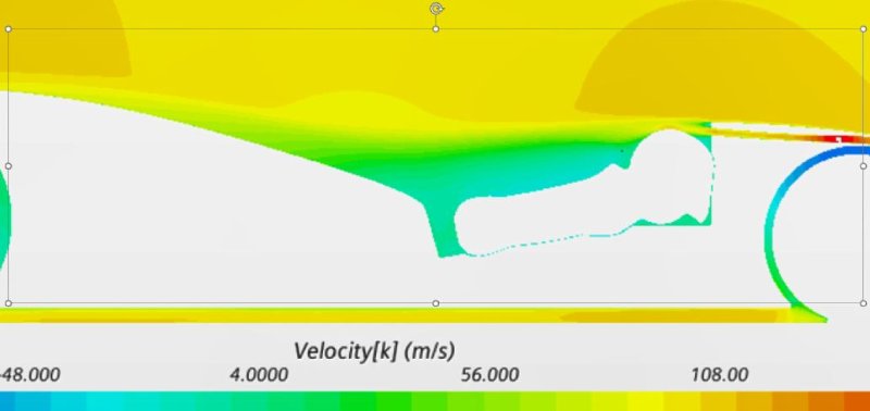

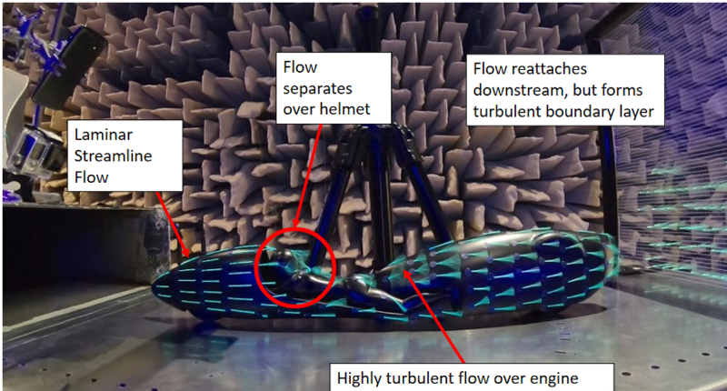

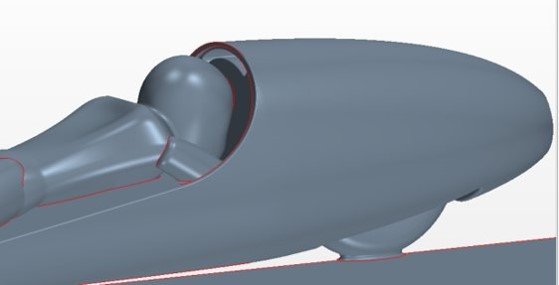

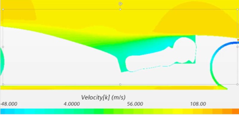

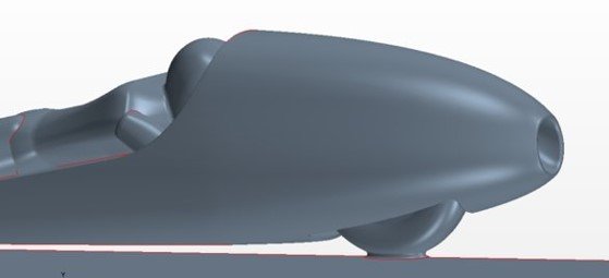

Been spending some time looking at flow separation over the rider's head.
Been looking at the idea of bringing air in at the nose of the bike speeding it up and creating a blown wing over the riders heads.
Seeing a reduction in drag and a slight increase in lift :-k
More work needed :thumbright:
Without AirScreen.JPG (30.14 KiB) Viewed 2306 times
With AirScreen.JPG (31.74 KiB) Viewed 2303 times
This view is almost like a MIR scan of what is happening in the different slices of the model in the wind tunnel.
Pay close attention to the separation above the rider and look at the large wake behind the bike

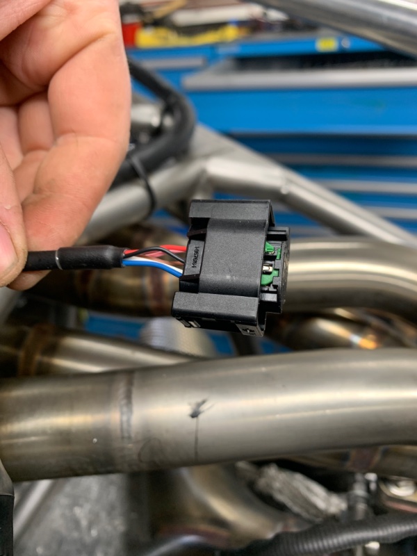

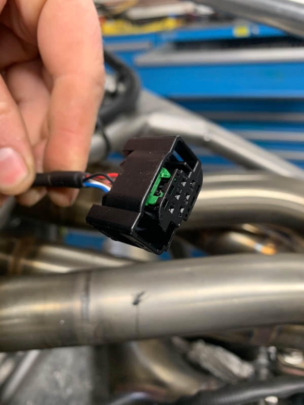

Full after market fly by wire throttle with zero Mechanical linkage working
:runaway!: :runaway!: :runaway!:
Posts: 6743
autofetish wrote: Fri Apr 02, 21 7:39 pm Full after market fly by wire throttle with zero Mechanical linkage working
Very nice, rightly or wrongly, I decided not to go TBW, my head wasn’t ready at the time :D :D :D
mopar_mark wrote: Fri Apr 02, 21 9:13 pm
I agree I think if I had a large foot pedal with lots of mechanical advantage with a pedal close to the butterflies I would have gone cable.
A tiny twiste grip and 2m+ plus to the engine I swallowed the brave pill.
Now I fully understand the calibration and its shut down default parameters I’m happy

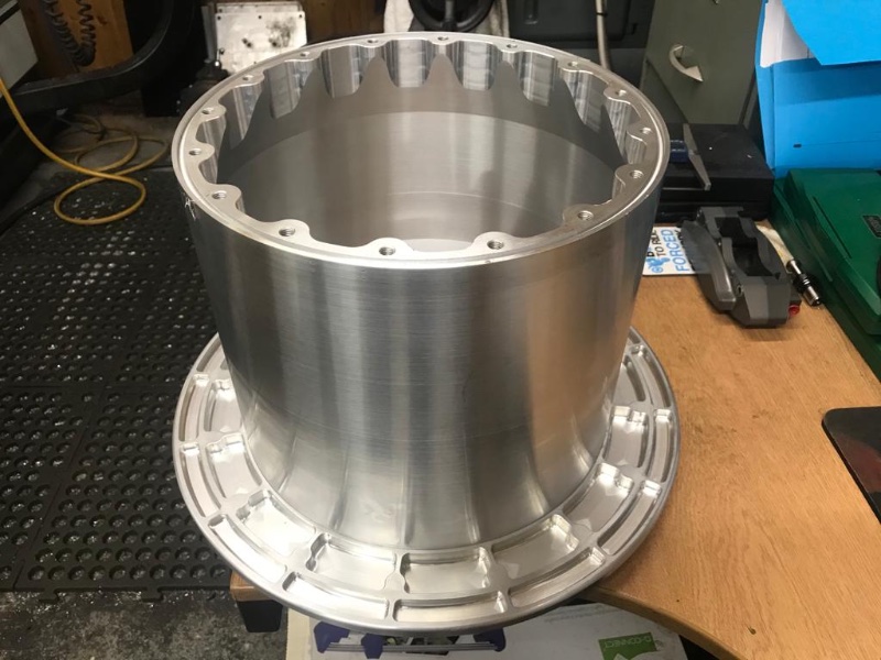

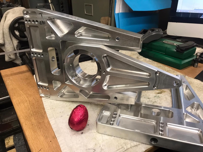

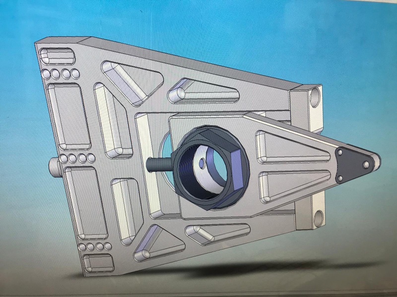

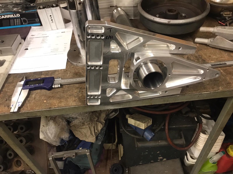

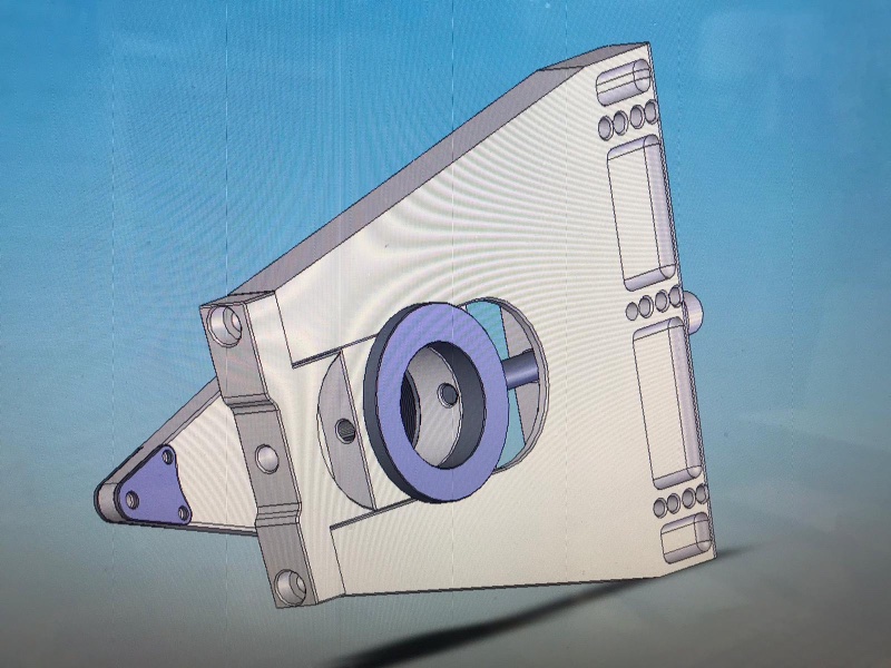

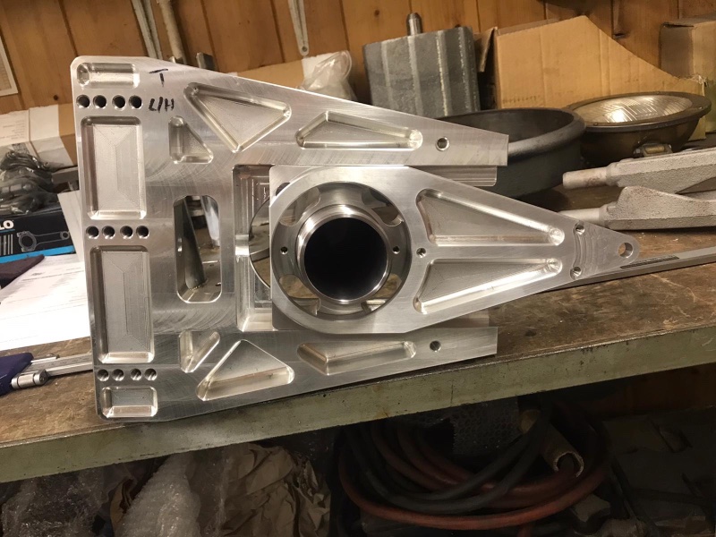

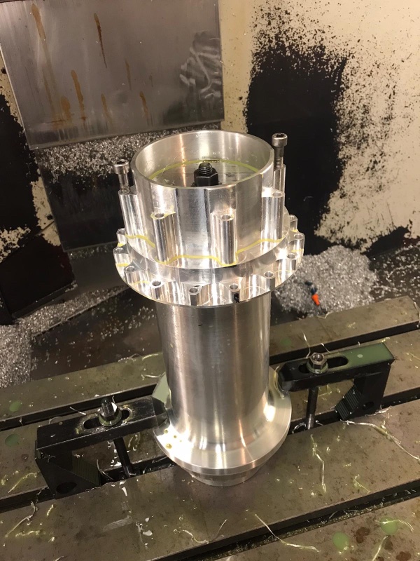

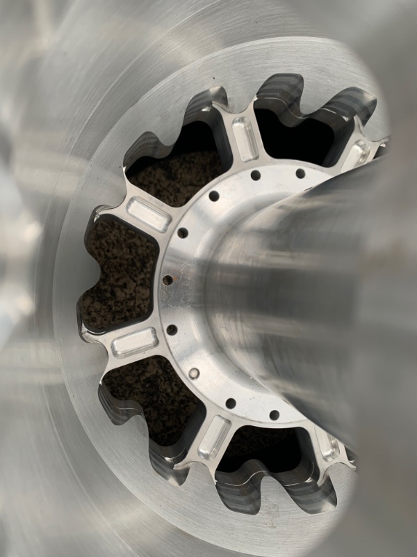

This is special look closely as this is the future. :D Remember where you saw it first ...
4 bolts and you can remove the complete axle rear wheel with axle and brakes quickly all in one lot !
Parachute pull points on the ends of the points pulling on axle center :salute:
100mm Hole up the hollow axle :rr:
Happy Easter Lads :thumbright:

Posts: 1678
Another beautiful piece of machining :thumbright:
