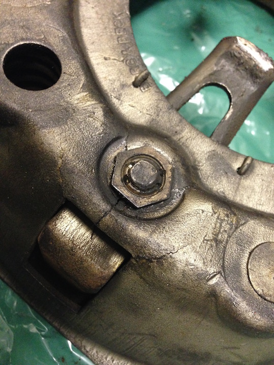

Clutch thrash. Cover had fatigued around all 3 levers, otherwise all good. Clutch looks recent, no makers name I suspect the cover is a rebuilt one. New clutch going in next week. Found a new flywheel in there as well as the pivot and throwout arm, can't believe the amount of new parts I've found on this car.

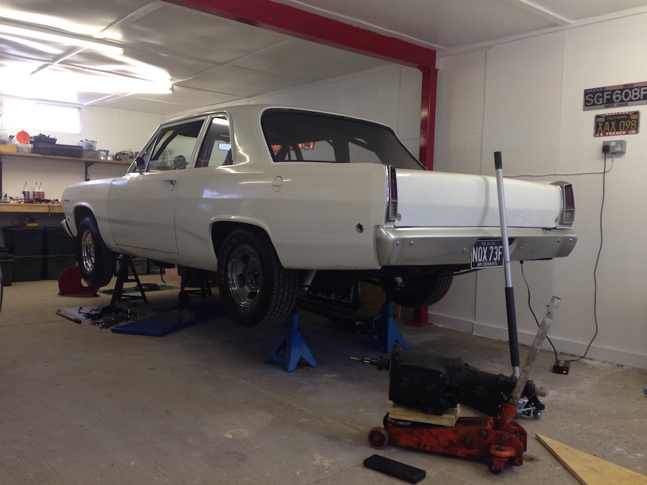

Will do, not much new to show at the moment but should be something next week. New clutch in and all back together, next up is finishing off something I started a long time ago...

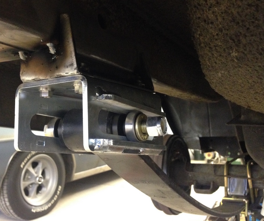

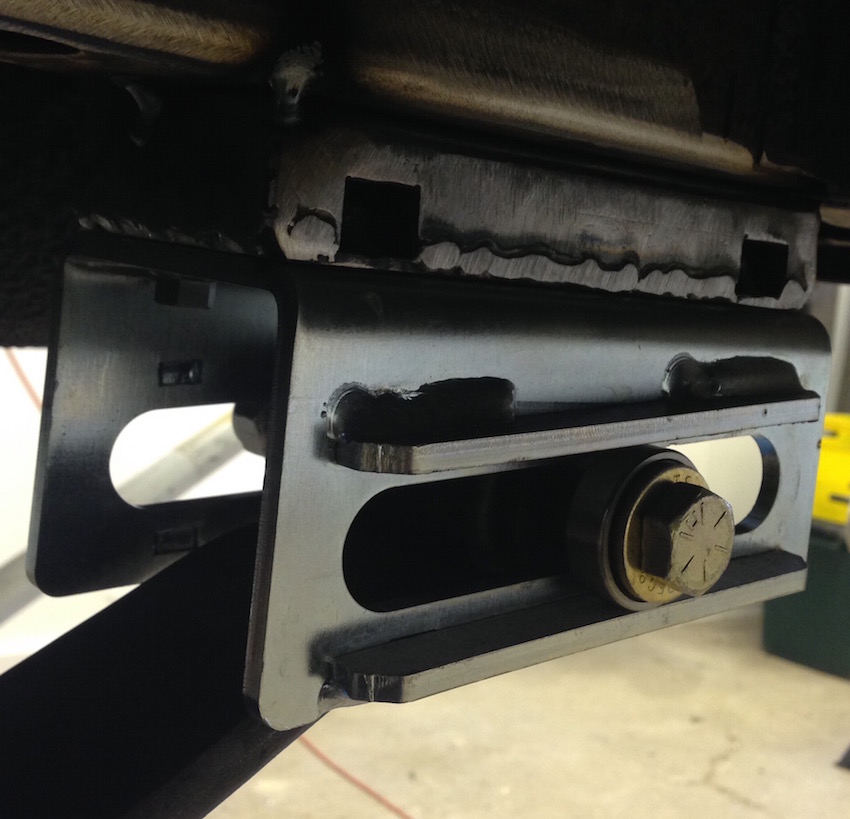

Started finishing off the rear spring relocation this week. I fitted the boxes for the front mount into the chassis rail a couple of years back when I did the chassis ties and left the rest of the job until now. Calvert sliders replace the rear shackles, as this would have lowered the car an inch, I had to incorporate a spacer into the mounting bracket to keep the ride height the same. Once tacked I'll check to make sure I've allowed enough rearward movement before I finish welding them up.
