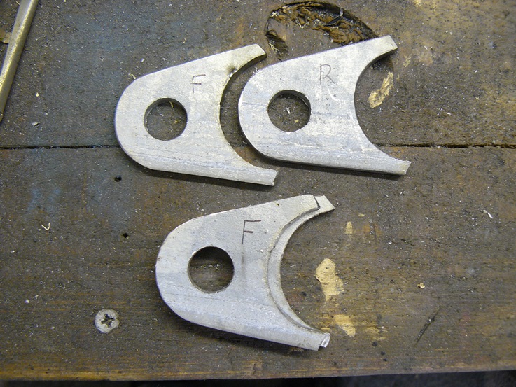

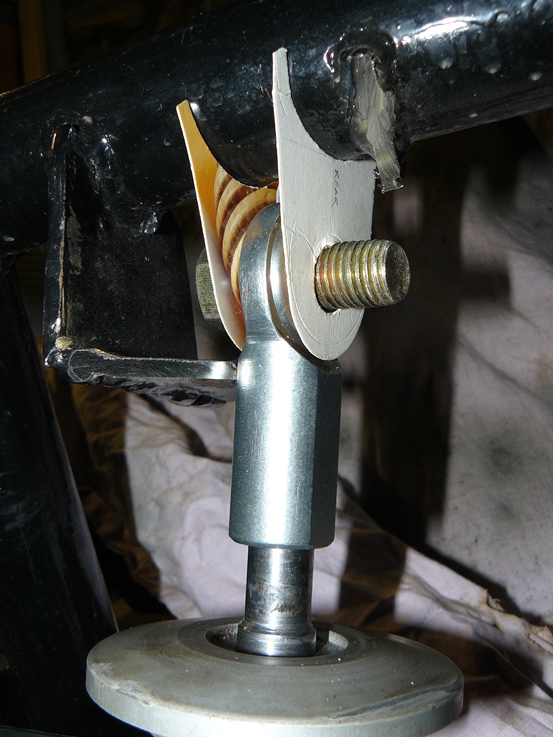

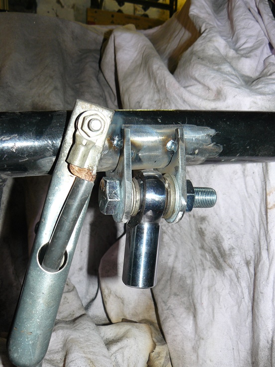

Started on the front struts tonight.

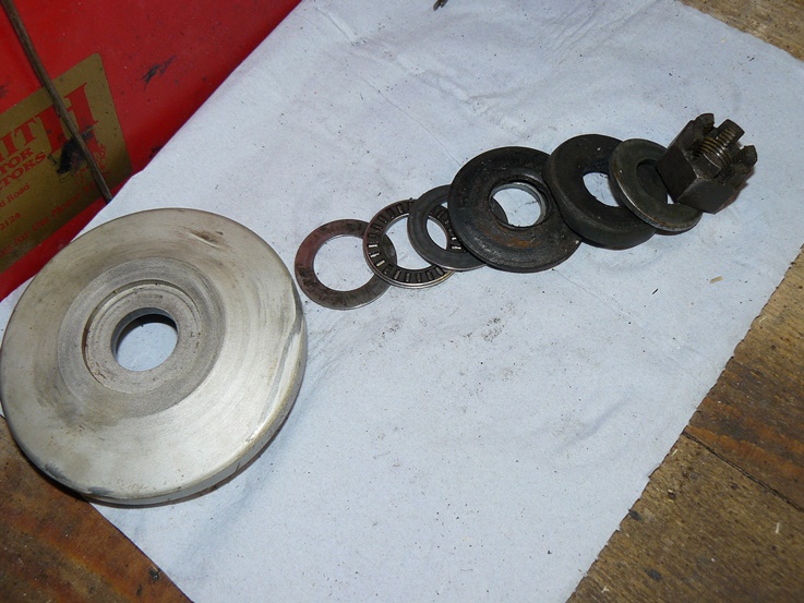

1st pic is the original bearings which were bolted through the chassis bracket with a rubber washer either side. Utter 5hite!

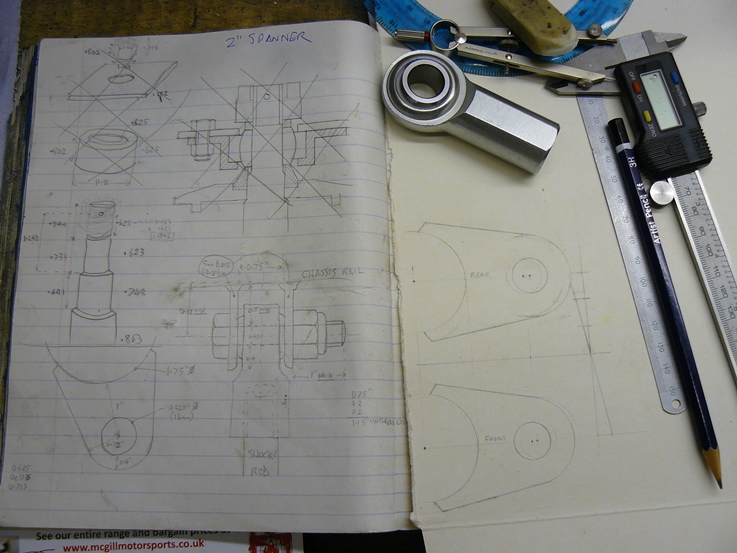

2nd pic- I realised cos of the angles, my new brackets would need to be different lengths.
I've left a section of the original bracket in place as my guide.

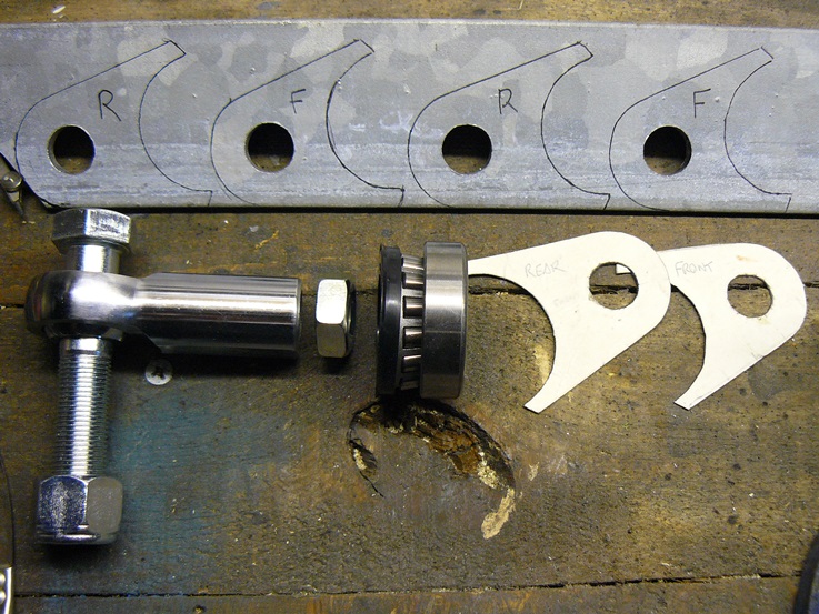

3rd pic- Show Your Workings. At the top is the abandoned Plan 'A'. On the right, the unequal bracket templates.
Pic 4. 1st mock-up. Needs a bit of tweaking but you get the general idea.

Posts: 6747
Can't quite tell from the pics...
In the last picture, with the cardboard tabs, It looks a similar set up to my old front strut setup.
When welding the tabs, I made some equal width spacers, which went either side of the rod end. this allowed me some adjustability.
To be honest, I never had to change, as set up was bang on the money after welding, but I always liked having the ability to have some castor adjustment if needed.
Great work by the way, also love the detailed sketches in your note book too :thumbright:
Posts: 8369
See, something I learned in school came in useful!! I always enjoyed Tech Drawing :thumbright:
I have to make accurate drawings otherwise stuff like this just doesn't make sense in my head, I can spot a lot of problems before they become metal!
I'll put spacers in like you suggest. If nothing else, it'll give me more room to weld between the brackets. Ta mate ;)

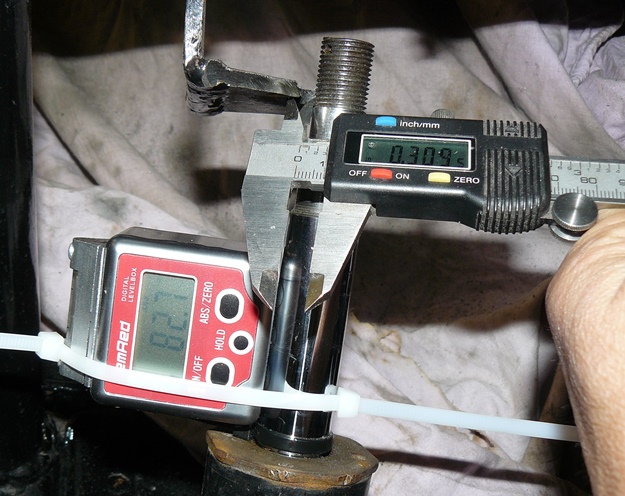

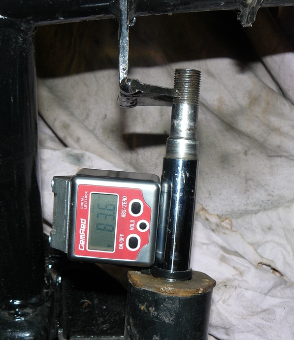

db wrote:I'll put spacers in like you suggest. If nothing else, it'll give me more room to weld between the brackets. Ta mate ;)

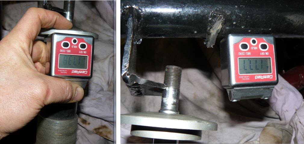

If you use your digital level, you can establish the set point, mark datum. Then move strut forward 1 degree, mark point. The distance between the 2 marks will give you an idea of spacer size, etc
Posts: 8369
Gotcha. I like that.
Posts: 8369

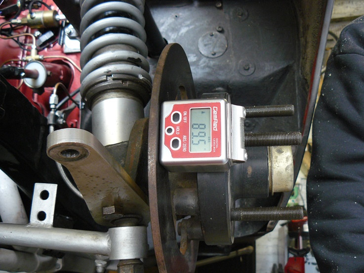

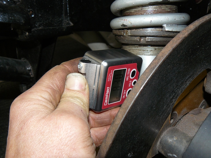

Like this Mark?
I make it exactly 0.3" (it moved slightly as I took the pic)

Posts: 8369
I sent the budget rod ends back and upgraded to super dooper ultra mega ones.
Bearing Man supplied the taper rollers and Namrick the nuts & bolts.
So, it was out with my trusty angle grinder and I knocked out the 4 brackets.
I found 2 stacks of washers equal to 0.3", assembled the bits and tacked the brackets into place.
I removed the bolt & rod end out of harms way before fully welding.
The sheet I used to protect everything from grinding debris and weld spatter caught fire at least 10 times :thumbright:
I'm chasing my engineer mate to turn proper spacers, loan me a 5/8" x 20tpi tap to lengthen the thread on the shock rod, and to turn the spring retainer plate to fit the taper bearing.

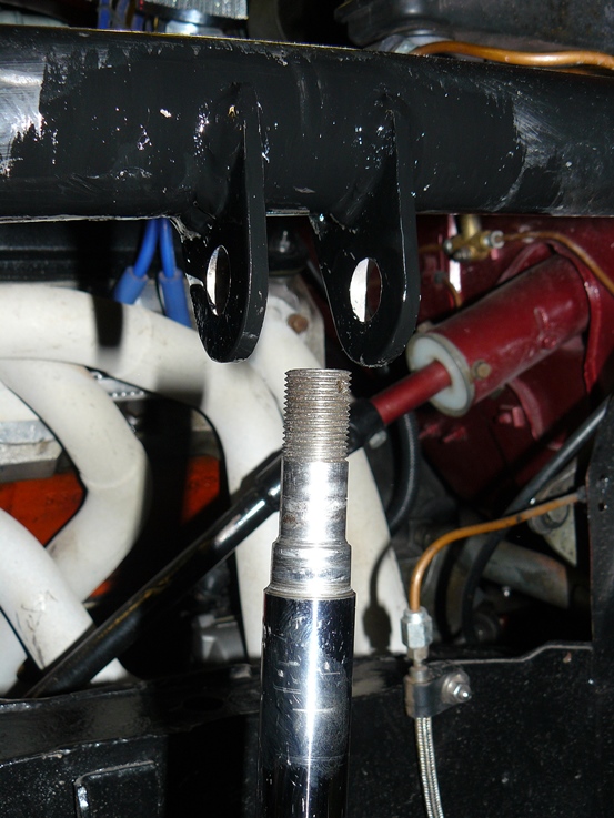

Welded & painted.jpg (193.69 KiB) Viewed 1394 times
Plates tacked with temp spacers.jpg (196.14 KiB) Viewed 1394 times
Unequal plates made.jpg (191.87 KiB) Viewed 1394 times
Brackets and bearings.jpg (201.79 KiB) Viewed 1394 times

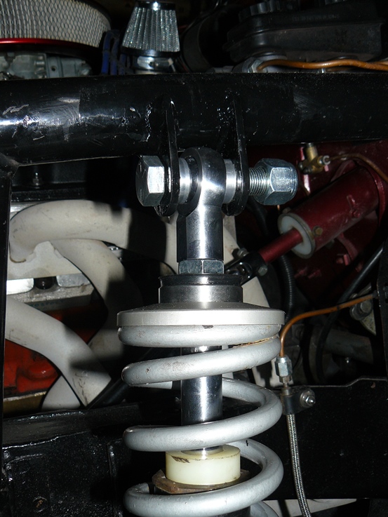

Posts: 8369
My mate Kai helped me get it all back together and set the geometry.
I used my wonderful digi spirit level, and made a very simple but very accurate toe-in gauge.
Camber is 0.5 degrees neg.
Toe-in 2mm.
Castor might be a bit much at 7 degrees, the steering's a bit heavy but very stable in a straight line!
I might pull it back to 5 and see what that's like.
I think the shocks are bottoming out so I'll up the preload a bit for now. New dampers & springs are on the long-term shopping list.
02 Strut top finished.jpg (194.3 KiB) Viewed 1342 times

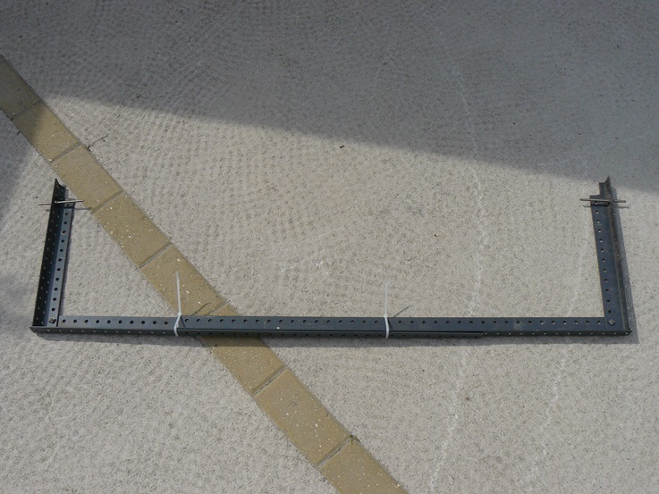

Posts: 8369
Now don't laugh, my Built in 5 minutes for free toe gauge doesn't look like much but it works great!

sidewaysjas
Posts: 177
Joined: Thu Feb 24, 05 10:10 pm
Location: Dorset
toe in gauge
Post by sidewaysjas »
Looks good, I made a similar one and it works fine. Okay it doesn't measure down to fractions of a minute but its not F1 stuff.
Jas :thumbright:

Dave-R
Posts: 24752
Post by Dave-R »
I think 5 degrees on the caster will be plenty enough. ;)
