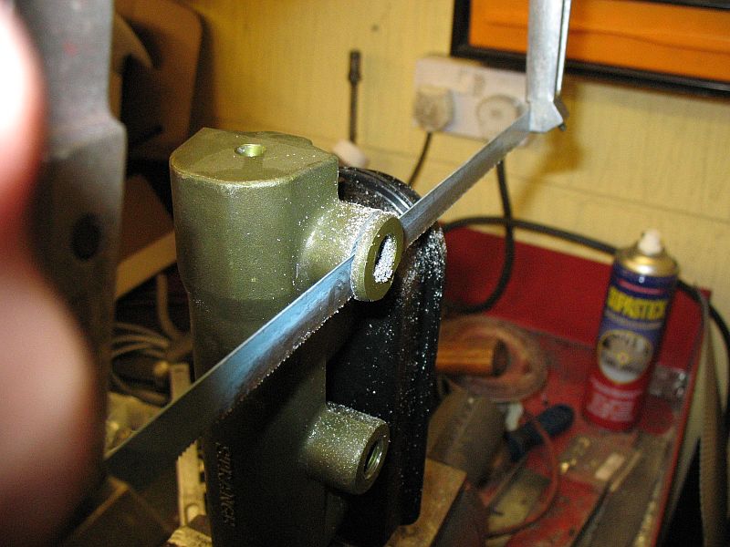

Trying to sort out the brakes at the moment.
I had a faulty brass fitting that wouldn't seal. Then I went and stripped the threads trying to tighten it. :roll:
So I had a pair of braided hoses made up with steel fittings.
However the steel fittings were slightly too short for the ports on the master cylinder. So I had to cut the master cylinder to get a sealed fit.
In the end I found that only 2mm would have done. But never mind.
Taking 4-5mm off the master cylinder outlets.

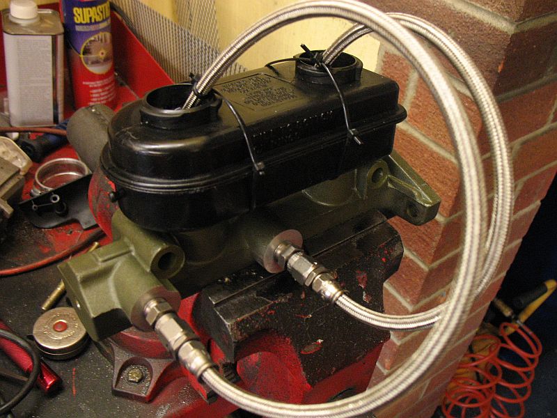

Ready to bleed the lines.
Flexy hose makes bench bleeding much easier.

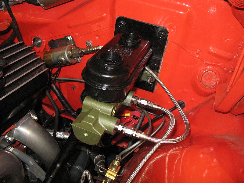

£42 from Speedflow which is probably twice as much as they would have cost from Jon B on here.
You will need to know exactly what fittings you need for each end.
Most master cylinders like this Strange Engineering one are 1/2" - 20 inverted flare.
The brake hardline fittings on mine are 3/8 UNF inverted flare.

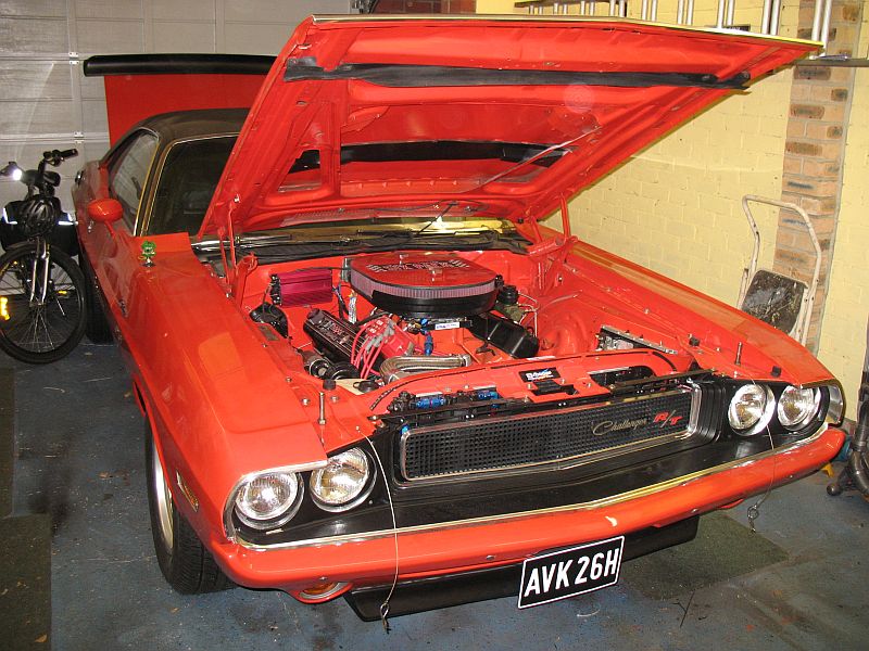

Nearly there.
The hood is proving difficult to align.
The battery is either knackered or the charging system has packed in. Not sure which.
But apart from that she is a runner. :thumbright:
Needs a machine polish and the paint touched up in a few places. Nothing serious though.
