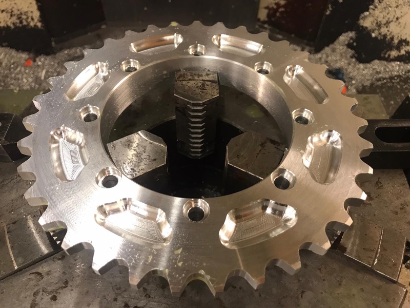

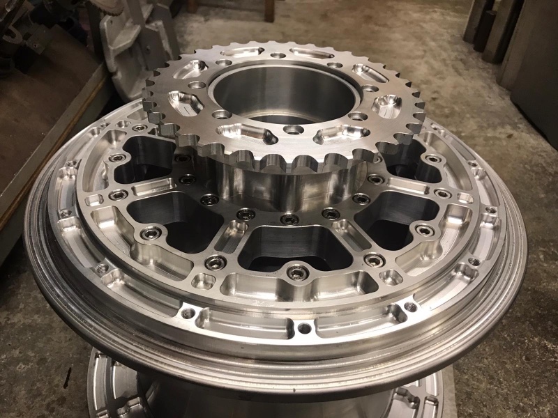

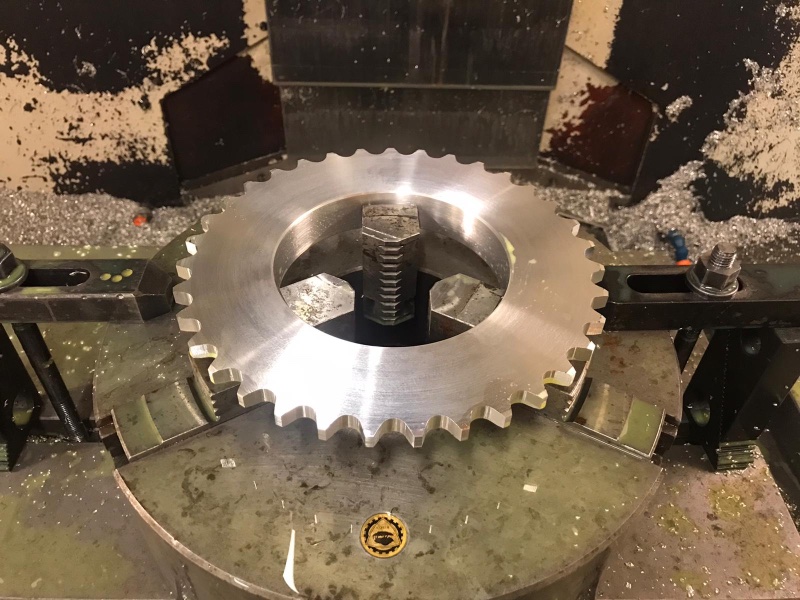

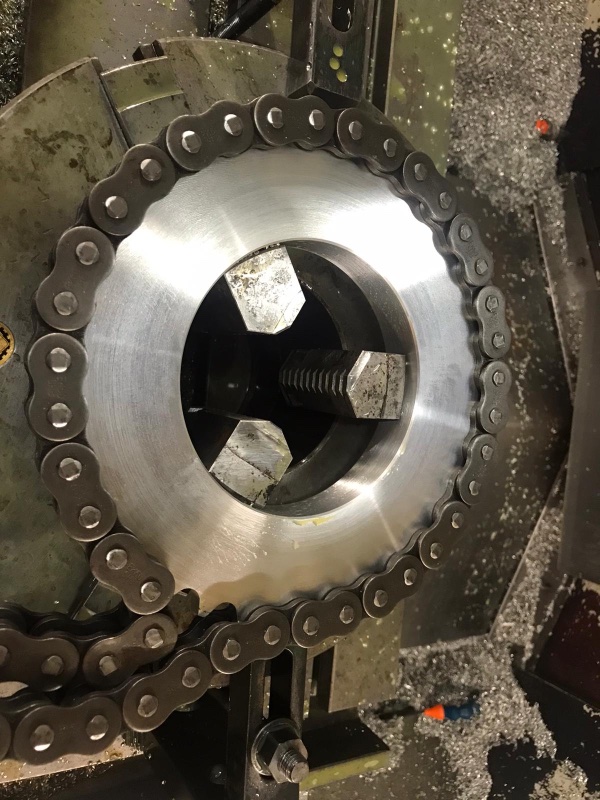

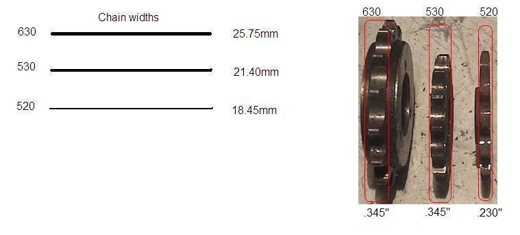

Chain
Most street bikes run a 520 size Chain and performance drag bike 530.
When you look at top fuel bike there running huge 630 size chain.
To save any tears later 630 big boy chain it is and we machined sprockets to match.

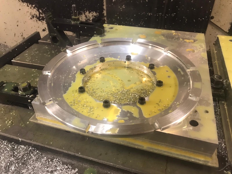

Certainly racking up the man hours on the CNC equip :D :D

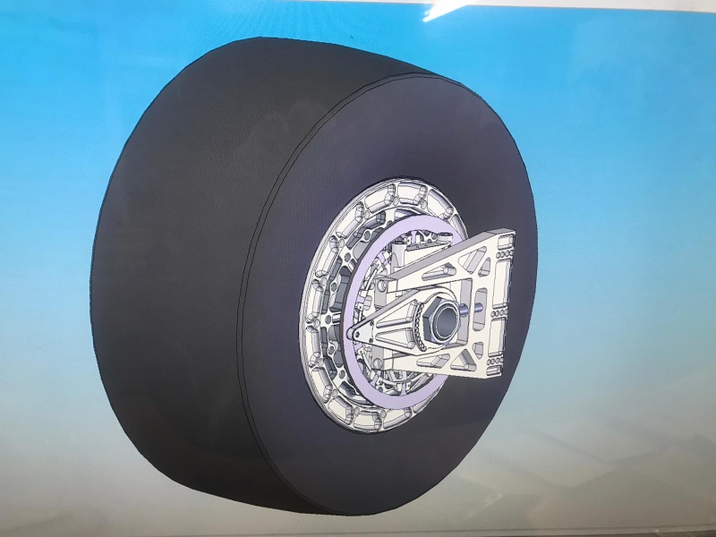

looking at optimizing and reducing drag lastest design

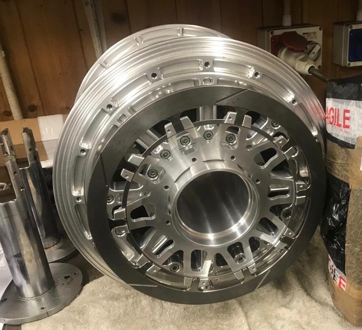

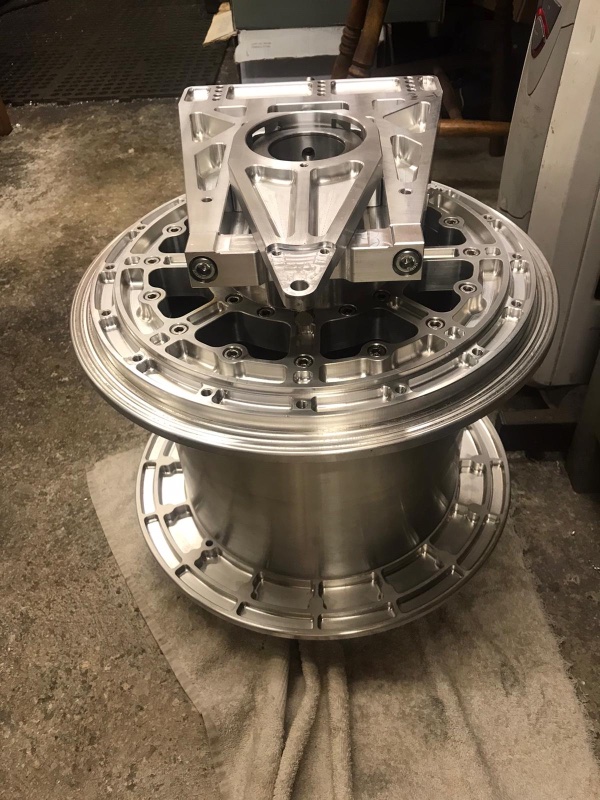

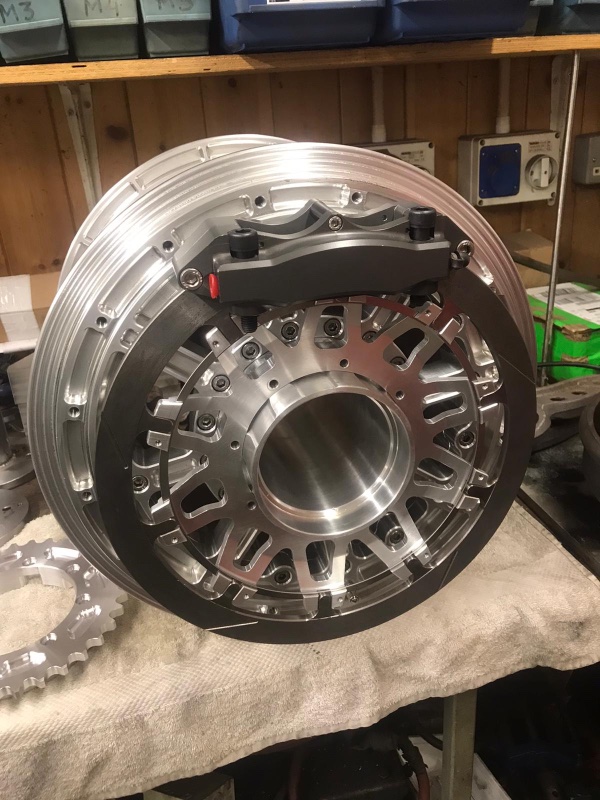

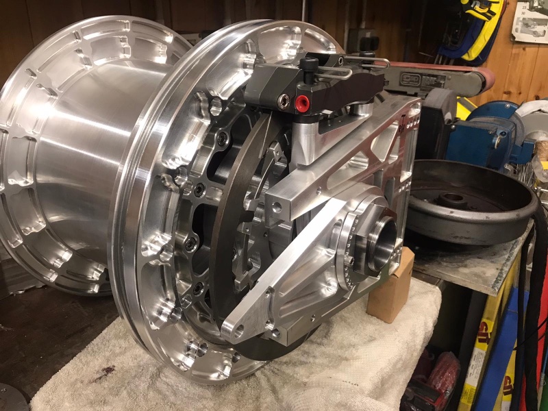

Have you weighed the rear wheel Assy, just curious on weight
Re: Fifty shades of Jade
18kg
I’m not trying to make it light I want it heavy :-k
:read2:

autofetish wrote: Sat Apr 10, 21 9:26 pm :thumbright:
18kg
No i understand & I read that earlier about wanting weight over the rear. Was just curious on what it weighed, no other reason.

mopar_mark wrote: Sat Apr 10, 21 9:37 pm
No, I understand & I read that earlier about wanting weight over the rear.
Nah :shock: I can easily move weight over the rear like tanks fuel etc
but what we are doing is the opposite of what everyone else is doing. :shock:
We are increasing wheel wight to increase gyroscopic mass for greater stability.

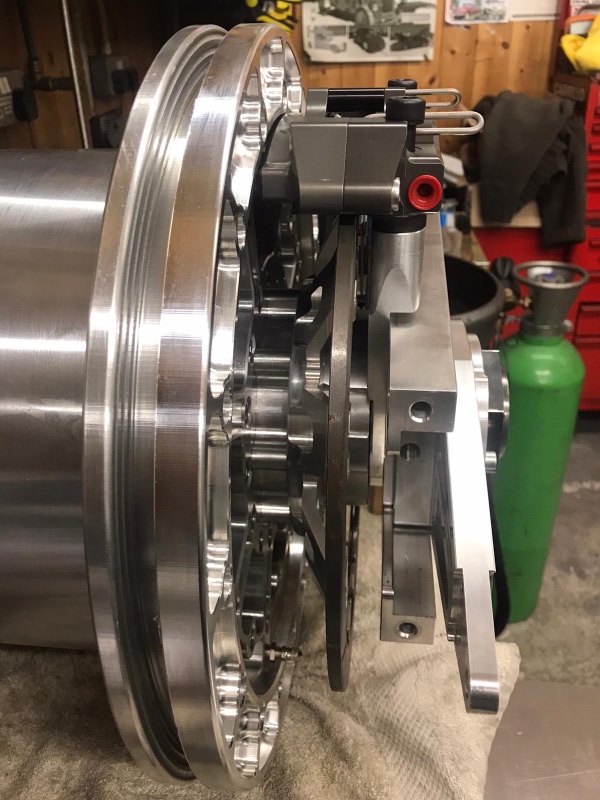

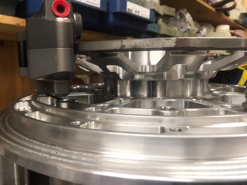

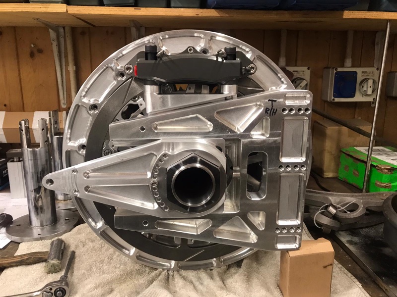

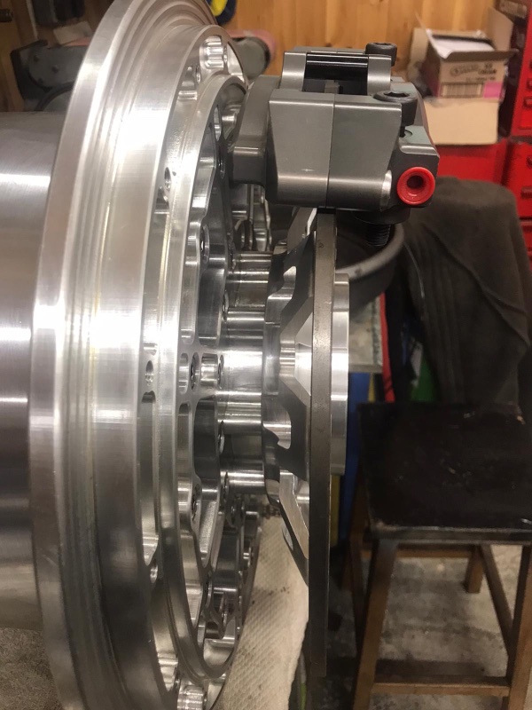

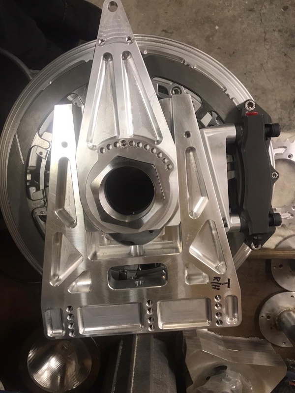

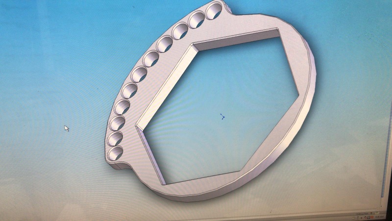

Wheel Nut locks 8-)
Torque Wheel nut then installs a bolt through plate to act as a secondary locking mechanism.
Just need to find a socket to fit now :roll: ;)
