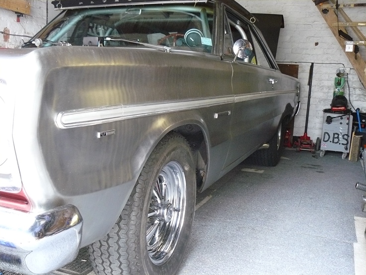

Popped all the side trims on yesterday.
I've re-jetted the primaries up 1 and secondaries down 1, not had chance to try this out yet though.
I've bought another shifter from the US- the mech will be a handy spare and it has a much longer stick with a bigger bend so I'll be able to do away with my not-very-pretty adaptor plate and hopefully not punch the dash again...
I remounted my battery tray- I had sat it on Mini exh bobbins but I realised in a crash they would shear and let the battery loose, so I've bolted the tray through the floor now with some thick rubber washers under it.
Side trims on.jpg (217.86 KiB) Viewed 1626 times
