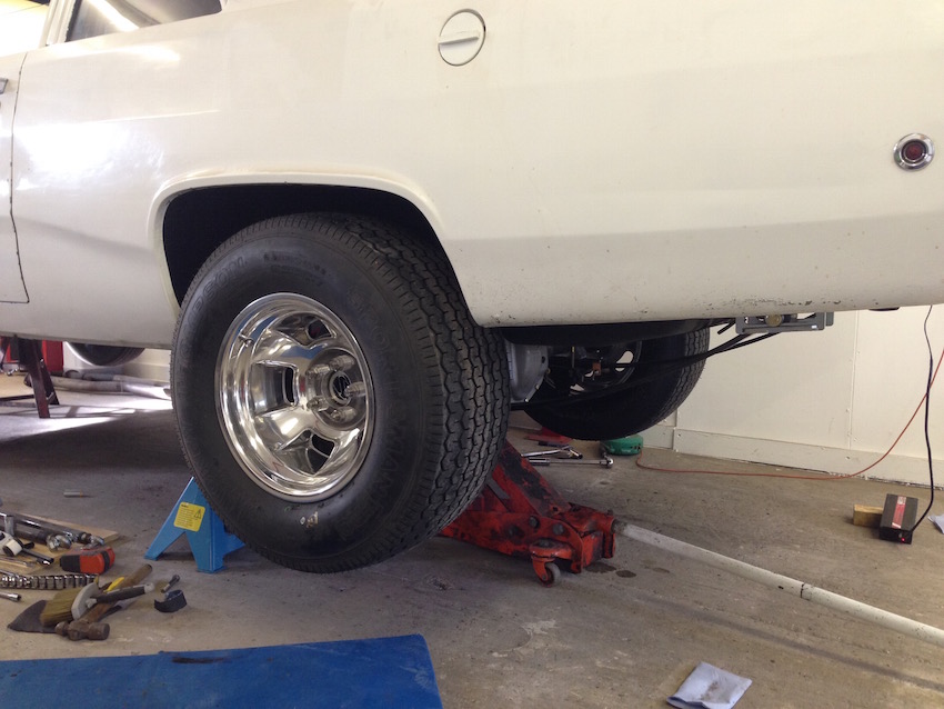

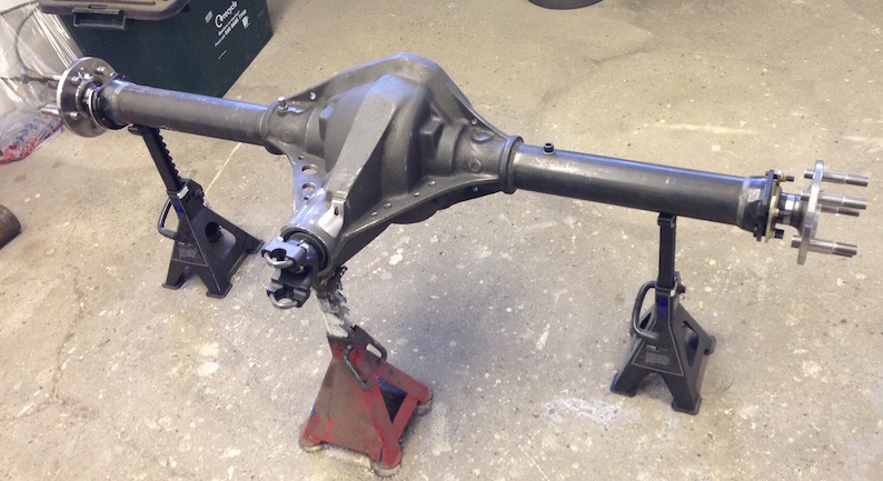

Time I tried this thing for size, custom width Dana 60 with 4.10 gears and a True trac diff & 35 spline shafts. Wheels are 10x15 with Mickey Thompson 29x12.50 tyres. Just need to get it spot on central, get a prop made, set the pinion angle and weld on the perches. It can all come out to be painted then refit and build the brakes up.

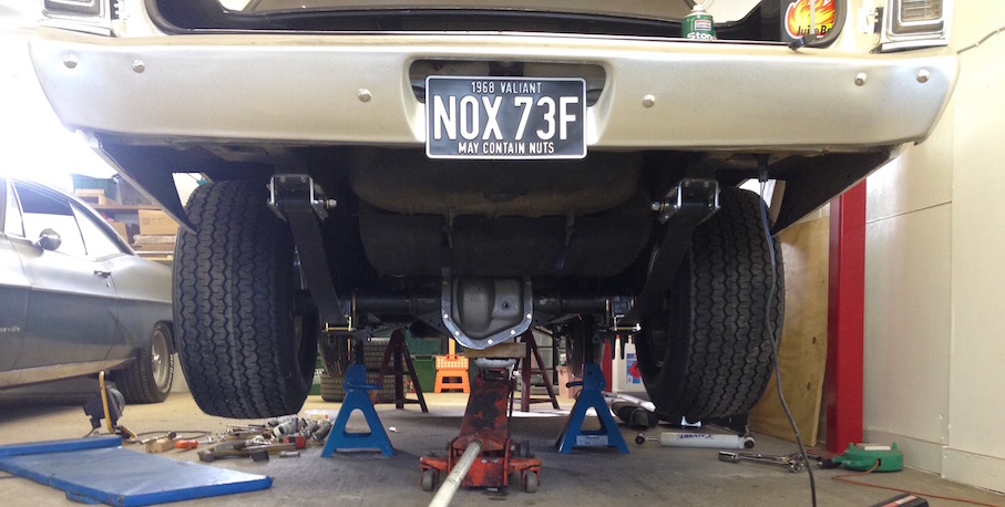

Final ride height should look something like this...

Looking good. Good to see the dana shafts welded, i witnessed an 8.8 housing spin on the tubes the other week......

The wheels locks nice just tucked in the arch :thumbright: what will the stance be like? Be nice to see the angle of the body... That Dana is =P~ Even more holes I see... What will your high gear ratio going to be in the manual tranny? love my 4.10,s 8-)

Looks great, are Dana axles much more heavy that other units?

Don't tell me that was the reg number the dvla doled out to you :shock: is she going to get juiced? Sorry so many questions :lol: you don't have to answer... All will be revealed in time.... :thumbright:
Posts: 14602

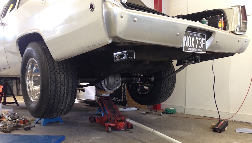

Yes that's the reg the DVLA gave me, no it won't be on nitrous! This is how it sits on the floor, about an 1.5" rake which is what I was aiming for. Danas are supposed to weigh 75lb more than an equivalent 8.75, I don't have scales with enough capacity else I'd weigh it. It must go a good 200lbs I can barely lift it on my own.

That stance looks great =P~

Yep the stance is a thing of beauty. Well done dvla! Those rims are looking gorgeous... Didn't realise that a Dana was that heAvy :shock: just gets better and better Blue, you must be very happy :thumbright:

75lbs worth of new holes to make to get back to where you were?
