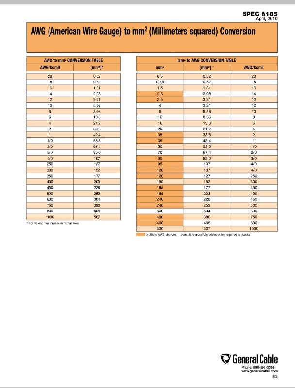

I’ve decided to rebuild the harness myself, but being an electrical thicko, I’ve no idea what gauges of wire to order. :scratch:
I’ve got a full colour wiring diagram, but no idea how to figure out the gauges! Any helpful advice out there? Don’t want to be responsible for it burning to the ground! :working:

This might help Stu, I rounded up to the next size of wire when making my looms.
Screenshot_20230518_192718_Adobe Acrobat.jpg (63.59 KiB) Viewed 2944 times

Cheers Dave. :thumbright:

I did the same as Dave and rounded up.
You can get nearly a 1v drop over the length of the car if there are bad earths and the gauge is too small..
