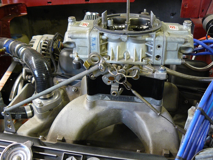

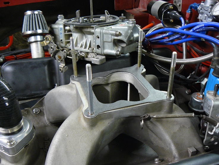

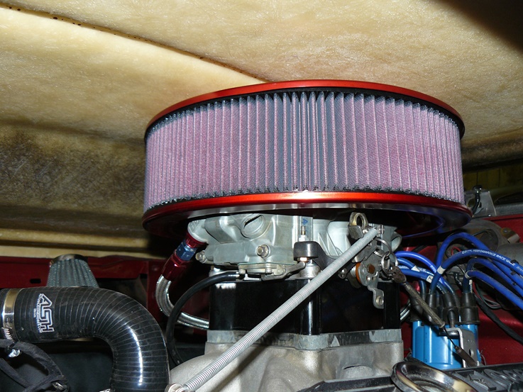

It was sulking a bit cos I'd fitted my 2" carb spacer (thanks to Bozwell's 4" studs) and my new 4" K&N but didn't have time to up-jet it :roll:

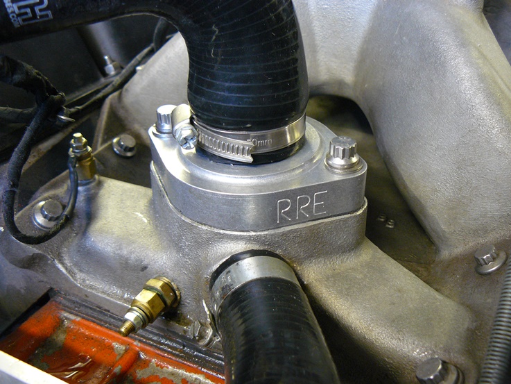

I've also fitted my new Thermostat housing from Trev so no more water leaks.

...and the carb bits.

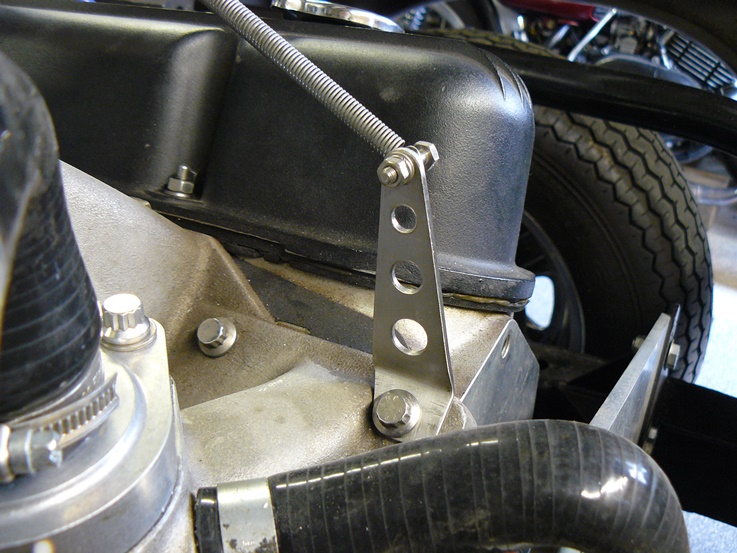

I made meself a little bracket for the throttle return spring.
Hood clearance not much!.jpg (204.4 KiB) Viewed 1656 times
Carb spacer stack fitted.jpg (210.53 KiB) Viewed 1656 times
Bozwell studs.jpg (196.48 KiB) Viewed 1656 times

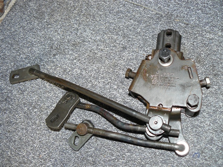

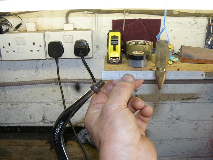

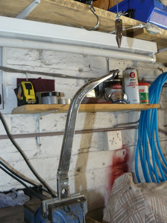

The shift lever i bought turned out to be wrong so i tweaked it a bit.
It needed to come back 3" and 2" to the left.
I grabbed it in the vice and hung a plumb line from the end of a screwdriver i stuck in the shelf above to mark where i wanted it to end up. I'd ground the chrome off and sliced nearly all the way through it with my trusty grinder so i could easily bend it into place.
I welded it up and even though the join is hidden under the boot, i gave it a squirt of chrome paint... jobs a good-un :thumbright:

Wow I like the spring bracket I always wanted something like but I am not that crafty or have the proper tools,looks great :thumbright:
And what did you use for the throttle cable linkage ,they look like key rings? :scratch: :scratch:
Love this sooo much
Great work keep these post coming
What is the little bracket made of Alu ?stainless
Good work Paul.
No more punching the dash on shifts now ! :thumbright:

There needs to be a tang on that throttle spring bracket to stop it twisting. Can't see if it has one in the photo for the top hose.
Posts: 8369
Thanks Dave- the area to the top left of the bolt contacts the inlet casting to stop it twisting.
Drew- if by 'proper tools' you mean a hammer, an angle grinder and a hand drill... ;)
Mossy- yup, perfect now :D
Will- I knocked it up out of a bit of old stainless. The finish is scotchbrite & WD40.

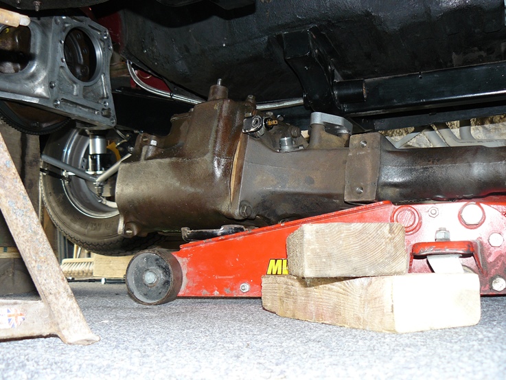

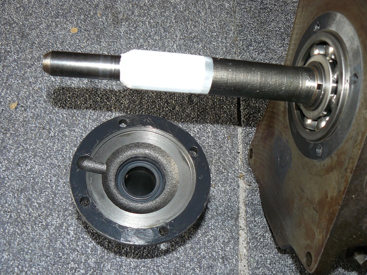

Well now I've at last CURED the big leak from the gearbox input shaft, I can see all the minor leaks!!
I've replaced 2 oil seals on the shift pivots, the seal on the neutral switch, PTFE'd the drain and fill plugs and popped off the side casing and siliconed it (quite a challenge with the gearbox still in the car!)
I took it out for a blast today and the trans appears to be completely oil-tight now :D
I've done a bit of jetting too- idle screws out 1/2 turn and up 2 sizes on both main jets. Doesn't that say a lot about the K&N filter! :thumbright:
