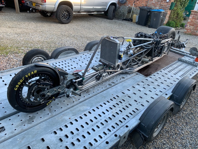

boy that wheel looks butch :thumbright:
Posts: 6743
Re: Fifty shades of Jade
I like the pewter colour anodising contrasting with the black anodise

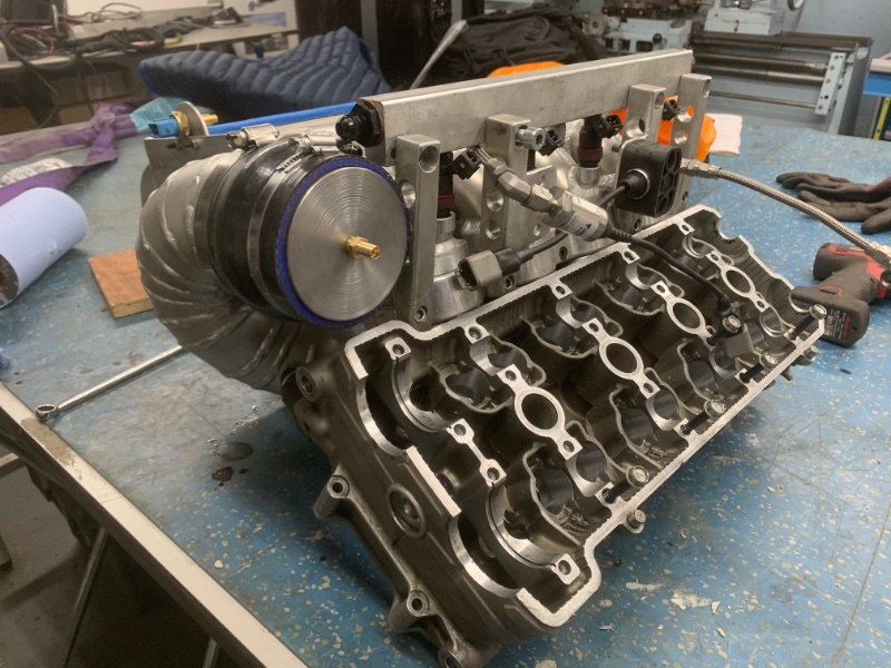

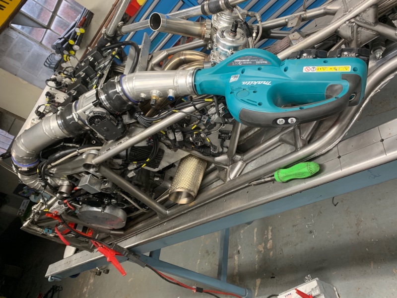

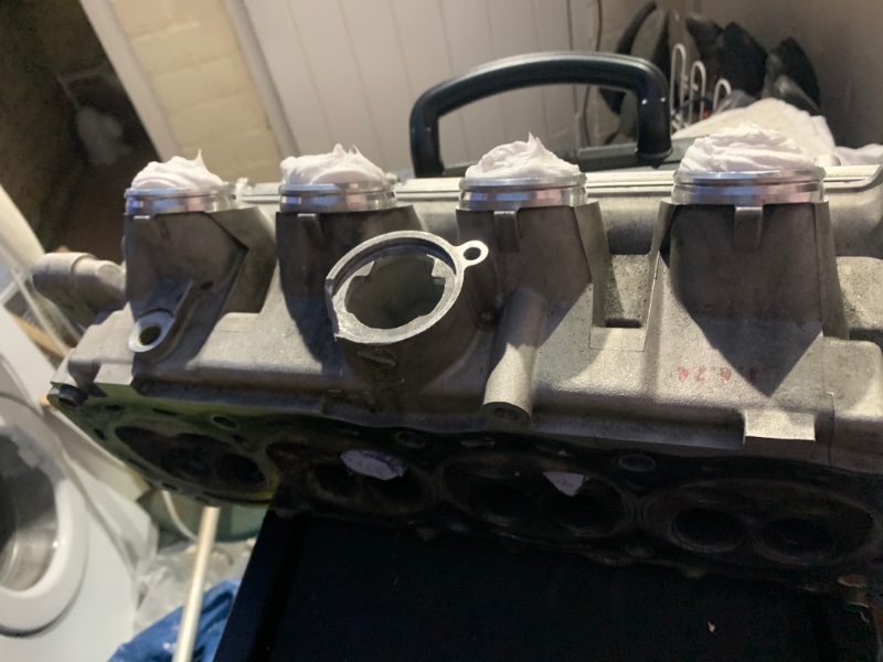

I’m really struggling with an air leak and it’s causing a 3700rpm idle.
I would expect the hole to be huge to cause such a high level but I can’t find it and im worried it could be internal inside the heat exchanger. (Charge cooler)
With the engine running I spray brake cleaner everywhere listening for an increase in revs (as it’s flammable) but nothing.
This normally works really well!
Engine off I then stuck a leaf blower up it’s jacksie with a soaping spray bottle which worked great I’m shocked I would highly recommend it.
I found a tiny nick in an O-ring which I replaced
:-k The leaf blower is very powerful stick this down a 4 barrel on a big block
:geek:

Very creative, good spot!
I thought they all idled that high!!!!

did the new o ring cure it?

Thats an impressive solution. (its how we found leak around valve on my RSfocus - Car is 4 years old and wheels already corroding causing leaks - things are made of rubbish these days. Tyre off, clean valve hole, replace, all fine - but it shouldnt happen!!).
Never thought to apply principle to intake plumbing to find a leak - I like that a lot !

mygasser wrote: Sun Apr 18, 21 10:29 pm did the new o ring cure it?
:help:
Nope still the same :roll:

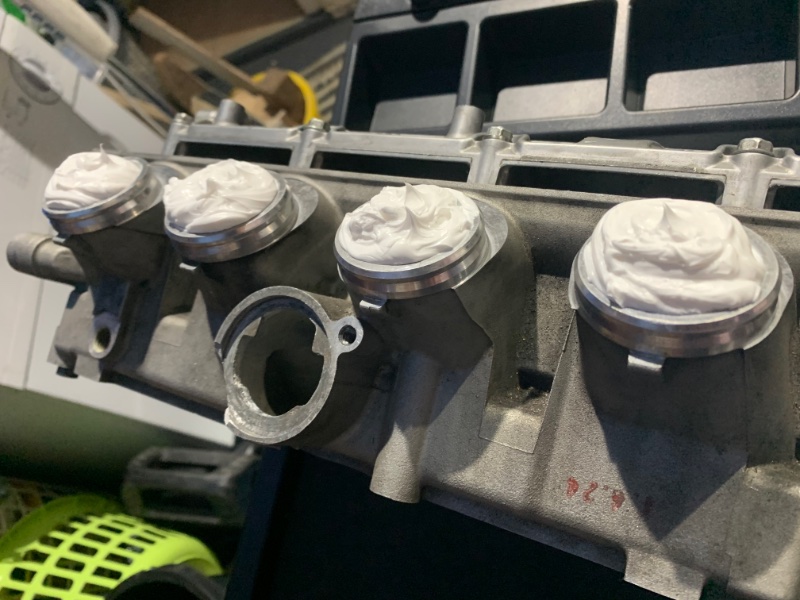

Right let’s have it

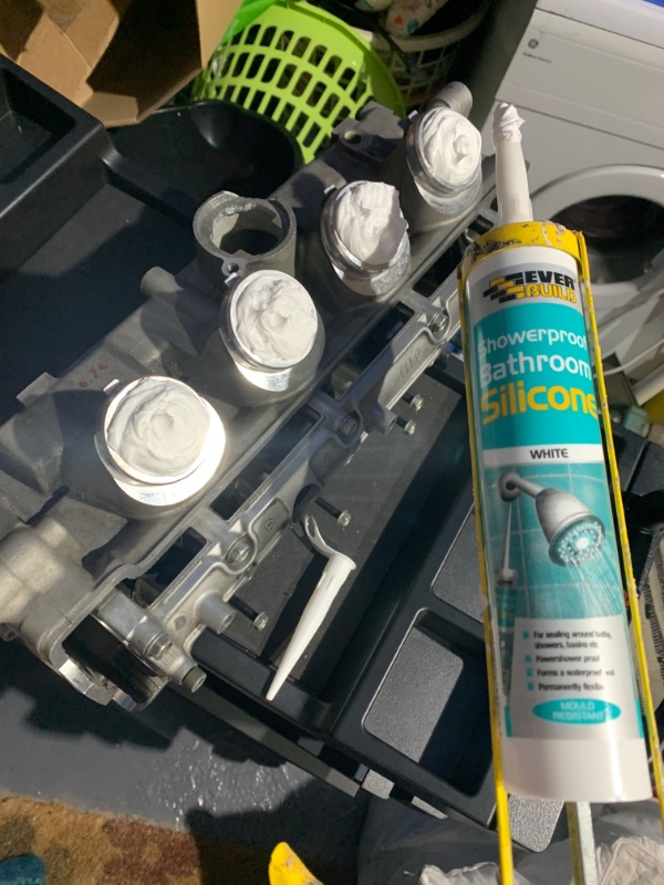

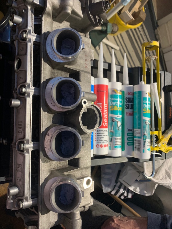

I took an old scrap cylinder head and filled the inlet ports with silicon
I can then use this head as a butt plug and pressure test the complete intake system :study:
Well that was a completely Bananarama! idea.
48hrs later The silicon was still soft and hadn’t cured in the slightest. I basically just decanted it out the tubes into the head.
I borrowed a desert spoon and spent an hour scooping it out.
We are learning

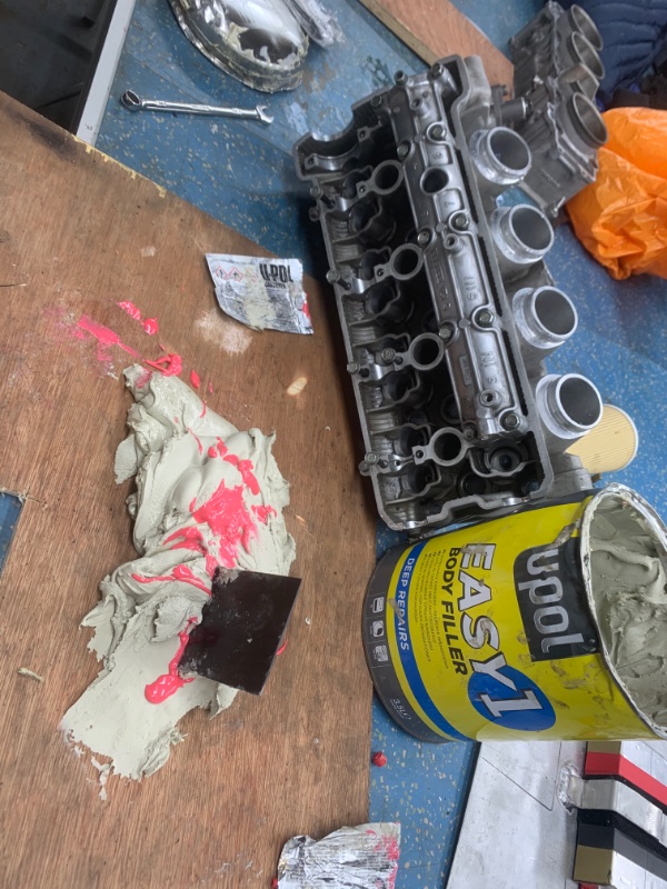

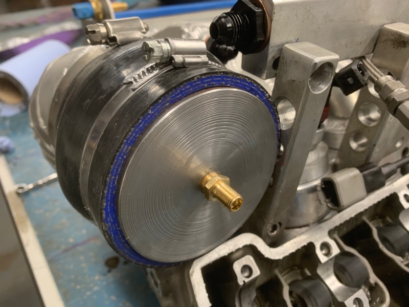

Got out the faithful and tried again
70psi here we come
:D

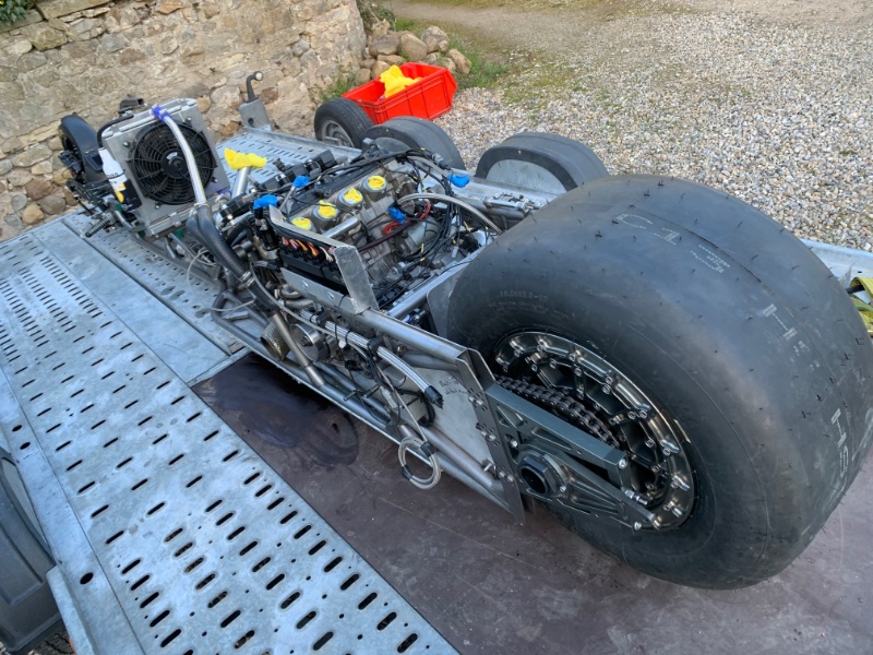

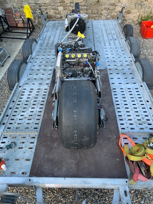

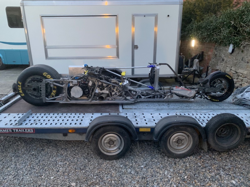

For the first time she is rolling :thumbright:
Chain on game on
8-)

Monster :thumbright:

autofetish wrote: Wed Apr 21, 21 7:28 pm For the first time she is rolling :thumbright:
Chain on game on
8-)
that is so cool looking :thumbright:
