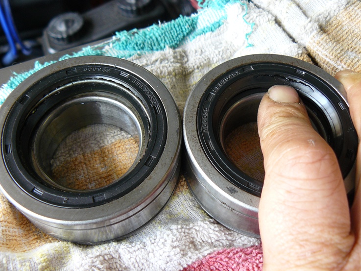

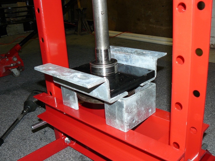

I found the cause of my axle leaks- Crap seals that came with the Strange axles. These have done barely 100 miles and were fitted less than 3 years ago.

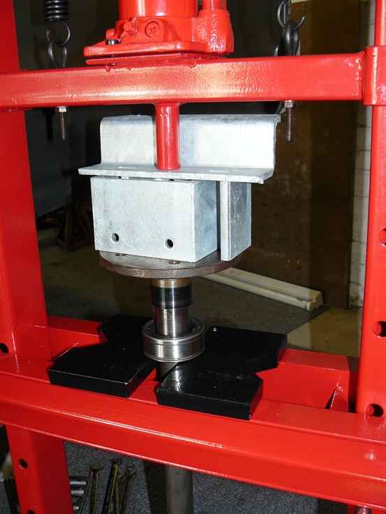

I've put my new press to good use removing the old bearings and fitting the new Green ones.
Tiredness kicked in this evening and my brain went to mush- someone remind me in what order the bits go on... gasket then brake backplate then the retaining plate.?
Bearing coming off.jpg (188.18 KiB) Viewed 2101 times

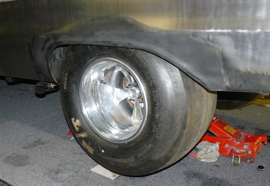

After a lot of frustration I found a local ATS that could cope with my big fat tyres.
New 16.5 x 31 x 15 M/T Street ET's now fitted, balanced and on the car :D
Brakes are bled, axle bolted back on.
I need to check wheel arch clearance carefully!

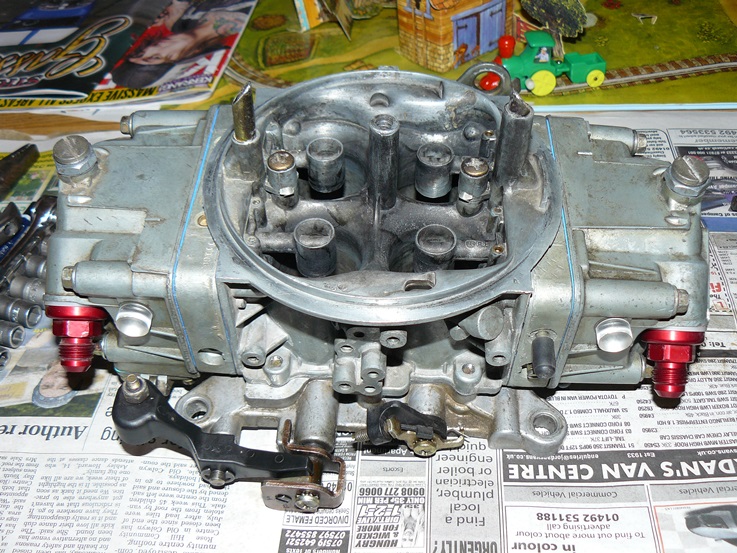

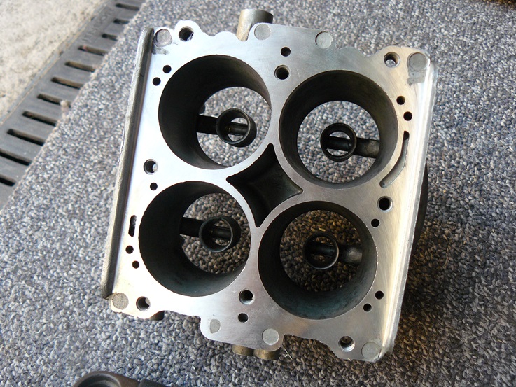

I got my 750dp carb body back last night from having the bottom machined flat (15 thou taken off). That's now built, including a few bits robbed from the old carb, and ready to install.

Posts: 14598
Do yourself a favour and chuck those clear sight plugs away. They seem like a good idea, but then they go cloudy so they are worse than useless, and then the top breaks off causing a leak when you least expect it. Twice that's happened to me at the track, luckily I had the brass plugs with me and something to dig out the remains of the plastic one.
Dave-R
Posts: 24752
Post by Dave-R »
The clear plastic sight plugs I have fitted in the past literally broke apart before the car even had it's first run out on the road. One fell apart as I watched.
Posts: 8369
Thanks for the warning.
I found I had to wet them so I could see.
Also they've gone tight as hell, I had to remove & refit them with pliers, this may be a sign they're on their way out!!
Posts: 22217
It looks like you do not have 4 corner idle there, chap.
Not the end othe world.
Another trick is to crack the throttle blades of the secondaires a smidge - 40 thou or so - BEFORE you mount the carb. That will give you a better chance of getting the bugger to idle...........
Posts: 8369
Correct Pete, just primary idles.
I had to do the same as you suggest for the other carb.
In fact I found I needed to crack the secondaries open further than recommended (so the slot appears 'square' below the blades) as it just didn't like it.
Luckily as I have the hi-rise manifold (and now 2 1/2" of spacers) I can easily adjust the secret screw when the carb's fitted.
