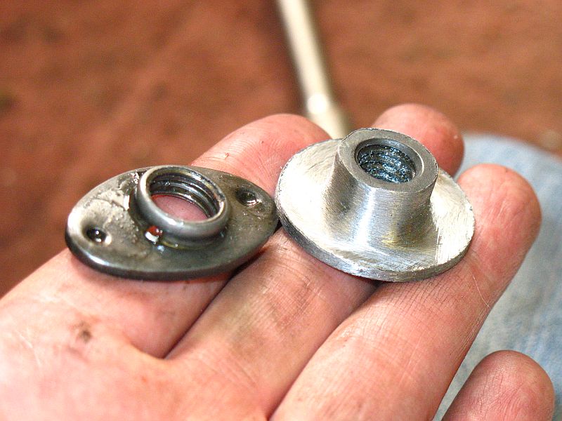

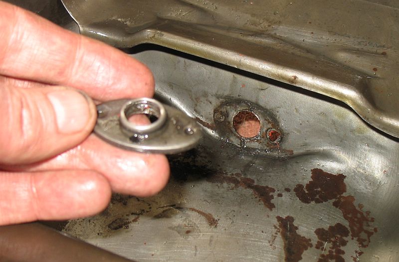

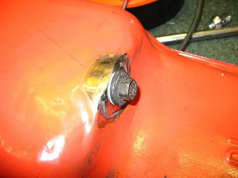

Tried to do an oil change last night and stripped the threads on the sump plug.
No spare and nothing that would fit.
So dropped the suspension, dropped the sump, and made a new threaded insert with a nut welded to a thick washer for a big bolt.
I was on until bloody 10:30pm last night with it.
Looks ugly but it holds oil. :thumbright:
