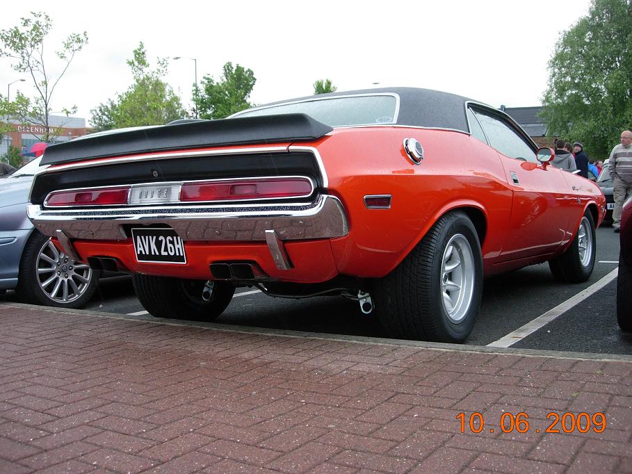

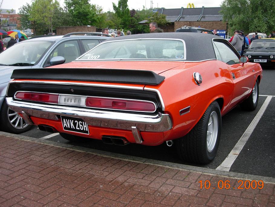

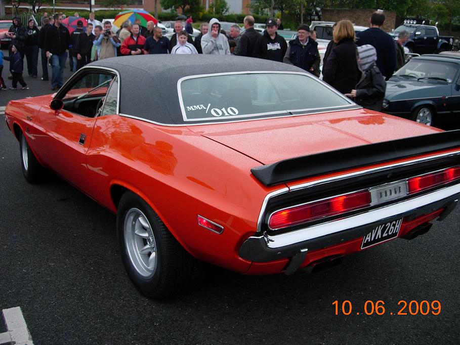

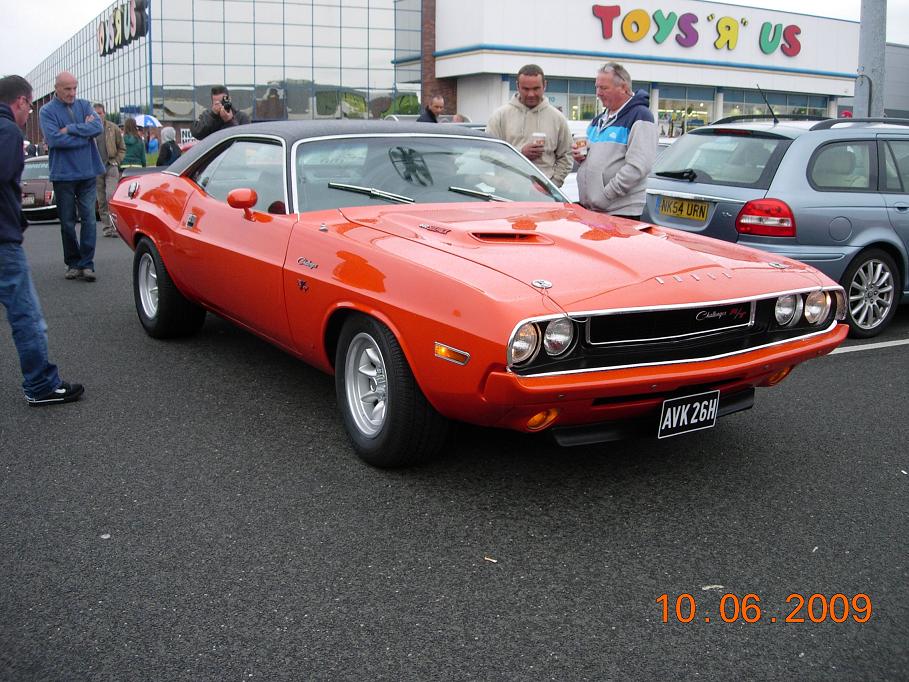

good to see the car out at last Dave, even if it was in miserable weather.
Certainly created a stir on arrival. Loved the electric cut outs on the exhaust :evil:

Thanks for those Neil. :thumbright:

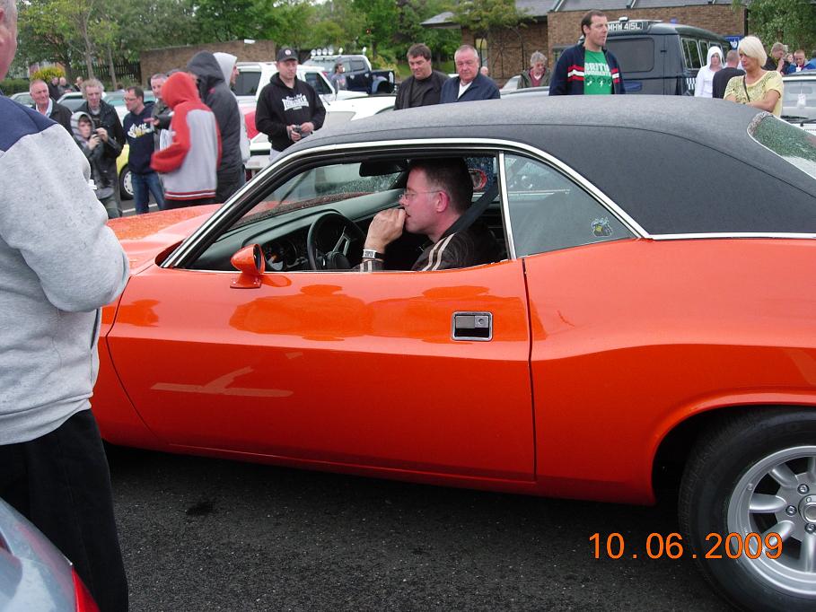

An absolutely epic performance Dave, bloody well done, it looks amazing, despite you looking a bit pensive at the wheel! :thumbright:
