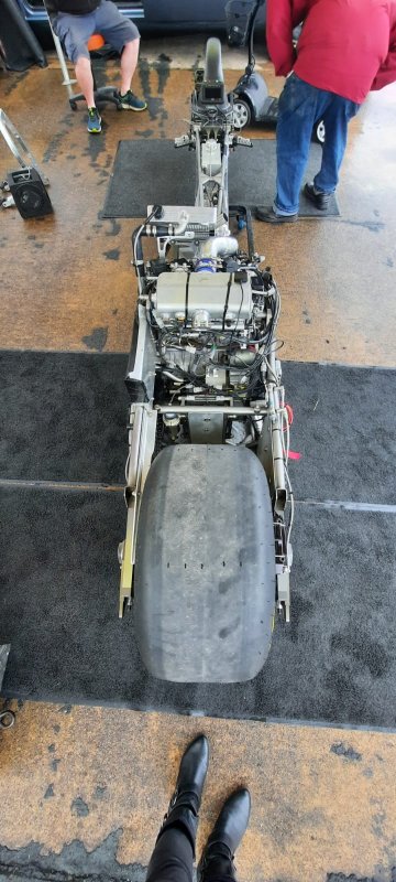

:read2:
IMG_1827 - Copy.JPG (113.67 KiB) Viewed 3393 times
IMG_2388 (2).JPG (125.4 KiB) Viewed 3393 times
Re: Fifty shades of Jade

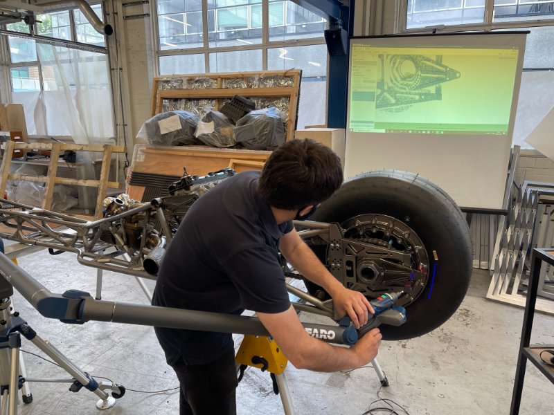

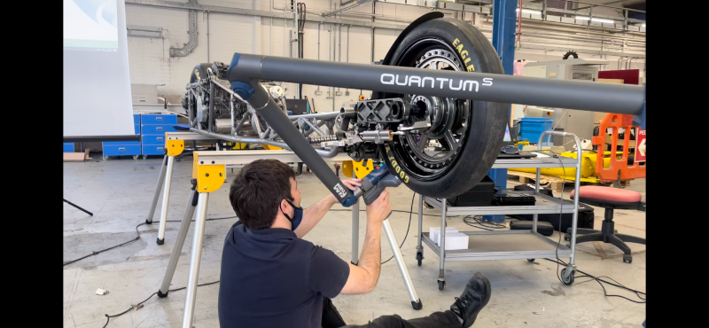

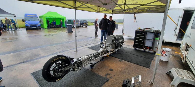

We got all the toys out boys
This is as good as it gets

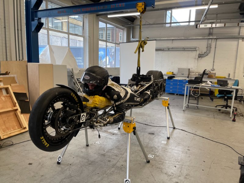

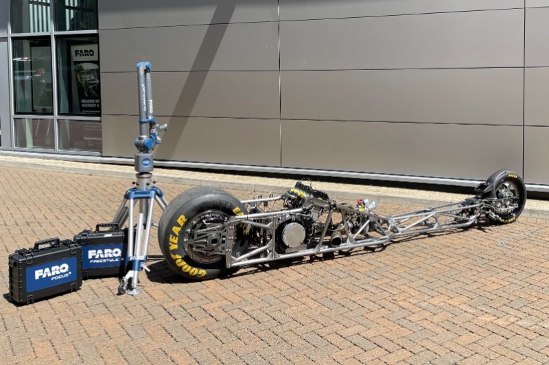

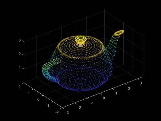

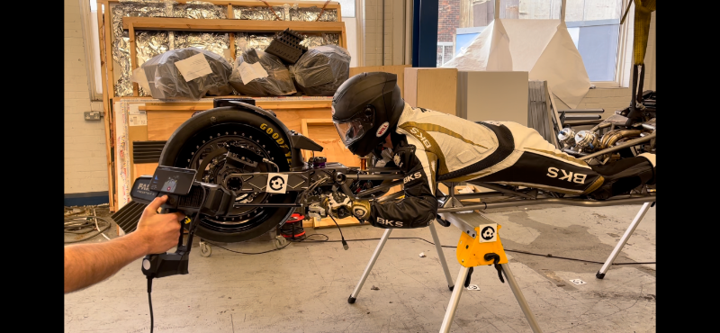

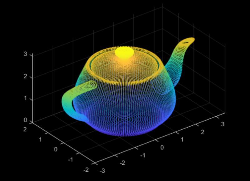

From these scans using different technologies we where able to create a point cloud.
Point clouds are datasets that represent objects or space.
These points represent the X, Y, and Z geometric coordinates of a single point on an underlying sampled surface.
:read2:
All in we collected 80 Million !!! points !!! down to 0.05mm :shock: :shock: :shock: :shock:
The data set is huge and it will take us weeks to digest the data but thought I would give you all a little taster :thumbright:

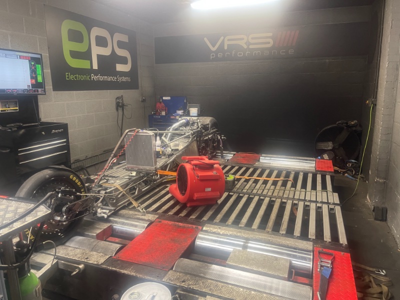

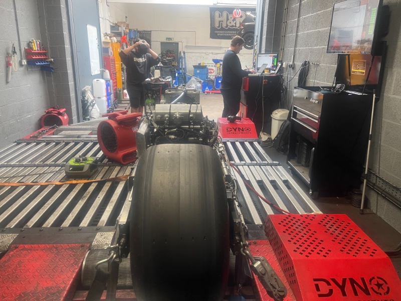

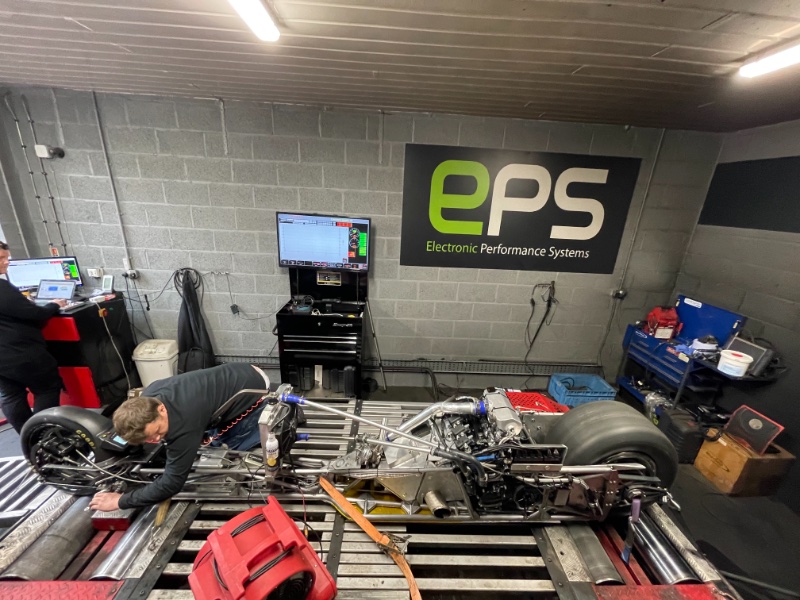

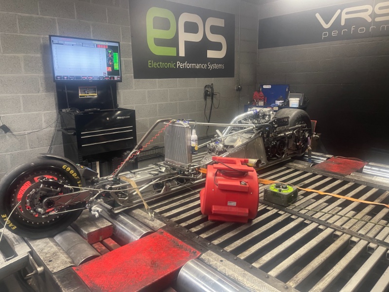

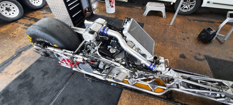

Fully mapped and configured :thumbright:
As this is a standard test engine we run very low boost and rpm levels
She made 308hp @ 9500rpm (Some Rev them to 13k+ :shock: )
Super safe but great for testing and learning to ride her :thumbright:
Post by morgan »
Thats a good number for that size engine at modest (for a bike) revs!
Q - 308 @9.5 and then started to fall away or 308 and still climbing but you stopped revving ? e.g. more to come when you wind it up ?
morgan wrote: Sun Jul 11, 21 9:53 am Thats a good number for that size engine at modest (for a bike) revs!
That's correct just being super safe as want an engine that will really last.
These engines will make 800hp turned right up and pull till 14,000rpm but for testing, 300hp is more than enough.

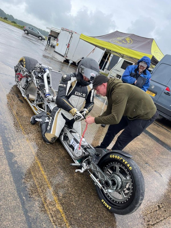

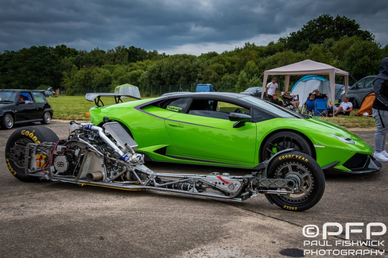

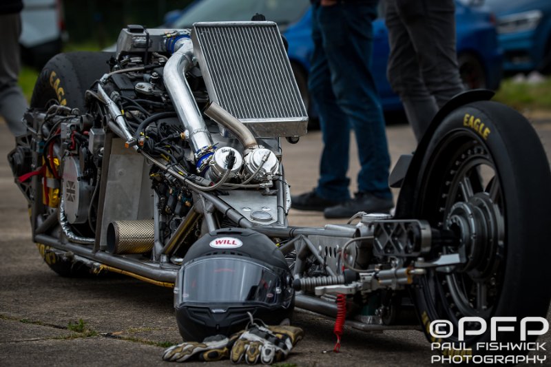

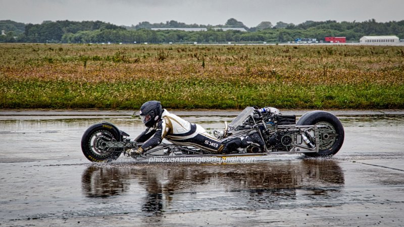

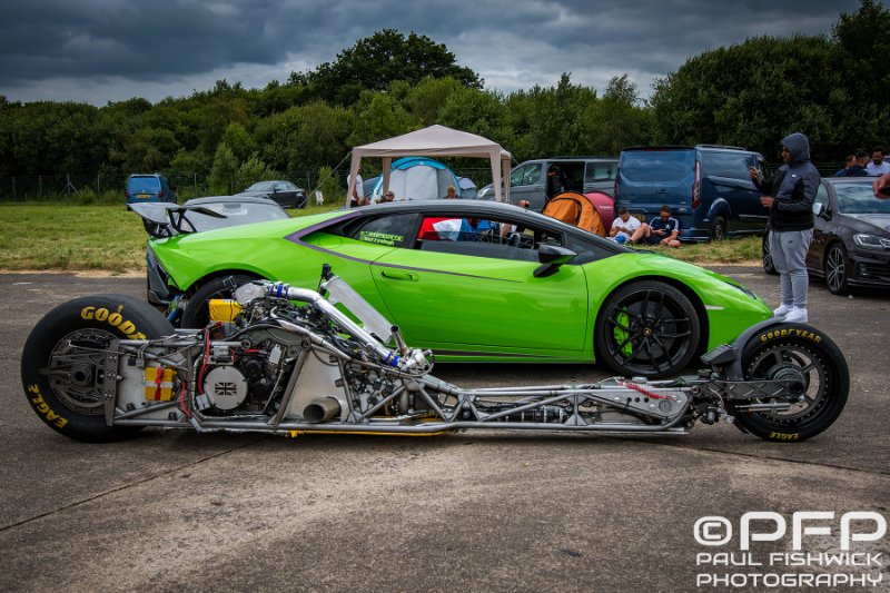

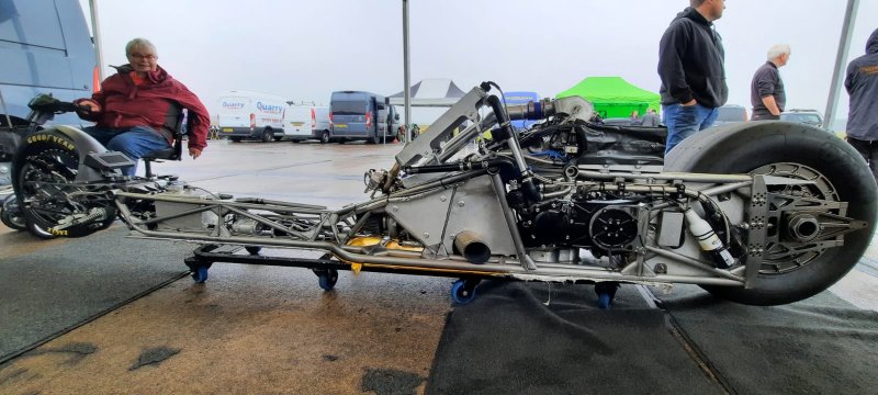

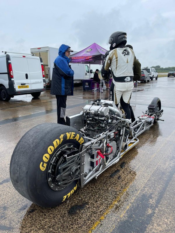

A very very very wet day on the Airfield.
Most people had gone home and given up but at 3 pm just before the staff started to pack up i said Bananarama! it.
Put on my leathers and out she went for her first run standing water and heavy rain.
She felt stable and run straight :thumbright: 64mph on GPS :thumbright: :thumbright:
Game on
Thanks for everyone's help and support couldn't have done it without you all :thumbright:

Sorry the weather was Bananarama!, Elvington looks so drab. On a positive note, the bike looks ace even without the bodywork.
Good luck :thumbright: :thumbright: :thumbright:

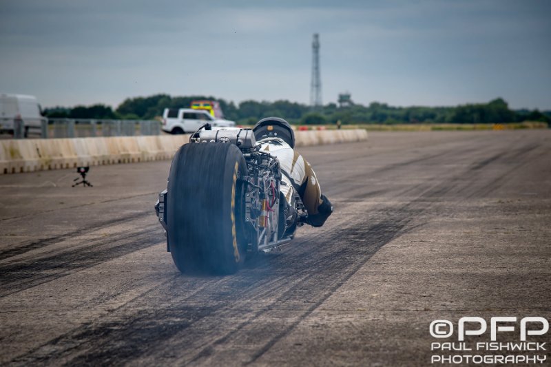

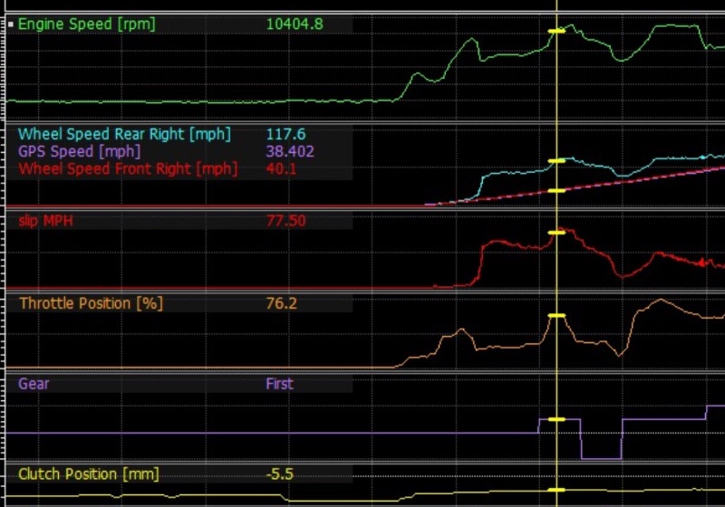

Off the trailer first run 11.92 @ 140mph a few shift issues but she handles well
