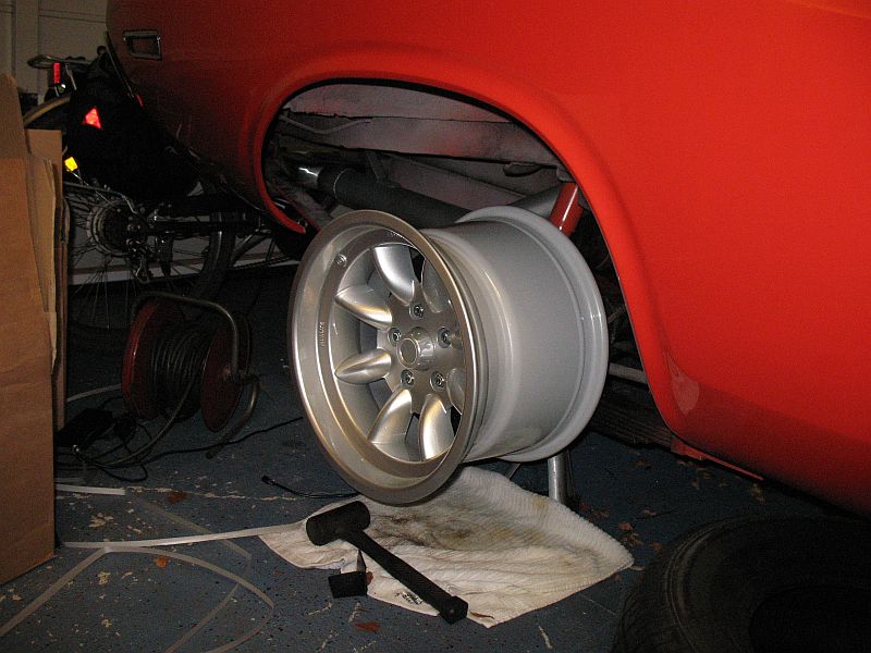

£655.50 later I have my wheels.
Slight problem though (as always).

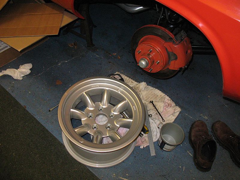

The diameter of the center hole in the wheel is 5mm to small to fit over the center of the brake discs on the front.
I will have to call Minilite on Monday to see what my options are and what they can do to sort it.
I could probably get them machined out at work but not sure how that will effect the powder coating? :?

Just wanted to add. These wheels are the best made wheels I have ever owned. Really good workmanship. They can obviously still do a good bit of engineering in the Midlands. :thumbright:

Look great, Dave. Shame about the fitment issue.
Have you a plan to resolve it ?
And, are you using the same tyres from the original wheels ?

I'll speak to Minilite first but I will probably get them milled to fit at work. Just need to find a guy I used to be in the gun club with years ago. And remember his name. :roll:
He should be able to do it or know someone that can.
New tyres going on Sandy. Same sizes.

I am going to the factory that made the wheels on Monday morning.
A 400 mile round trip but my mate Tim is letting me sleep at his place overnight 12 miles from the factory.
They are going to machine all 4 wheels to take larger diameter center caps at no extra charge.
I am going to take one of the disc brakes with me to make bloody sure though.
I did find someone at work that could machine out the wheel centers but decided it was better to do it right.
