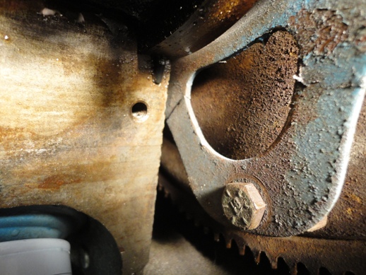

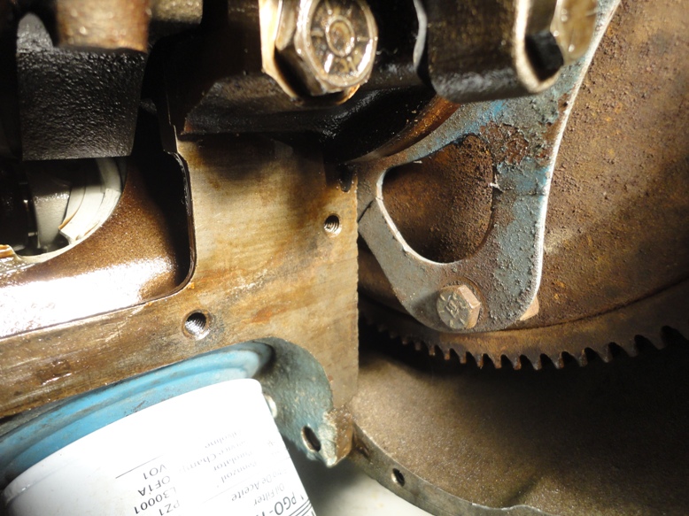

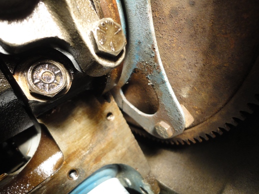

FLEX PLATE IS CRACKED - :evil:
I am now thinking this could have been the knocking noise all along, as it sounded like the back of the engine.
Has anyone else had a cracked flex plate and know what it sounds like?

yes that wuill dpo it matey,,,,,

If this is it i am relieved but also annoyed that I have been everywhere but inside the bell housing to find the noise.
I didnt think my engine build was that bad, and I had not really found anything that would cause the noise. Even the one big end down to the copper I wouldnt expect such a noise from that.
Time to find a flex plate then!
Ive got a spare converter but no plate.

Looks like it,oh well,at least you've got fresh bearings :evil:

Sounds like good new Matt. I'd take that one for the team :thumbright:

Not had a flexplate crack but have had the bolts loosen and hit the block as it rotates which sounded just like the ends or something else expensive knocking.
