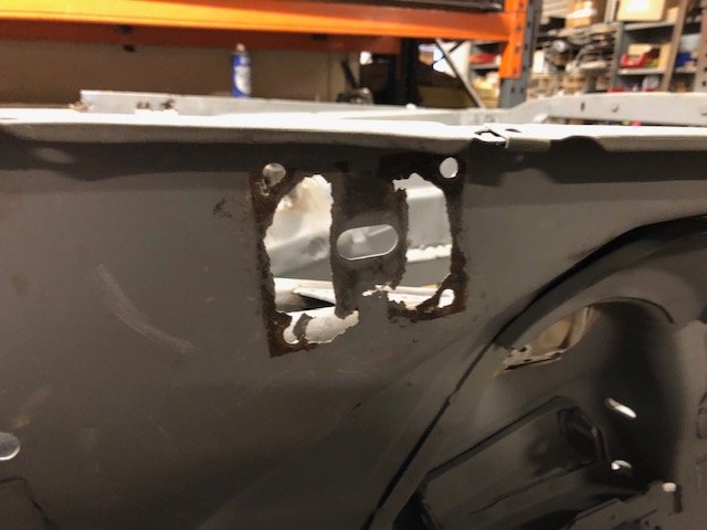

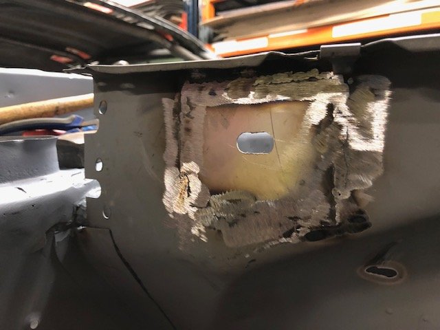

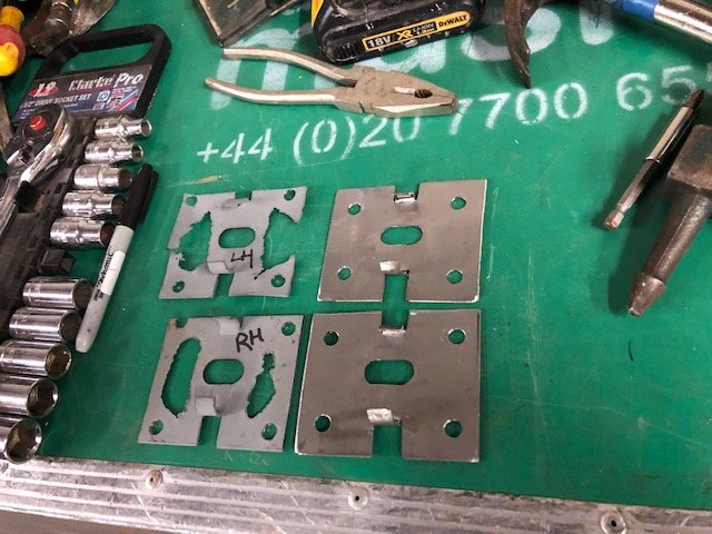

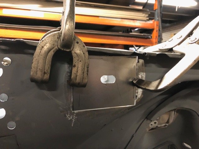

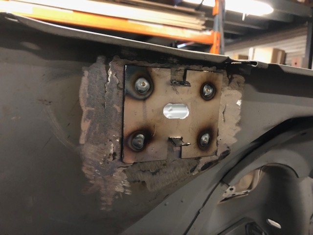

Hood hinge mounts.
I'd never paid this location much attention before, but the reinforcement plate creates a double-skinned area on the inner wing. Naturally this has rusted through.
Plate cut to fit flush in hole
butt welded in and ground off
fabricated new reinforcement plates
finished

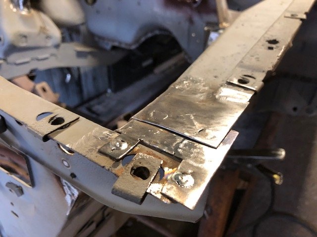

Finishing repairs to bulkhead area. This area was later primed, painted, and the fresh air inlet turrets seam-sealed around their bases.
Outer cowl panel finally welded in place. AMD part, good fit. The front upper edge has ended up about 6mm lower then the previous panel but I'm not too bothered about that. Don't have a wiper motor available to test fit, but am presuming the crank will still clear the bulkhead.

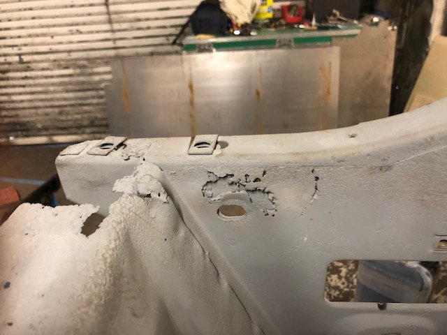

More double-skin rust at front of inner wing. Fortunately the other side was intact so I had something to copy !

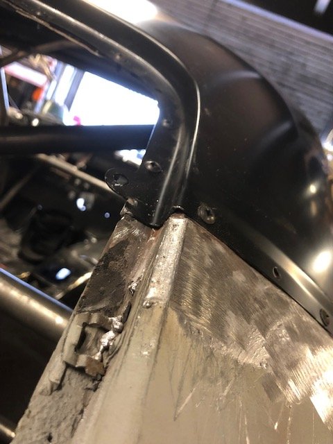

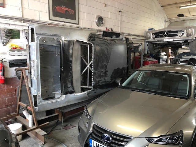

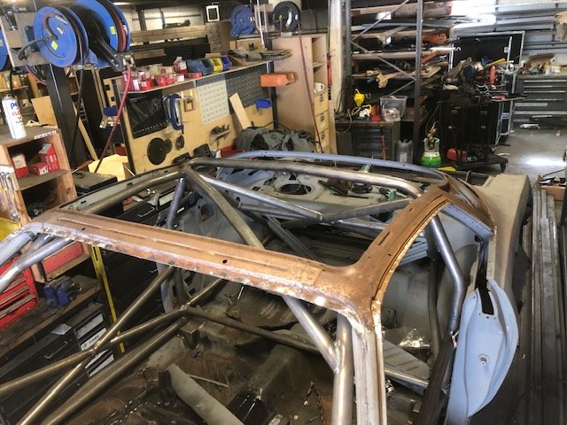

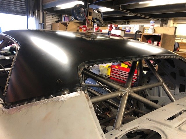

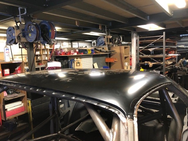

Roof skin off
Roof skin on !
AMD part .
I cannot believe how good the fit is . It is absolutely perfect - everywhere.
One minor point though - the tapering detail around the rear window reveal is not replicated in the roof skin. I'll fix this later on.

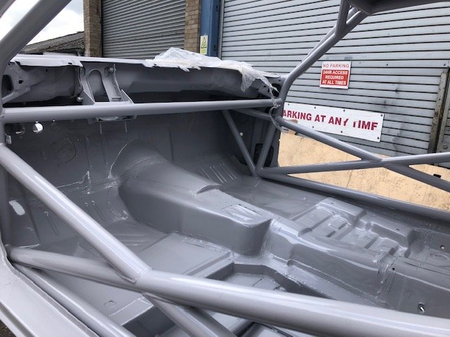

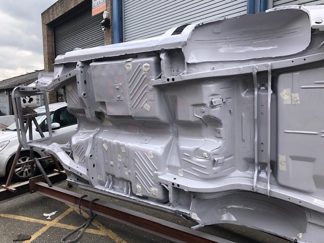

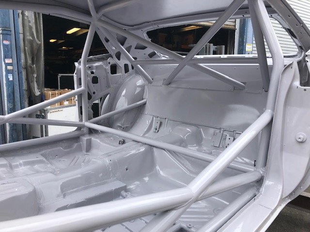

The car went into the painters a couple of weeks ago to have the underside, engine bay, and interior painted. The unit is only four doors down from my Wembley workshop, so just another short trundle for the rotisserie.
I'd previously spent about a day filling imperfections in the underneath of the floorpan, before I realised I was just getting far too anal about it all and had to stop myself doing any more.
Soon after , the first painted bits appeared. Always a boost. This colour is a 70s Alfa Romeo grey (the painter is Italian....)
then the shell
Nice to have something clean to work on at last . The rear quarters still need doing, but that will be the last of the major bodywork,.

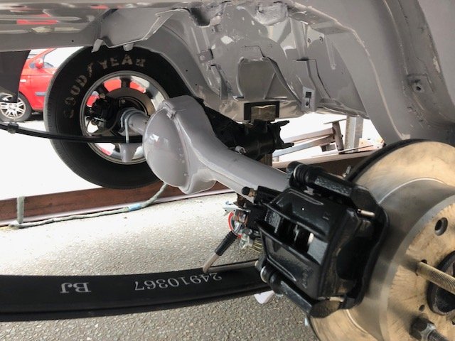

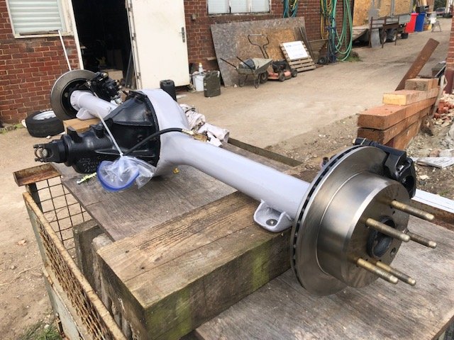

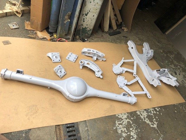

Built up the rear axle last Sunday.
3.23 Sure grip that I've been saving for years. Finally found a home for it !
Stock halfshafts
Dr.Diff 10.7" rear disc conversion. Calipers supplied are from '94-'04 Mustang Cobra, and racing pads are readily available. There is handbrake cable provision on the calipers, but I'm not fitting one for now.
Moroso long studs
now under the car, mounted on Hotchkis lowered leaf springs .
