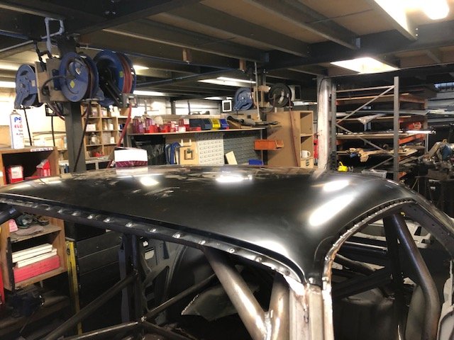

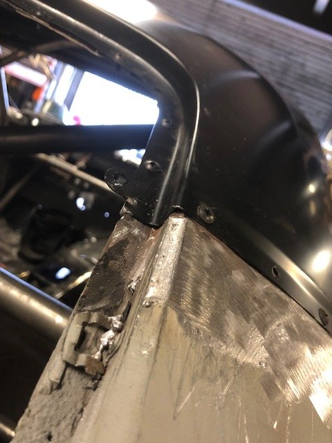

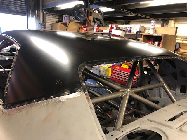

Roof skin off
Roof skin on !
AMD part .
I cannot believe how good the fit is . It is absolutely perfect - everywhere.
One minor point though - the tapering detail around the rear window reveal is not replicated in the roof skin. I'll fix this later on.

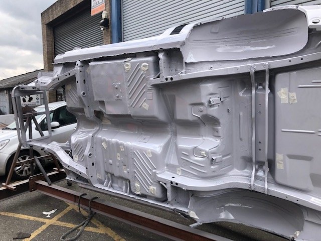

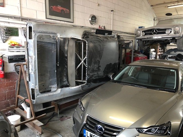

The car went into the painters a couple of weeks ago to have the underside, engine bay, and interior painted. The unit is only four doors down from my Wembley workshop, so just another short trundle for the rotisserie.
I'd previously spent about a day filling imperfections in the underneath of the floorpan, before I realised I was just getting far too anal about it all and had to stop myself doing any more.

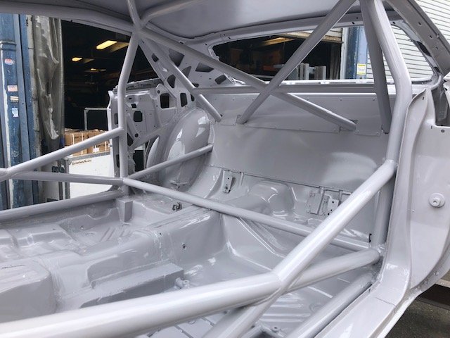

Soon after , the first painted bits appeared. Always a boost. This colour is a 70s Alfa Romeo grey (the painter is Italian....)
then the shell
Nice to have something clean to work on at last . The rear quarters still need doing, but that will be the last of the major bodywork,.

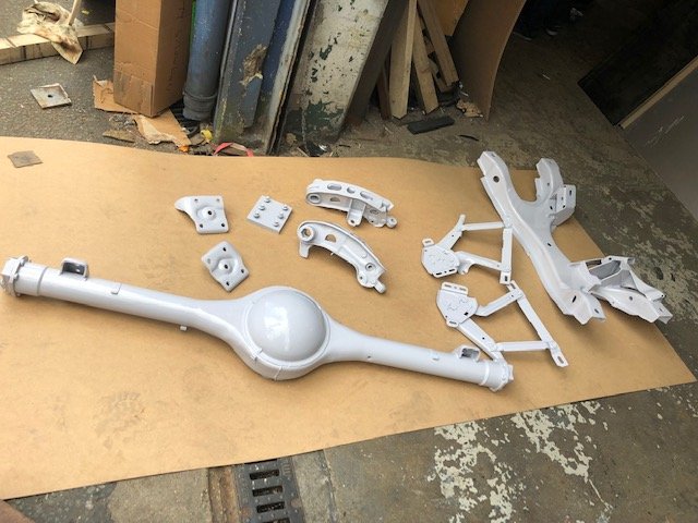

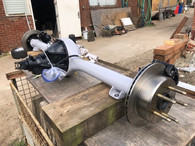

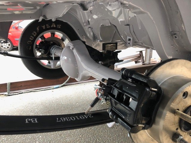

Built up the rear axle last Sunday.
3.23 Sure grip that I've been saving for years. Finally found a home for it !
Stock halfshafts
Dr.Diff 10.7" rear disc conversion. Calipers supplied are from '94-'04 Mustang Cobra, and racing pads are readily available. There is handbrake cable provision on the calipers, but I'm not fitting one for now.
Moroso long studs
now under the car, mounted on Hotchkis lowered leaf springs .
