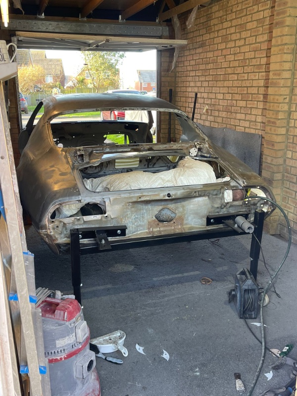

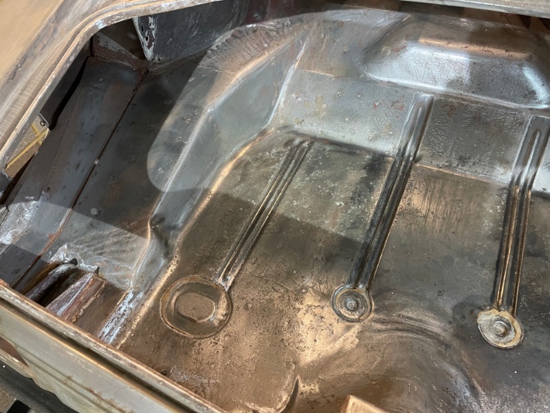

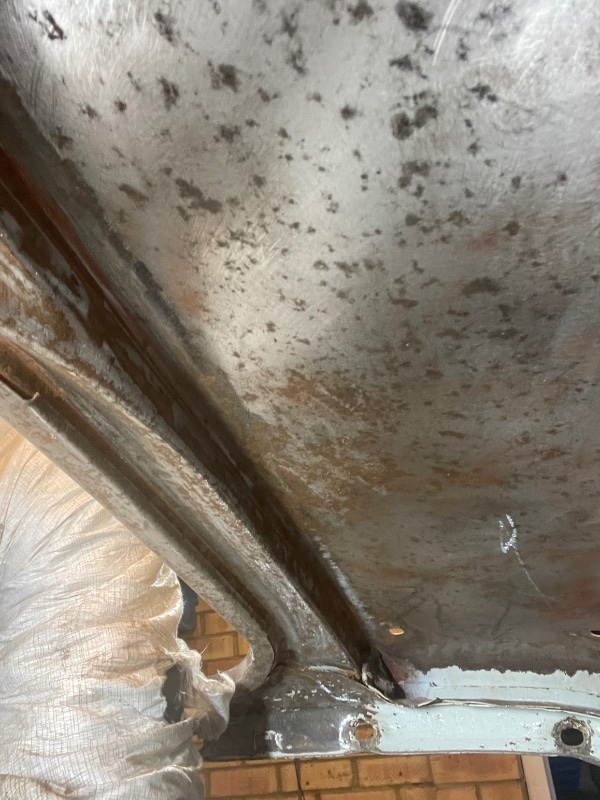

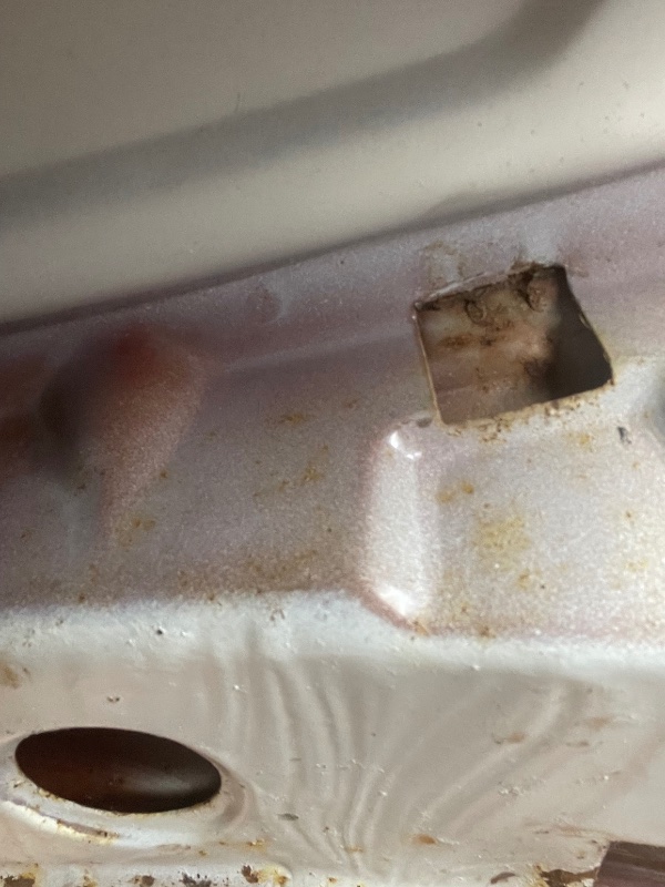

Got most of my mobility back so managed to get a few hours on my Body Shell,
Dark , wet and generally crap weather today so metal cleaning was order of the day
So back in the boot !
Generally very good with some light pitting
Got some pitting around the boot hinge bases which will hole so got some welding repairs to do

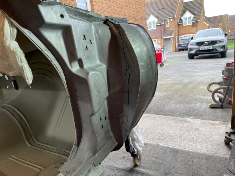

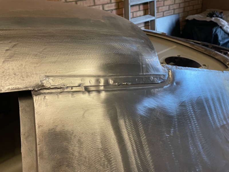

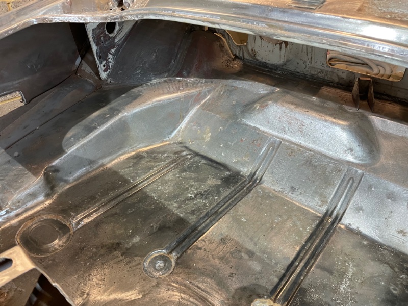

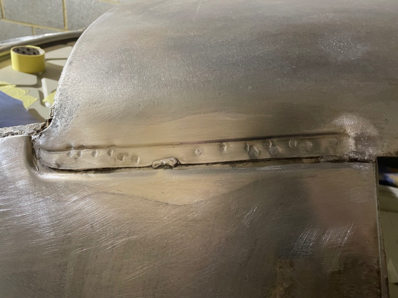

Managed a few hours today, weather was rubbish again so carried on cleaning the boot area,
It’s a horrible job as access is terrible and has to be done through the tiny boot lid opening!
I’ actually have to fold myself up and squeeze into the trunk
Not easy at my age and especially with my damaged limbs !
I also pulled the lead fill from the sail panel all looks good apart from a few tiny Pitts which will have to be dealt with,
Hopefully the other side will be similar,
The lead fill has been in there for 55 years almost
So it pays to pull it and relead it , as one never knows what’s going on beneath!!

The shell really does look good for its age. I don’t envy you crawling & rubbing away in the trunk space.
I’ve only played with lead the one time, I found the trick was knowing when to leave it & try not to get it too good with the paddle & perfect finish with file, etc
Re: My very last restoration!!!
Haha
Yeah it can be a tad tricky!
But once it’s nicely tinned the lead fill generally goes ok,
I’ve still got all my hickory and willow paddles, and a big ol pot of tallow , so I can normally get it fairly evenly spread
Then use the super corse curved buckle plane

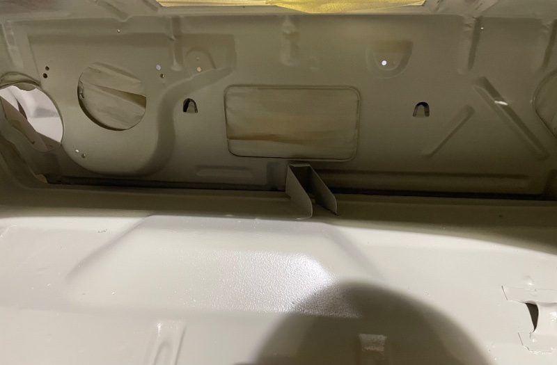

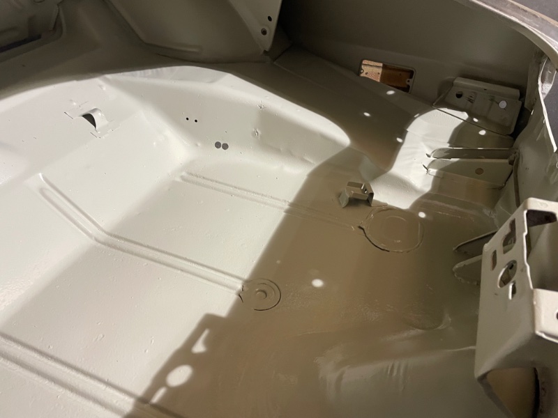

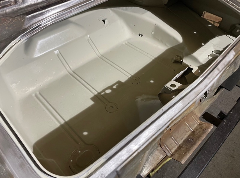

Weather changed completely today so I decided to go for it
Nine hours later my boot floor and rear bulkhead is in Epoxy!
So pleased as this was a complete bitch to do
Also got time to
Pull the lead from the offside , all good except for a rather large hole at the corner of the rear screen flange
Well I say large it’s about the size of my little finger
Must have been like it when the roof and quarter were welded on , so the factory just filled with lead !
Lovely
Also got time to
Lovely

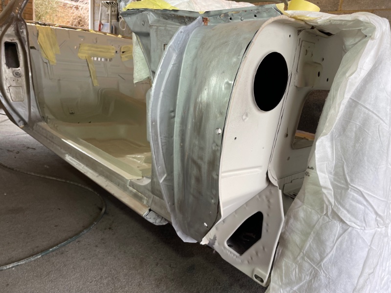

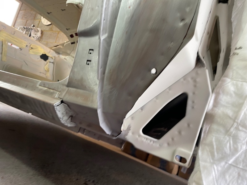

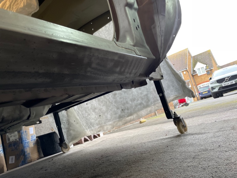

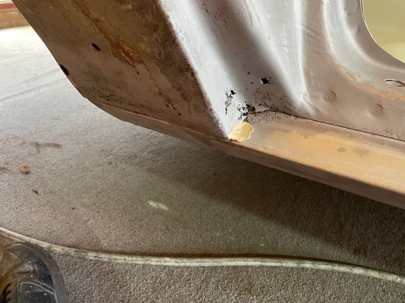

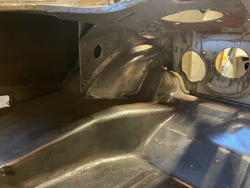

Been busy couple of days ,
Boot area is all fully sealed now thank goodness!
And finally got around to getting the right hand A post and Rocker blasted and now in Epoxy,
Unfortunately I’ve uncovered some corrosion at the rear lower quarter but to be honest not surprising given it location, so I’ve now got to do some actual restoration!!

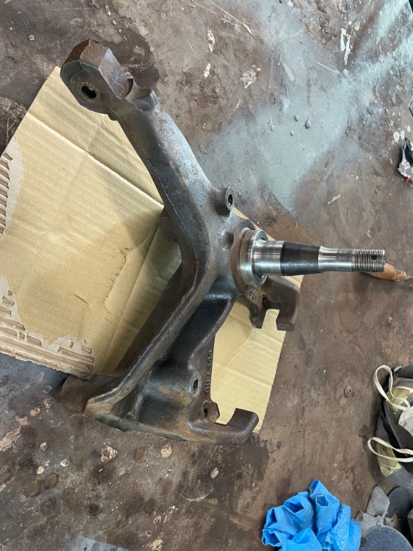

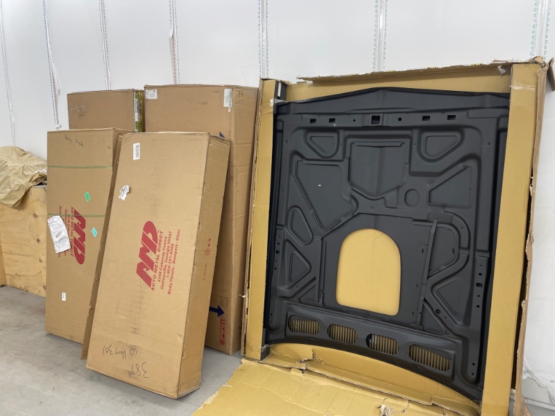

Ron at STS came through and my sheet metal arrived today
Got a couple a small dings but nothing savage

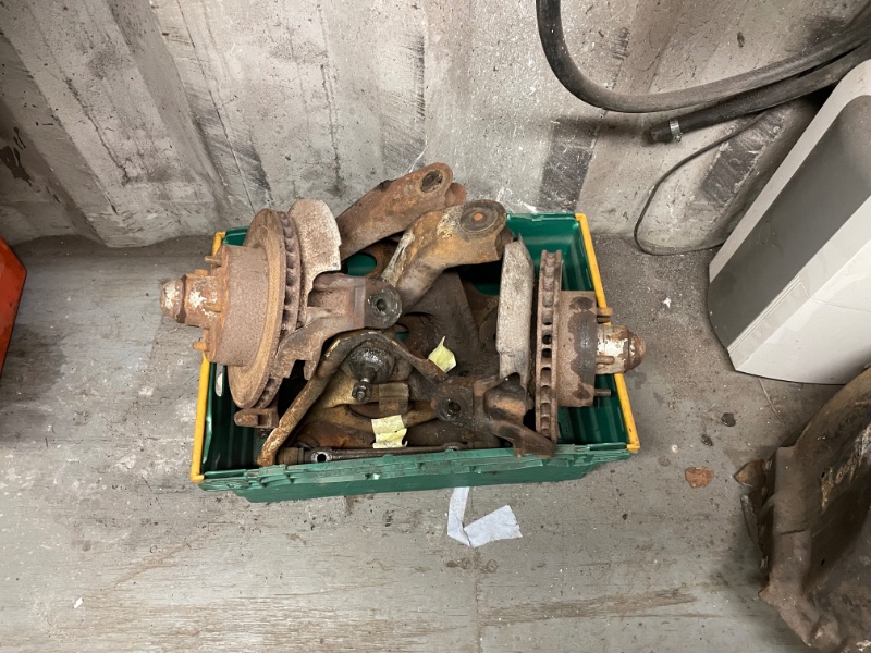

I’ve still been doing some stuff at work,
Strings, brake drums, spindles etc so at least a little bit more done !
Christmas has come very early this year! The AMD hood looks very well made. Thats got to be from an original die?????? Very nice. Ive never used after market sheet metal. When I restored my old 66 Fury, I made all the panels but they were very simple (lower quarters, trunk floor panels, drop offs etc) compared to your parts and a car like this deserves top quality as opposed to home made (impossible with a hood like that).
You are making great progress, loving this thread. Thanks for the updates and photos,
Cheers Steve
