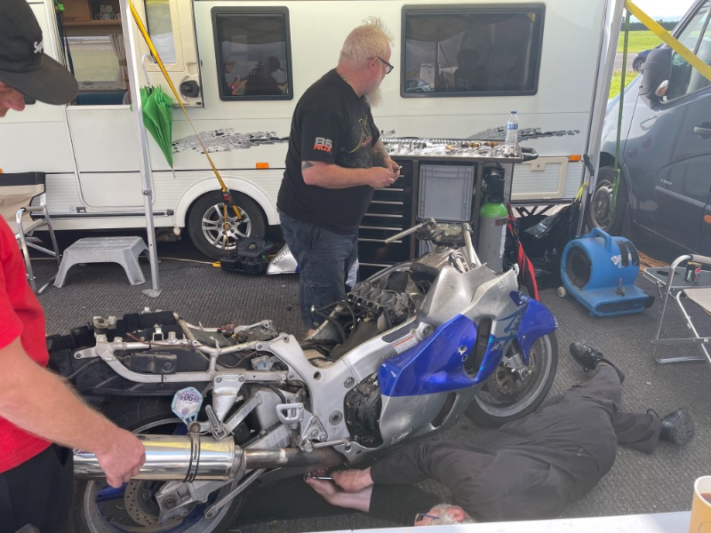

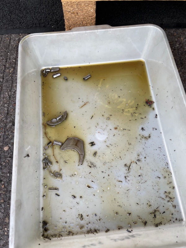

Re: Fifty shades of Jade
Racing this weekend

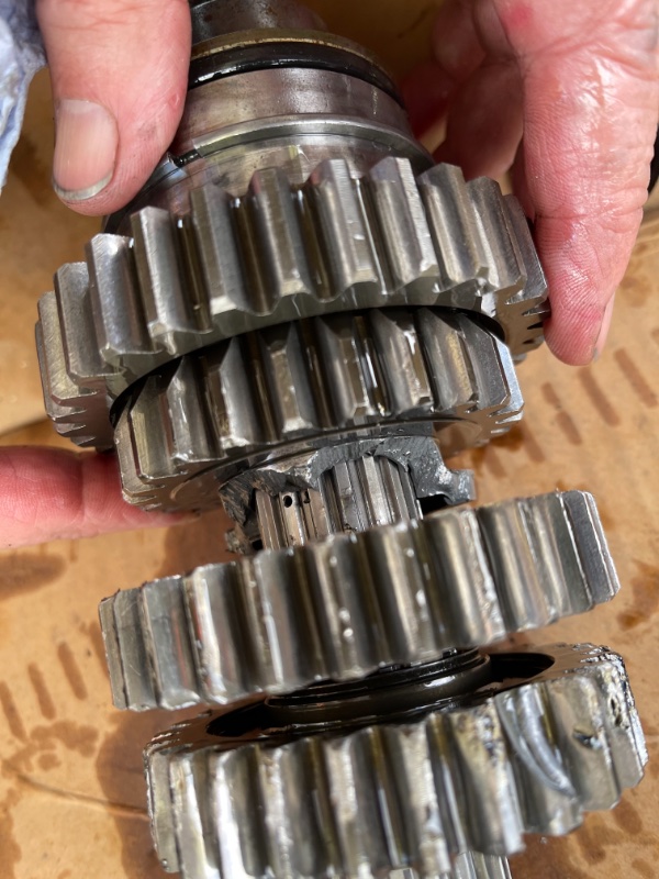

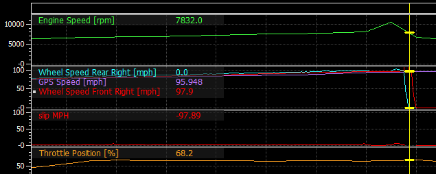

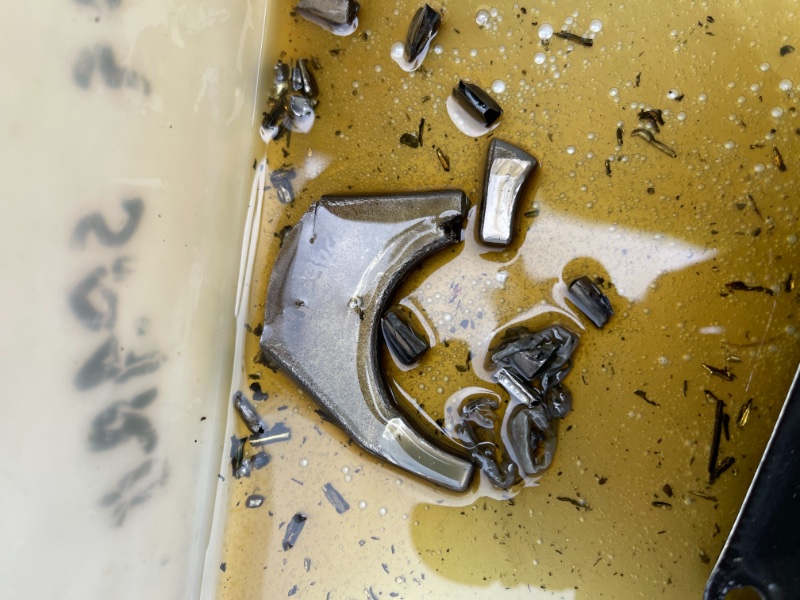

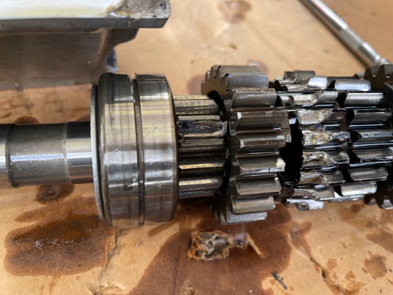

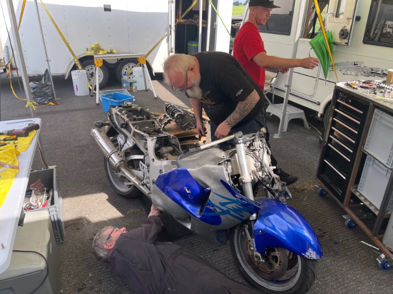

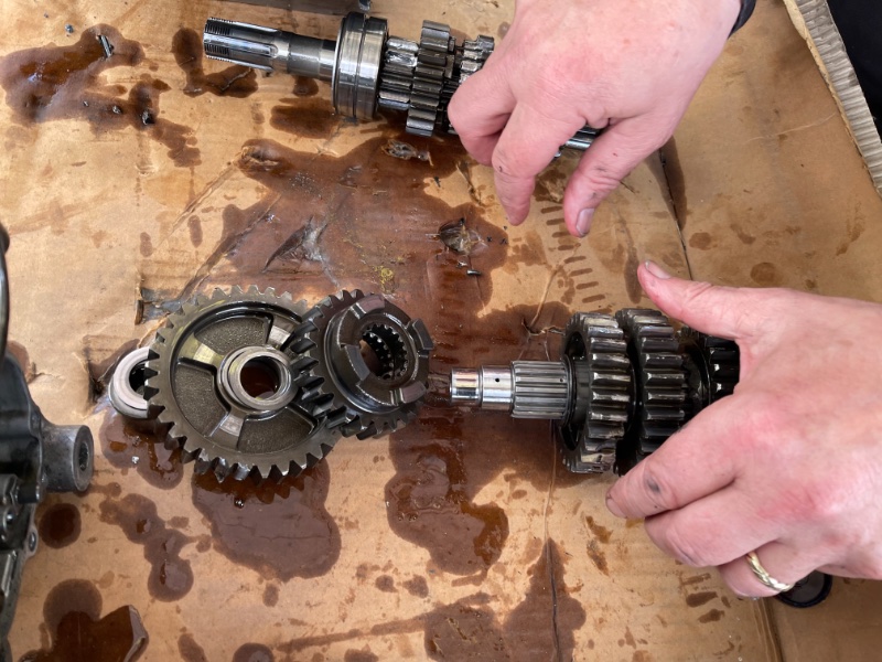

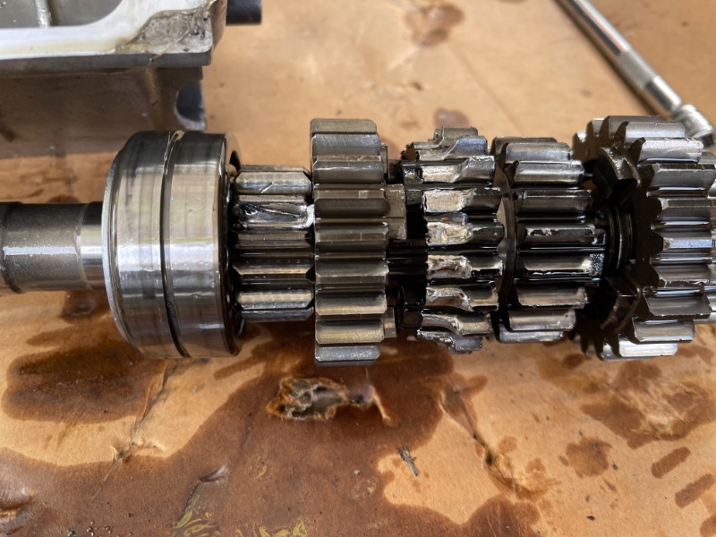

First run of the day developed a electrical issues which allowed the gearbox to select 2nd gear without an electrical cut to unload the gearbox. (6 speed Sequential straight cut)
This allowed the gearbox to select 1st and 2nd at the same time #-o .
The gearbox exploded and this locked the rear wheel completely at 90mph. The bike skidded to a stop and I managed to :thumbright: stayed on it no drama

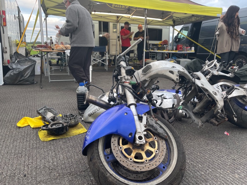

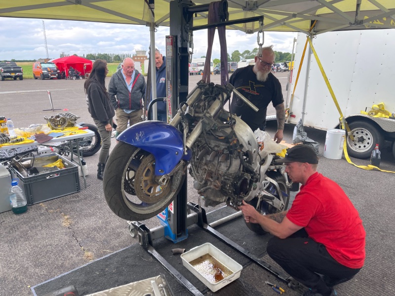

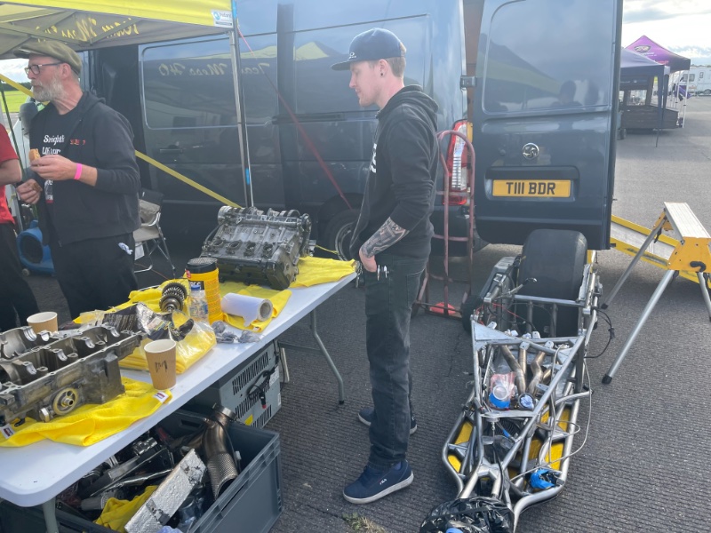

A legend called Micky B walked over and said he had a gearbox in his van.
A walk down the pits and after a dig though his van he pulled out a complete bike :reindeer:
A deal was done and we dragged the crashed bike back to our pit.

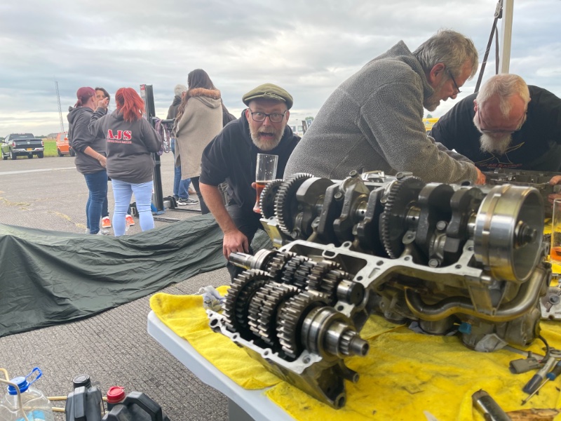

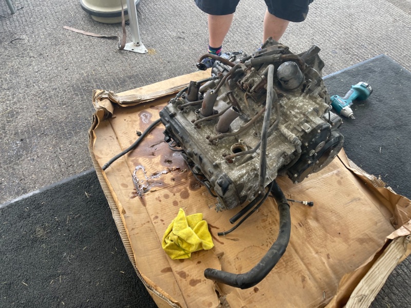

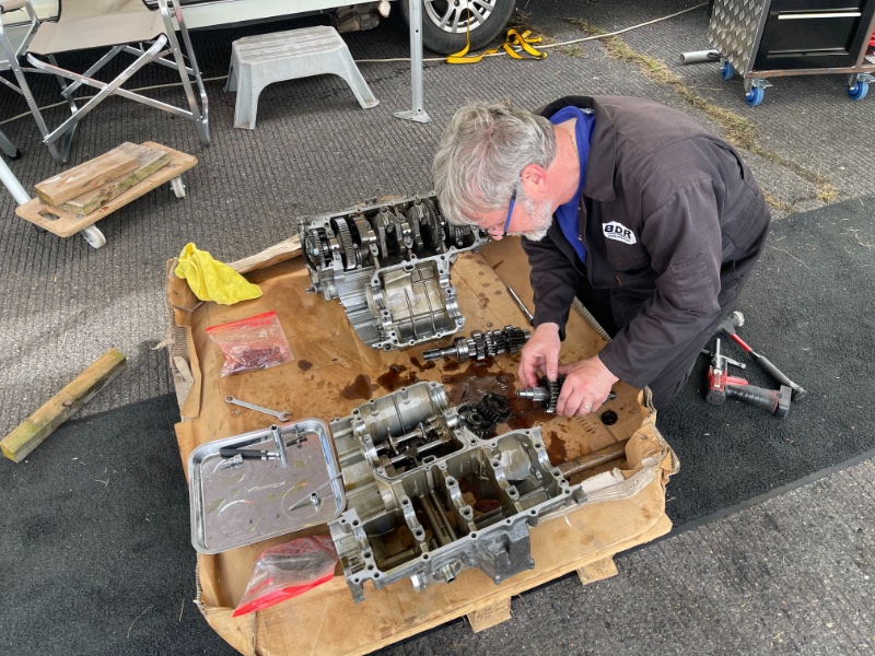

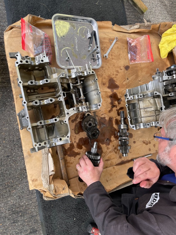

:thumbright: :thumbright:

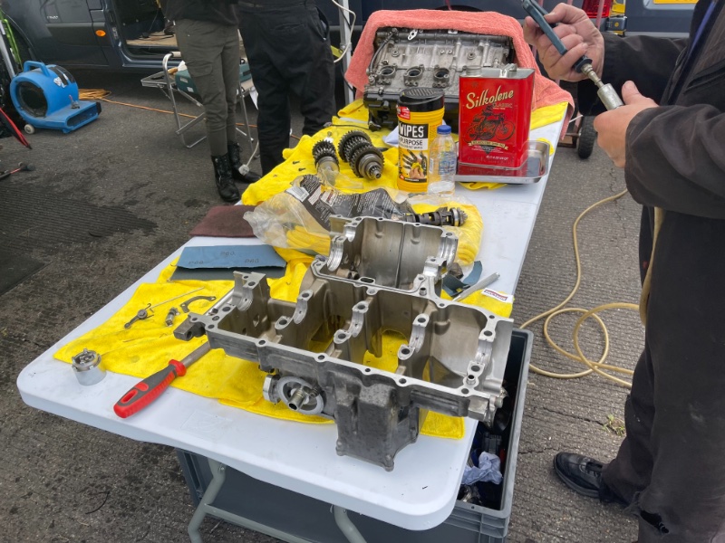

We then pulled out 2 engine from 2 bike and split 2 crank cases
Then from the piles of bits built up a good engine

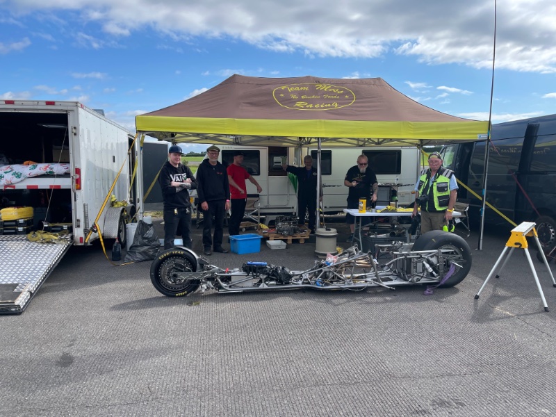

We then went out and ran a 176mph :salute:
Best crew in the business

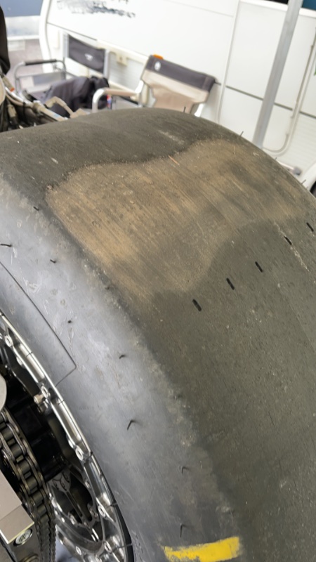

I bet some Poo came out then.... new Slick too I guess?

Pete wrote: Tue Aug 03, 21 8:37 pm I bet some Poo came out then.... new Slick too I guess?

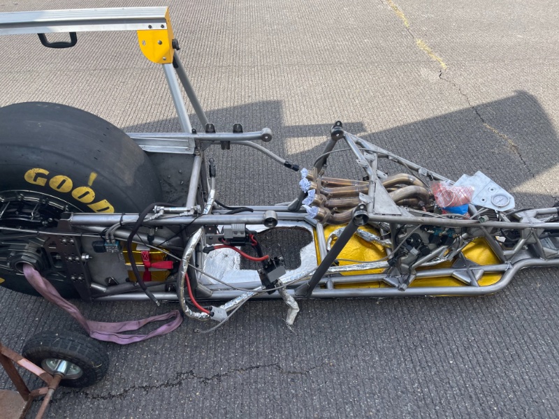

The bike was really stable i think as the centre of gravity is so low.
Tyre seem ok for testing for now
