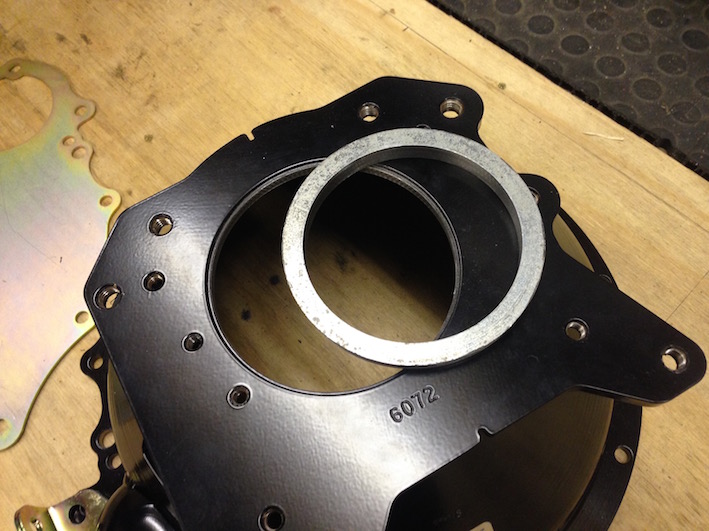

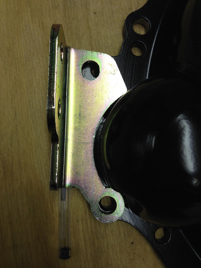

Here's another, Quick time bell housing, the supplied input adaptor needs to be turned down to fit in the housing and the z bar bracket they supply will need considerable grinding before the bolt holes will line up, really no excuse for this. It doesn't have a starter nose support either like the standard housing has so I will have to get one made and weld it in making a mess of the nice powdercoated finish :roll:
And this is before I've even offered it up to the engine or tried the box on it.

Pretty poor job, really; and not cheap either.
Do you think the Clutch Pivot will need bracing?
Remember all the kerfuffle on the SB Sox setup with the Lakewood steel bell housing....
Posts: 14545
It came with a pretty hefty pivot so that should be Ok.

That bell housing set up is really bad - no excuse for that at all - worth taking some pics and sending to them I reckon

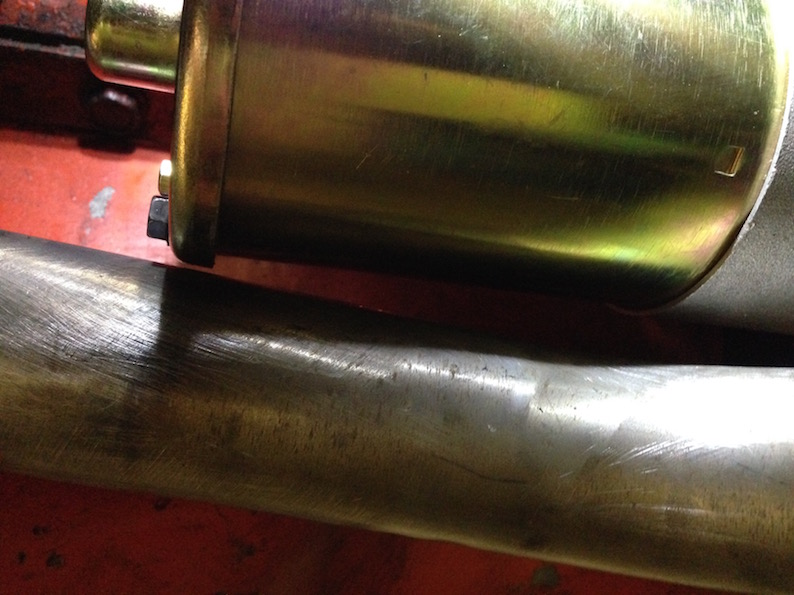

After a good deal of heating and tweaking, the starter actually fits. Not happy with that fag paper clearance, so I'll have another go and see if I can get that one pipe to to move a bit more....

Blow lamp won't get it hot enough, had to use an acetylene torch. Tying to get a tube red hot in 3 places whilst applying pressure to move it is not easy with 2 hands....

Think my TTIs run closer to my headers Blue.
Been ok for some months now,but it worried me initially. I used some insulating shield between the two. In fact I wrapped the starter in it.

Sorry for the thread hi jack blue my fault , have you seen the flexible starter wraps from D.E.i or thermotec ? They work really well when it's really tight on the headers , may mean you don't have to tweak them anymore - they are about £25 or so
Posts: 14545
Nice one Chris, I was going to wrap the starter so I'll have a look at those. I wangled about another 1/8" of clearance today, that will have to do. Started modifying the clutch Z bar today, looks like another pipe will still need to be tweaked to clear that :roll: I'll get the linkage to work with the headers and then fit the new bell housing and mod that to fit the linkage if I have to rather than the other way round.

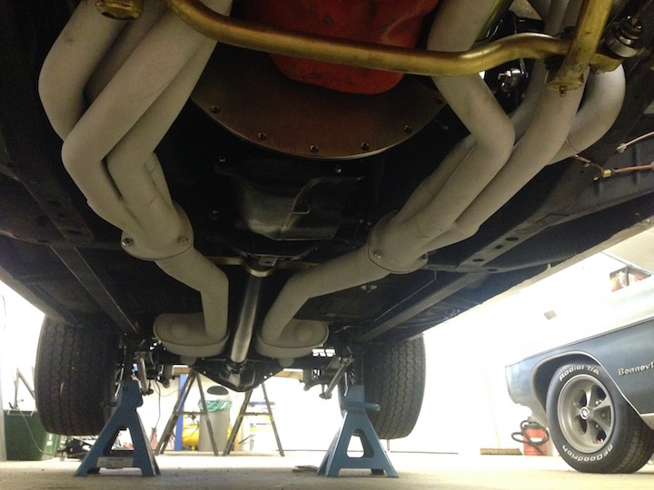

All finished finally! Had the whole system aluminium sprayed to keep corrosion at bay. Need to start hassling Dale for my doors now, that will be the next big job.
