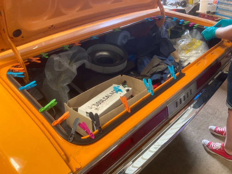

In the meantime, my good lady has been doing a cracking job of the boot seal for me.

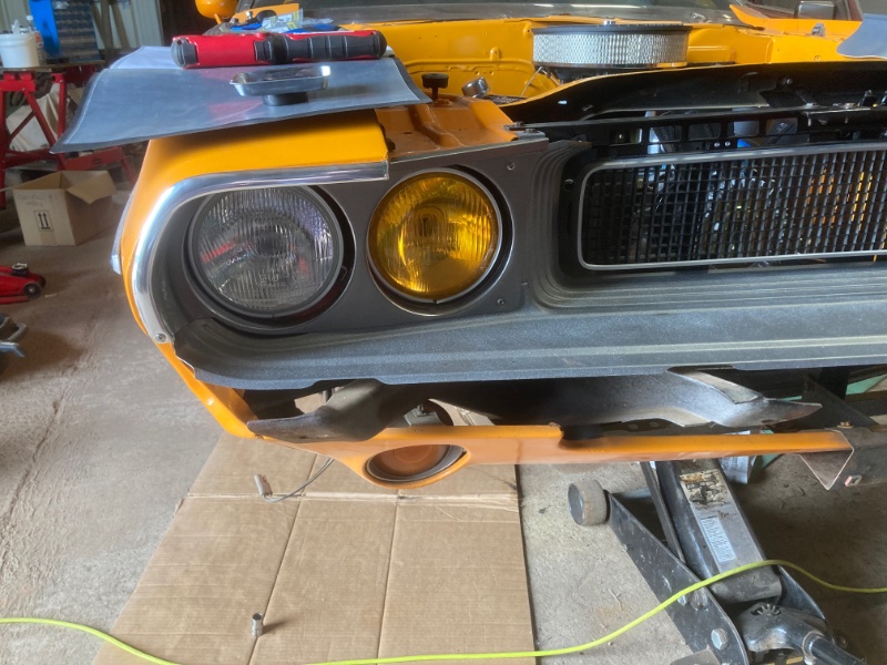

First go at tinting the inner beams. Not an easy job, but reasonably happy for the first attempt. Will have a few more practice goes before I do the final install, but I really like the look.

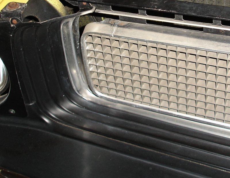

Don't want to be picky but you should have left the leading edge of the grille and the area around the mesh unpainted. Unless it's damaged?
