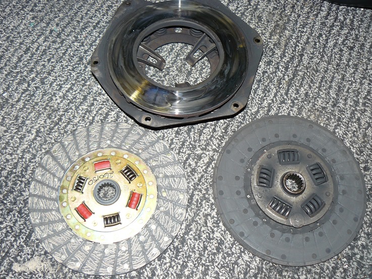

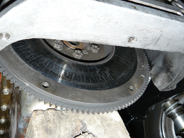

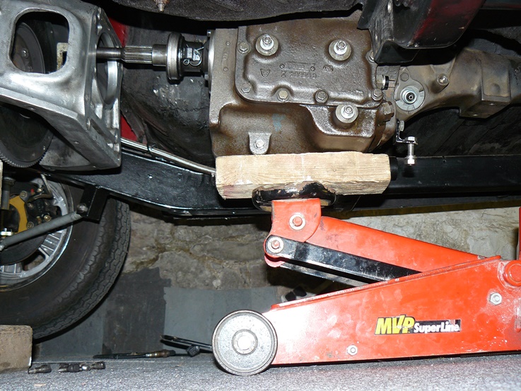

NEW CLUTCH ARRIVED! Gearbox out and clutch off last night.
The old clutch and the flywheel are already showing signs of abuse.. Santa Pod may well destroy them :shock: :D
Clutch plates 03.jpg (232.48 KiB) Viewed 1675 times
Flywheel 02.jpg (206.1 KiB) Viewed 1675 times
Gearbox pulled back 01.jpg (214.05 KiB) Viewed 1675 times

Just for shxxts and giggles, why not fit an auto with all the right internals. Give your left leg a rest :drwho:
I'll get me coat, I know how much you've suffered with setting that gearbox/clutch up :thumbright:
Posts: 22242
That flywheel looks kippered to me, but I am sure you are going to re-use it ;)
Welcome to the world of swore-speed transmissions.............
Posts: 14642
The flywheel is fine, rough it up with some emery and git 'er done. I'd be more worried about that aloominum bellhousing if anything did let go, do you like your feet?
correct direction
Post by correct direction »
Four speeds are great if you use a good quality clutch,used a centre force diaphram cover on my Satellite never missed a gear,even in anger.plus not as heavy as the spring type units.
