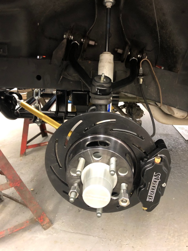

Dave999 wrote: Thu Mar 31, 22 10:16 am that looks a bit rubbish for something i am guessing it wasn't cheap.. did they miss something out? should the nut have been there?
Wasn’t room for a nut Dave, I had to grind clearance for that. It was just another bit of plate tacked on to double the thickness which would have been fine if it didn’t need torquing to 100 ftlbs…

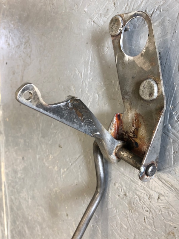

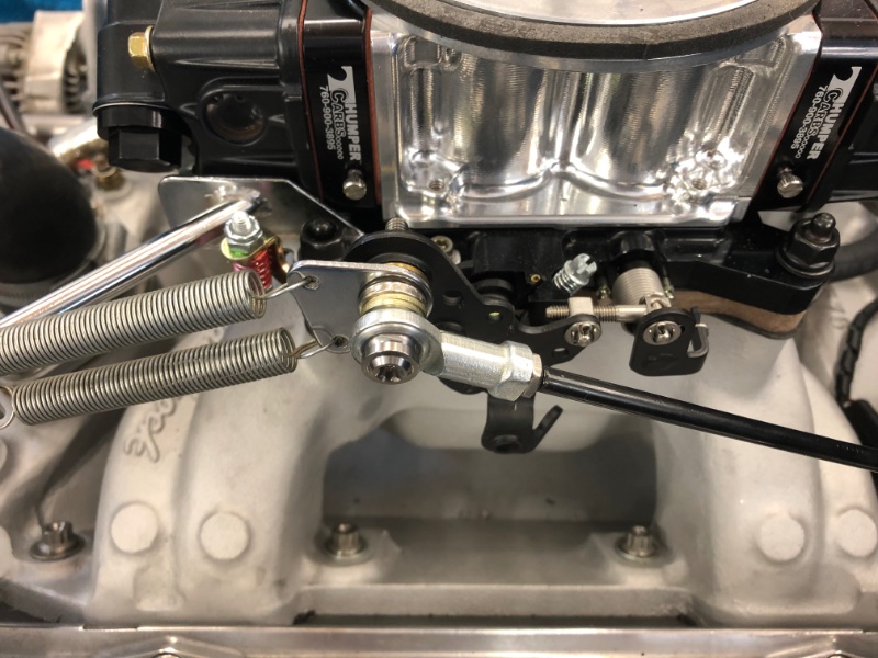

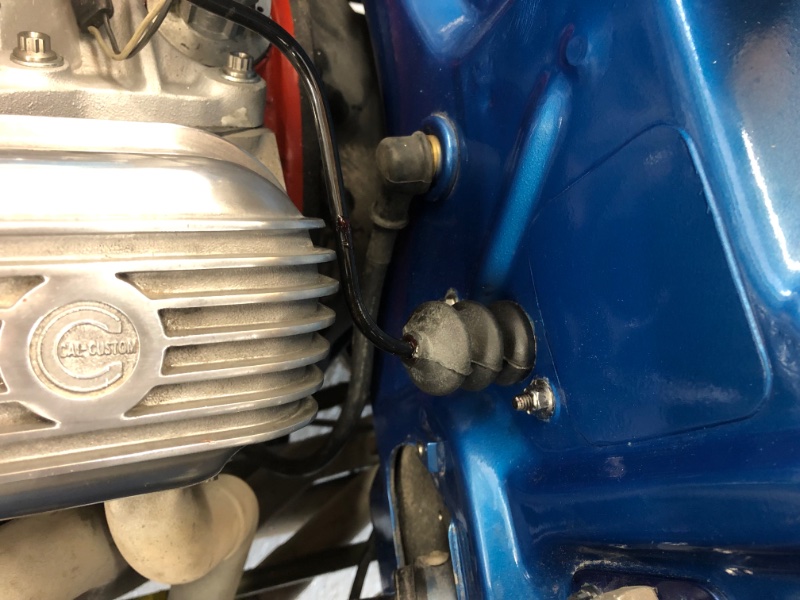

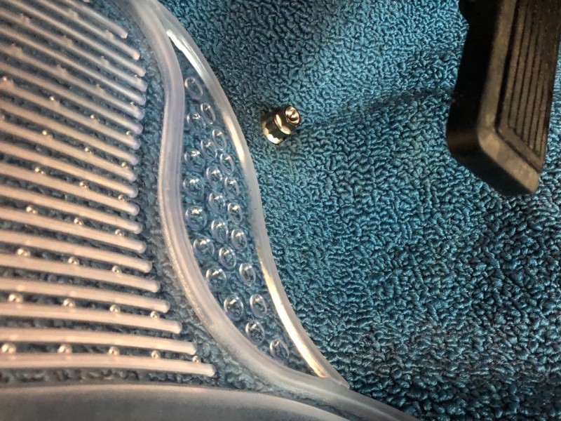

Not keen on throttle cables, I much prefer the lightness and direct action of a rod, especially for racing. Pedal needed a bit adding to take a clevis, and a bit of threaded tube welding into the floor for an adjustable pedal stop. You need one of these with this kind of set up to avoid bending or straining anything with your heavy footedness. Bit of rod bent to suit and a rod end and jobs a sausage. A boot from a Girling slave cylinder does the trick on the firewall.
