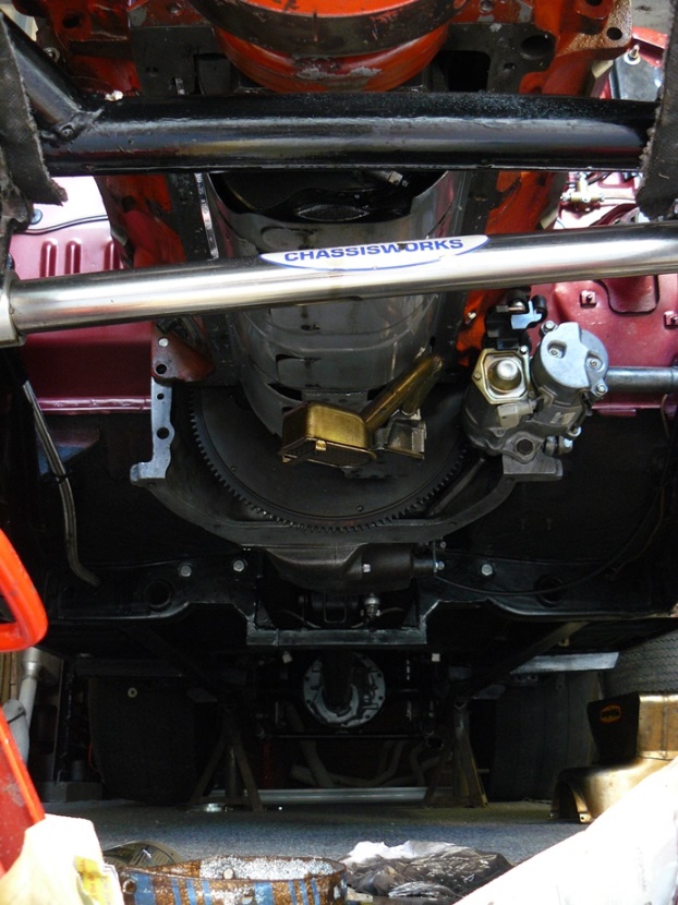

Thanks Blue, I was slightly concerned for about a minute, but as Pete will have guessed I've already bolted it all together :thumbright:
I Scotchbrited the faces and thoroughly de-greased and cleaned everything.
I had to drill and tap one bellhousing bolt-hole 1/2" deeper as the threads were knackered.
I took the reverse light switch out to replace the fibre washer and realised it was also leaking THROUGH the switch- I cleaned out the recesses around the connector blades and filled em with araldite.
New fluid in and the clutch & gearbox are done :thumbright:
While the car's up I figured I'd do the oil and filter too. As it's also leaking slightly I dropped the sump. An easy job on my car- just loosen the steering rack and drop one end and off comes the pan :D
Nothing nasty in there so I gave it a good clean and flattened the flanges a bit. The end seals are split so I couldn't just re-fit it and I left it too late to order gaskets for tomorrow so the car will be laid up til Monday now :( A frustrating waste of 3 days potential tuning-time :x
Sump taken off.jpg (191.82 KiB) Viewed 1480 times

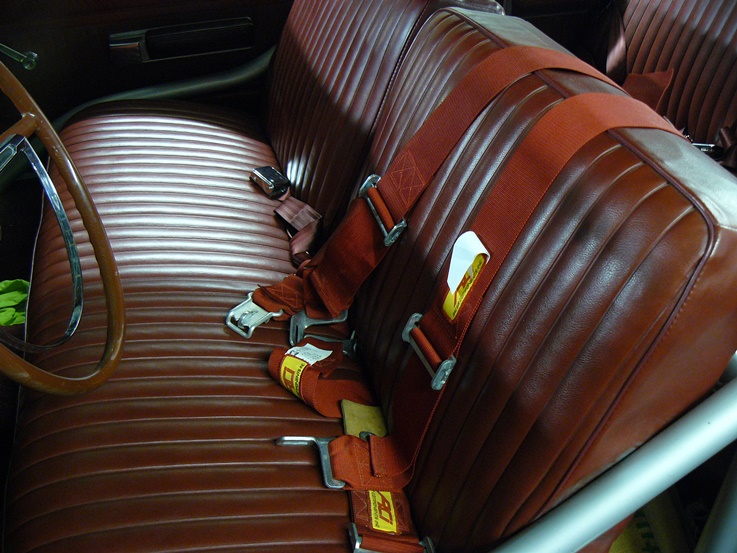

Full harness is in, including the removable centre bar.

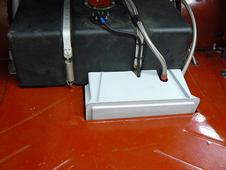

I made a box to protect the fuel pump etc from all the crap I'll be taking to the Pod... and stuck on me race numbers :D
5 pt harness.jpg (183.38 KiB) Viewed 1762 times
Fuel pump boxed in.jpg (170.06 KiB) Viewed 1762 times

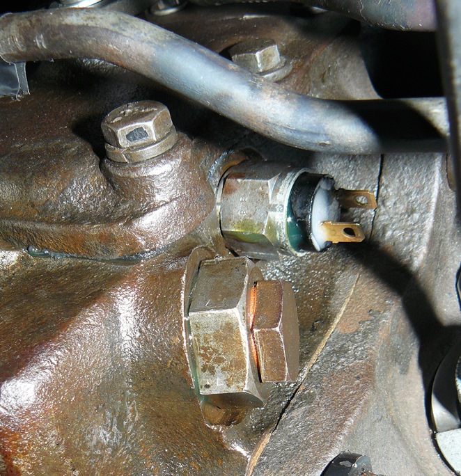

Just putting the exhausts back on this morning and the bloody reverse switch is leaking AGAIN!! :banghead:
Anyone got a spare?
Rev switch.jpg (228.51 KiB) Viewed 1744 times

Switch innards ripped out & filled with Araldite.
Fluid back in.
