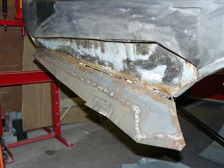

I've started cutting out the crap repairs done last year. Far worse than I thought!
I'm so glad he didn't do more damage, no wonder he can't find work anywhere!
I need to replace at least part of the trunk extensions but I've not found anywhere that does repro pieces. I'll have to make my own ;)

WOW that was done last year? jeeze it is stuff like this , you might as well do it all your self , that has always been the issue , have some else do it and cover up the crap work,
or do it your self so you know it is done correctly :read2: and it takes twice as long to fix something that was done wrong ,rather than doing it right the first time

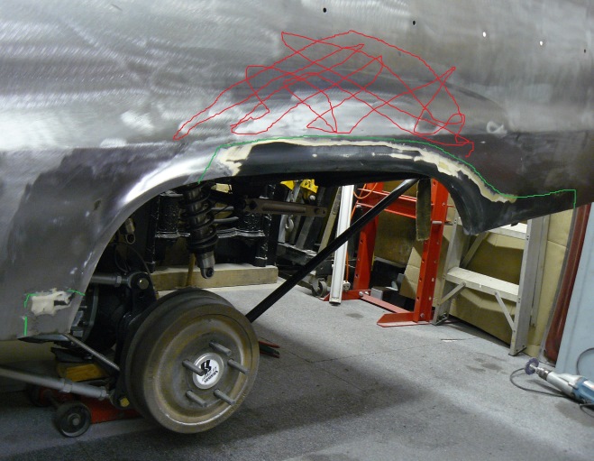

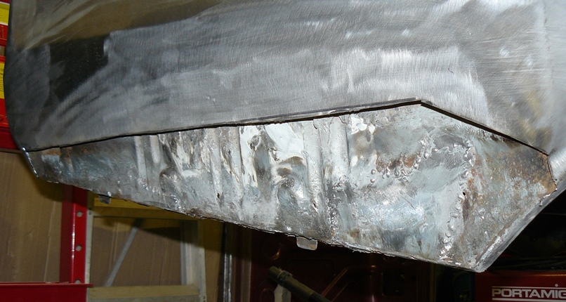

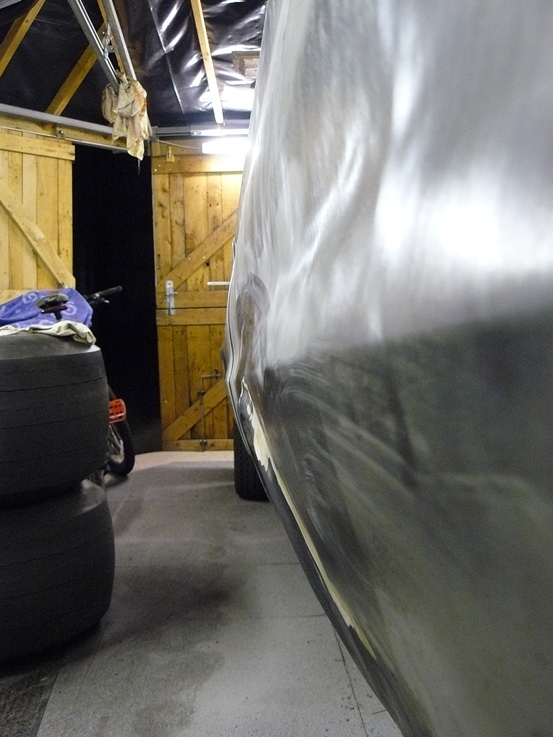

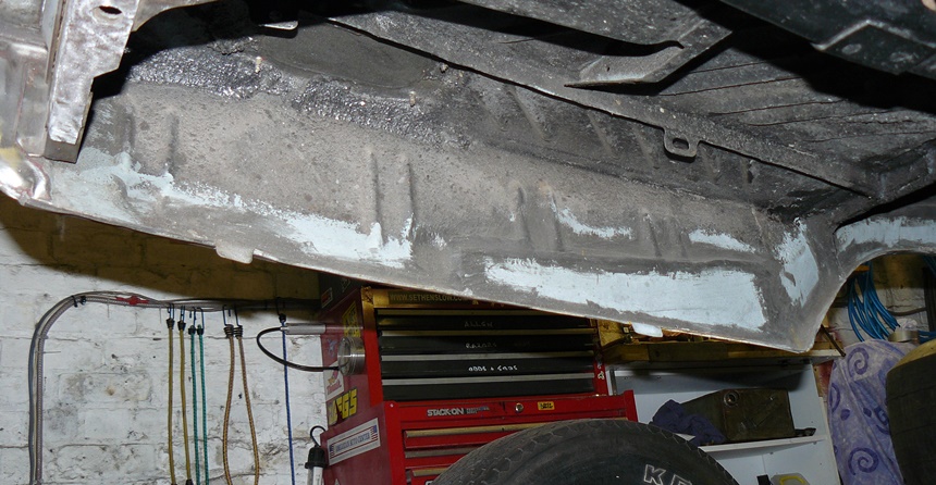

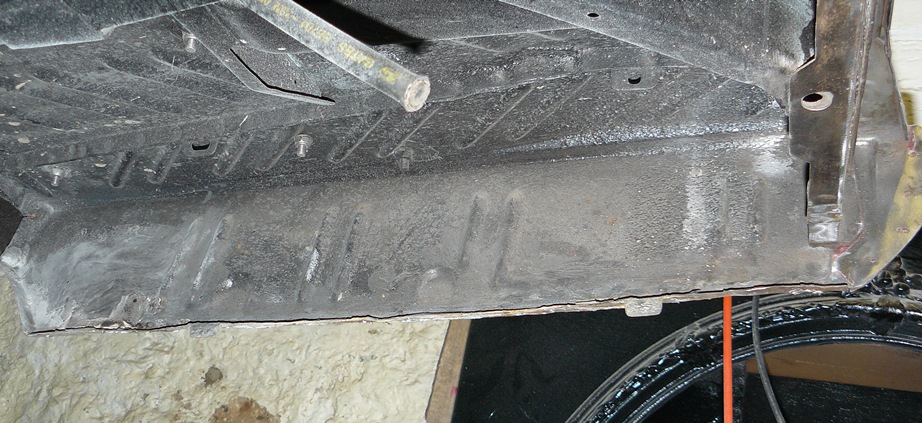

A busy day today but I managed to fit in some car time ;)
I've virtually stripped the last of the paint and filler off now, the sills (rocker panels?) like the rest of the sheet metal, are in great shape.
I'll probably paint into the door shuts but I'll just flat the paint there rather than strip to bare metal.
In the shot of the wheel arch I've marked edge of the old patches in green and the area distorted by overheating the steel in red :evil:
You can sort of see the dip in the bodyline in the last pic.

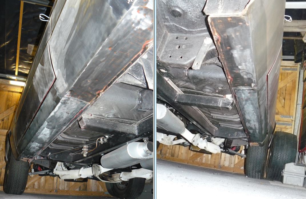

I've been there Paul made all the repair panels on the Fury myself,couldn't
Buy any so had no choice.Its quiet satisfying making them if a bit time
Consuming.With all the other stuff you've achieved I'm sure it will turn
Out good :thumbright:

I've started on my welding at last :thumbright: pics to follow.

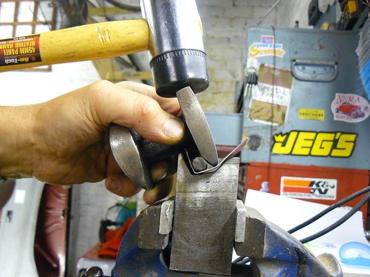

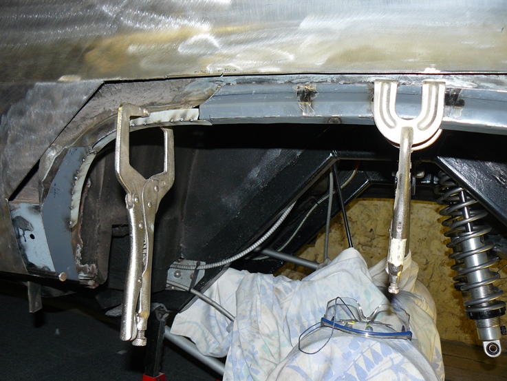

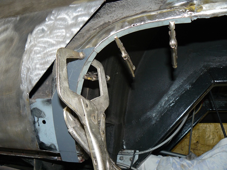

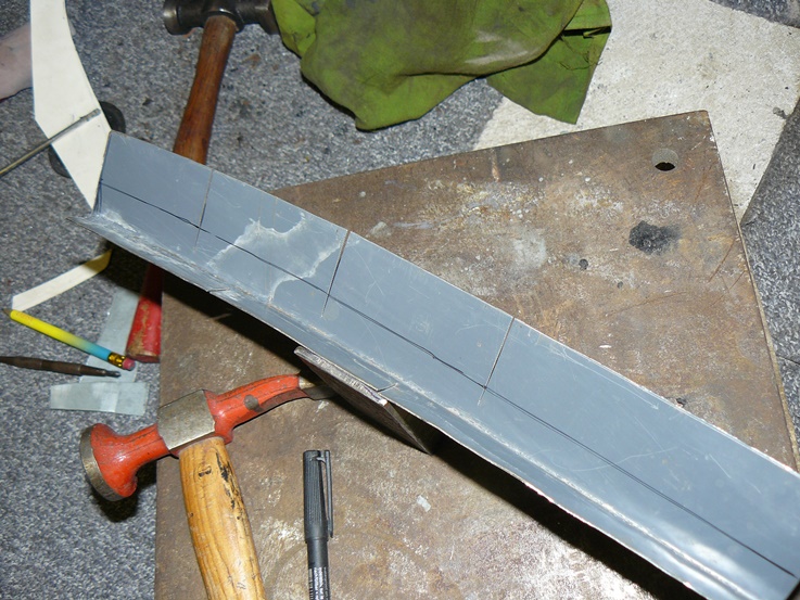

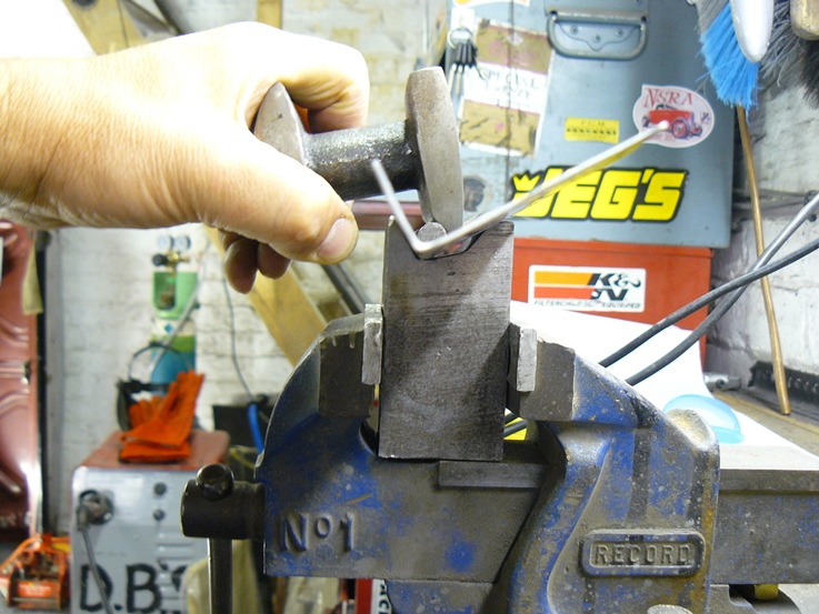

I've started repairing the inner panel, driver side arch.
I'm making all the pieces ready, but I wont weld them in until the outer panel is welded on- then I can get the outer perfect and adjust the inner pieces to fit.
I had a practice with my home-made dolly to form the mid-section inner repair section, it worked like a dream!
I'm happy now that I should be able to improve the crappy Sherman outer panel! :thumbright:
04 Driver side arch, middle bit shaping up.jpg (194.76 KiB) Viewed 1427 times
03 Driver side arch, middle bit on dolly.jpg (197.97 KiB) Viewed 1427 times
02 Driver side arch, middle bit.jpg (213.93 KiB) Viewed 1427 times
01 Driver side arch, front bit started.jpg (185.57 KiB) Viewed 1427 times
Posts: 8369
And the bits in place!
05 Driver side arch, middle bit test fit.jpg (206.34 KiB) Viewed 1426 times
