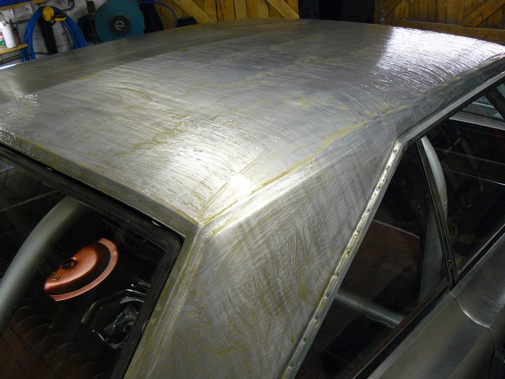

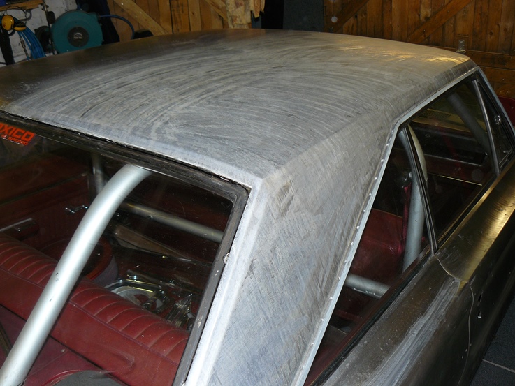

Diverted off the repairs for a day and started on the rust-killing.
I hit half the roof with De-ox for an hour or so, then drenched it in Por 15 for another hour. This thing ain't gonna rust for about 150 years :P
Roof 02.jpg (185.4 KiB) Viewed 1443 times
Roof 01.jpg (171.31 KiB) Viewed 1443 times

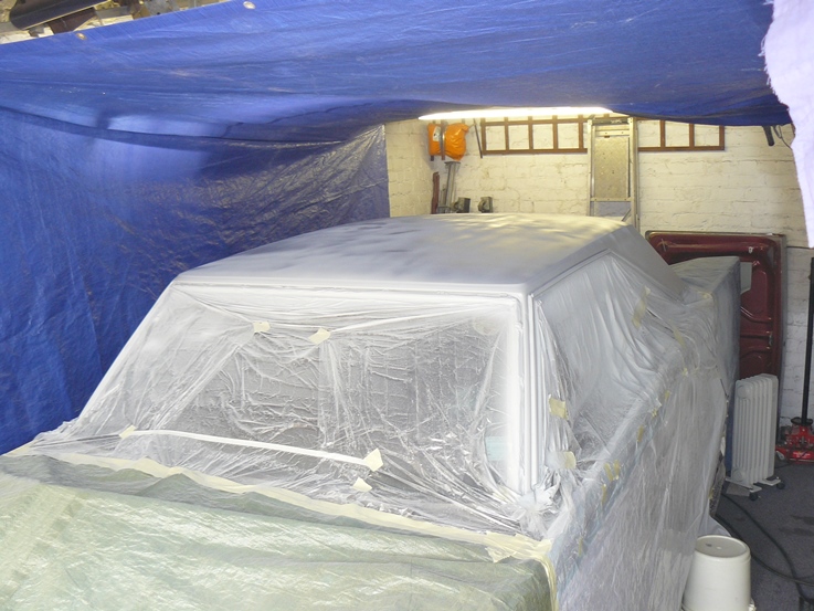

Posts: 8369
Roof primered!
Belve roof primered.jpg (204.27 KiB) Viewed 1638 times

Nice one Paul.
Cool spray booth :thumbright:

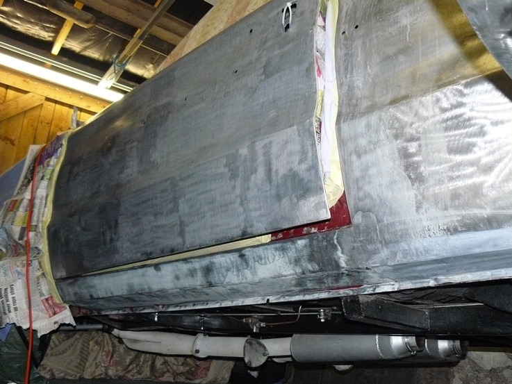

Posts: 8369
Proud of my little repair to the passenger door and fender :D
Pass door and fender leaded 4.jpg (191.85 KiB) Viewed 1577 times
Pass door and fender patches welded 3.jpg (176.85 KiB) Viewed 1577 times
Pass door and fender patches ready 2.jpg (170.87 KiB) Viewed 1577 times
Pass door and fender cut out 1.jpg (180.71 KiB) Viewed 1577 times

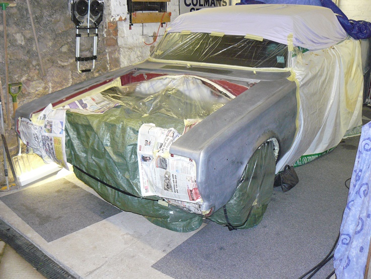

Posts: 8369
Front end now prepped and ready for primer
Front end ready for primer 5.jpg (212.14 KiB) Viewed 1576 times

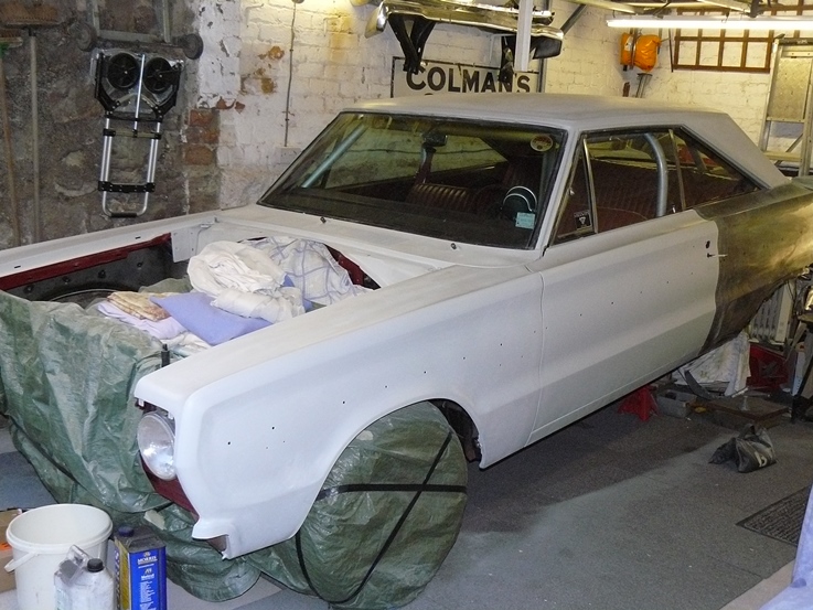

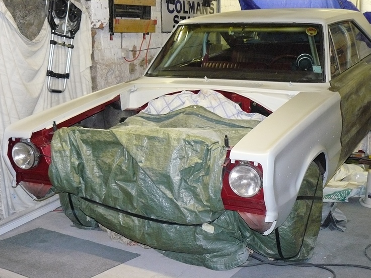

Posts: 8369
Front end primered.
4 coats on and it's come out a lot smoother than the roof!! Practice makes perf... well, slightly better :thumbright:
Lots of suicide bugs though :?
Front end primered.jpg (240.03 KiB) Viewed 1521 times

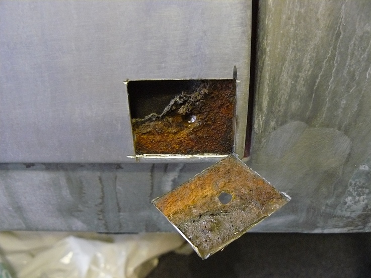

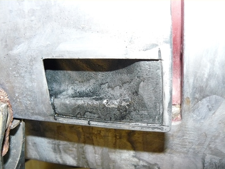

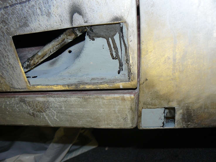

Posts: 8369

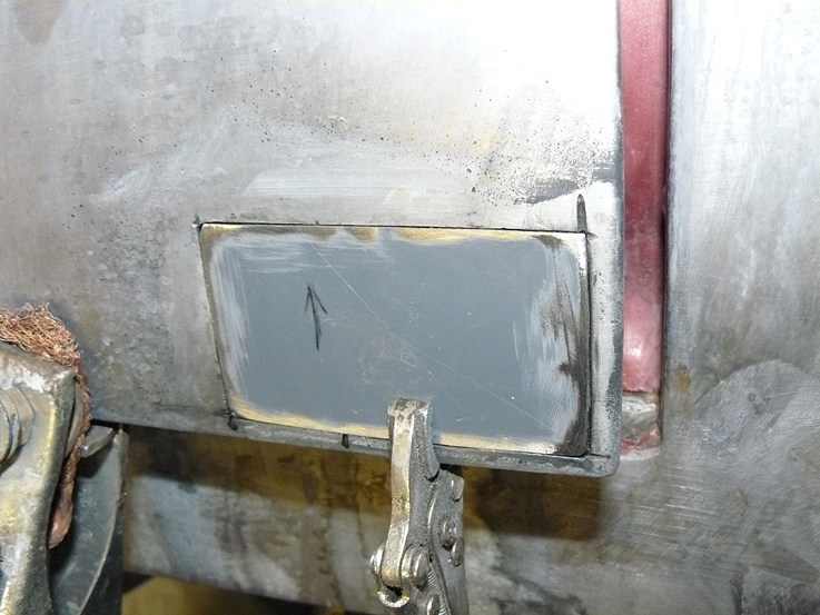

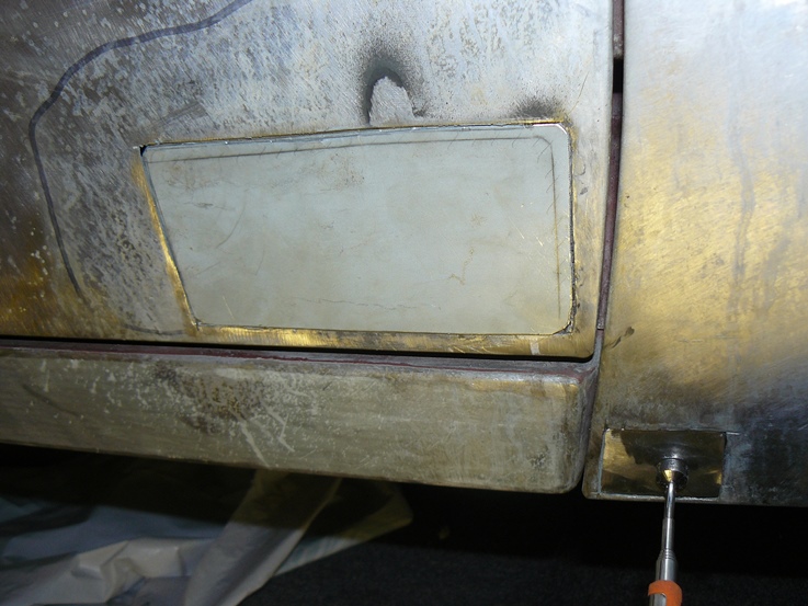

Been tackling the drivers door the last couple of days. I poked at a pinhole in the bottom rear corner and a hole opened up! Good thing I'm poking my Dremel into ever speck of rust on the whole car!!
Driver door patch made.jpg (198.74 KiB) Viewed 1489 times
Driver door rust gone.jpg (200.48 KiB) Viewed 1489 times
Driver door cut out.jpg (187.68 KiB) Viewed 1489 times

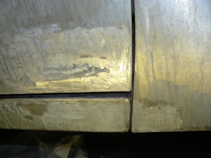

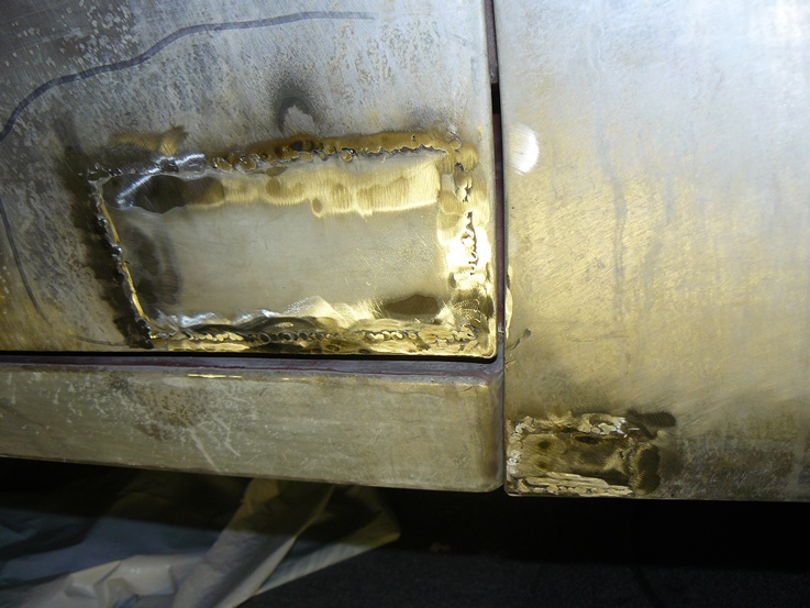

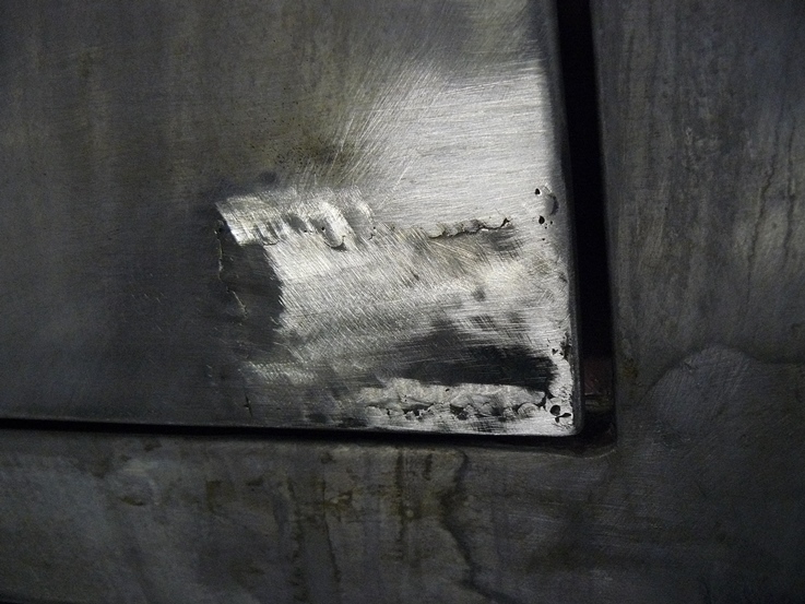

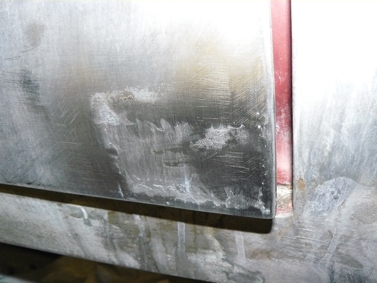

Posts: 8369
I'd masked it ready to primer then decided to hit the sill at the same time.
My patch-making, welding & leading are definitely improving, this is all good practice for the rear arches :thumbright:
Driver door & sill zinced and ready for primer.jpg (227.55 KiB) Viewed 1484 times
Driver door leaded.jpg (194.81 KiB) Viewed 1484 times
Driver door welded.jpg (208.79 KiB) Viewed 1484 times
