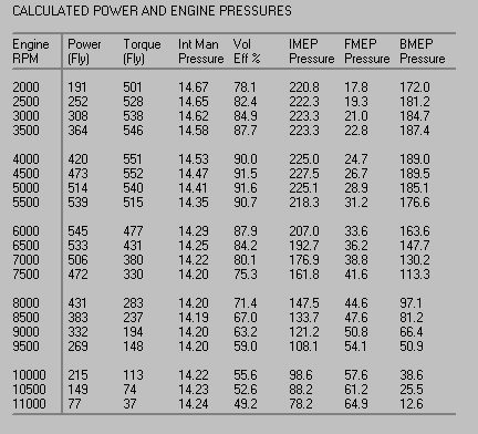

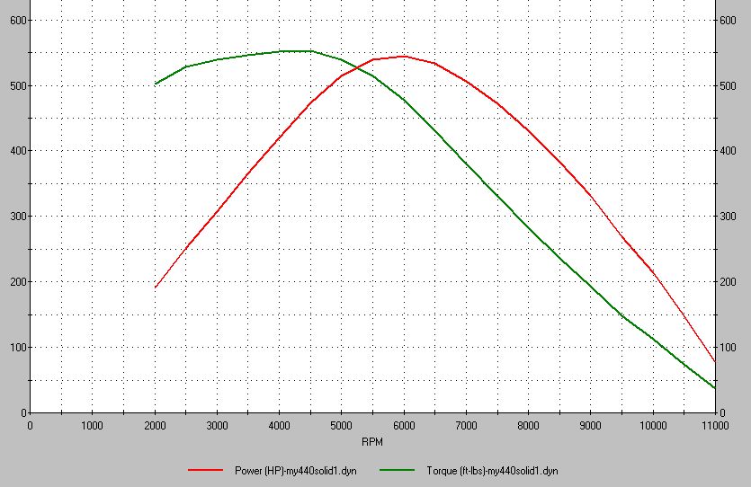

Managed to find some flow data for my ported iron 906 heads the other day. I forgot I had it.
It was only three points.
0.500 --- 258/201
0.550 --- 262/204
0.600 --- 258/208
I have 0.570 lift intake and 0.579 lift exhaust.
I think these figures were at 28" H2O.
But I found more complete data on other similar heads so was able to plot a graph and get a good idea what flow is probably going to be at smaller lifts.
This meant I could create a head flow file for desktop dyno and get a more accurate graph from that. The result falls nicely into line with what I had been expecting. Which is nice. The combo now should (in theory and if everything works 100% for a change) run 11.80 @ 115mph.
But I will settle for 11.anything at the Nats this year. Even a 12 would be better than last year.
0.500 --- 258/201
0.550 --- 262/204
0.600 --- 258/208
