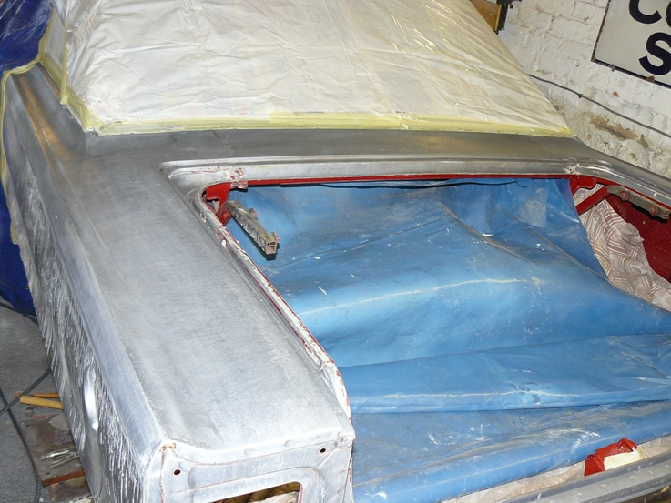

The trunk has been a right pain to prep!
Hundreds of tiny pockets of rust all around the edges and on the flange. I Dremmeled it for hours, then DE-OXed for ages. Cleaned that off and hit it with good old POR15 for a couple of hours. While it was soaking I did loads more Dremmelling of the bits I'd missed.
The whole thing is now rust-free and zinc-coloured :)
Trunk derusted.jpg (207.03 KiB) Viewed 2218 times

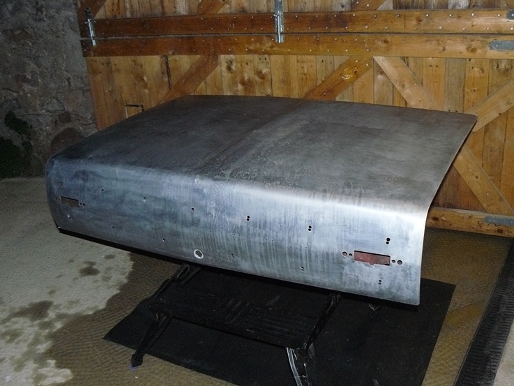

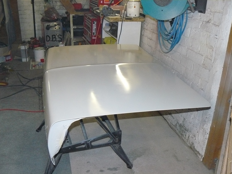

Posts: 8369

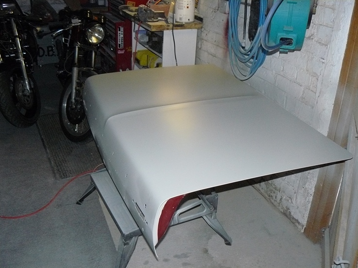

Trunk lid primered today :D
I've done lots of block sanding this week too on the roof, driver side front wing & door.
I spot primed the low spots and anywhere I'd broken through today while doing the trunk.
The weather's been kind today- it's looked like rain all day but not a drop fell on me bikes which got chucked outside this morning to clear a big enough space to do the trunk :thumbright:
Trunk lid done.JPG (192.33 KiB) Viewed 2179 times
Trunk lid halfway.JPG (189.66 KiB) Viewed 2179 times
Trunk lid prepped.JPG (244.81 KiB) Viewed 2179 times

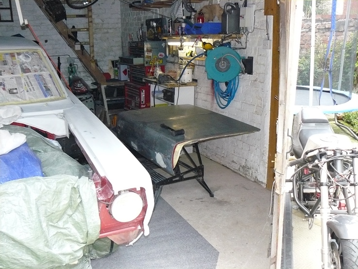

Posts: 8369
3 hours of block sanding done today on trunk, roof, driver door & front fender.
I am knackered! :shock:

Posts: 8369
Next bit of derusting done- rear wing tops and across the rear screen
Rear fender tops derusted.jpg (191.34 KiB) Viewed 2087 times

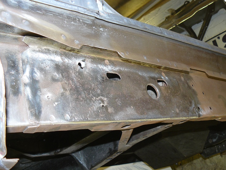

Posts: 8369

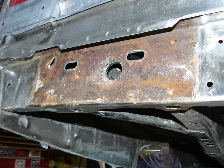

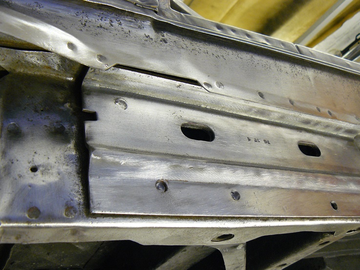

...and on to the rear panel, which is the rustiest bit of the car. I cleaned the worst off, then decided I can't leave the bumper mounts on as there's bound to be rust behind them.
Very glad I took the time now!
Still lots of Dremmeling and rust-kiling to do but the worst is off. The reinforcing plates are in my de-rusting tank now for a couple of days :thumbright:

Rear bumper mount 04. Rust now on me..jpg (208.34 KiB) Viewed 2080 times
Gettin there
Gettin there
Rear bumper mount 03. Worst of rust gone.jpg (187.16 KiB) Viewed 2080 times
To reveal- yuk!
To reveal- yuk!
Rear bumper mount 02. Hidden rust.jpg (204.32 KiB) Viewed 2080 times
Drilling out the spot welds
Rear bumper mount 01. Drilling out welds.jpg (190.49 KiB) Viewed 2080 times
