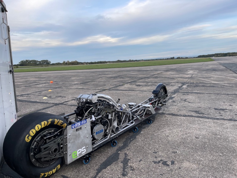

We left the old tank in place and gave it a little wash out with water still with the batteries inside it :D
Re: Fifty shades of Jade
189mph off the trailer :salute:

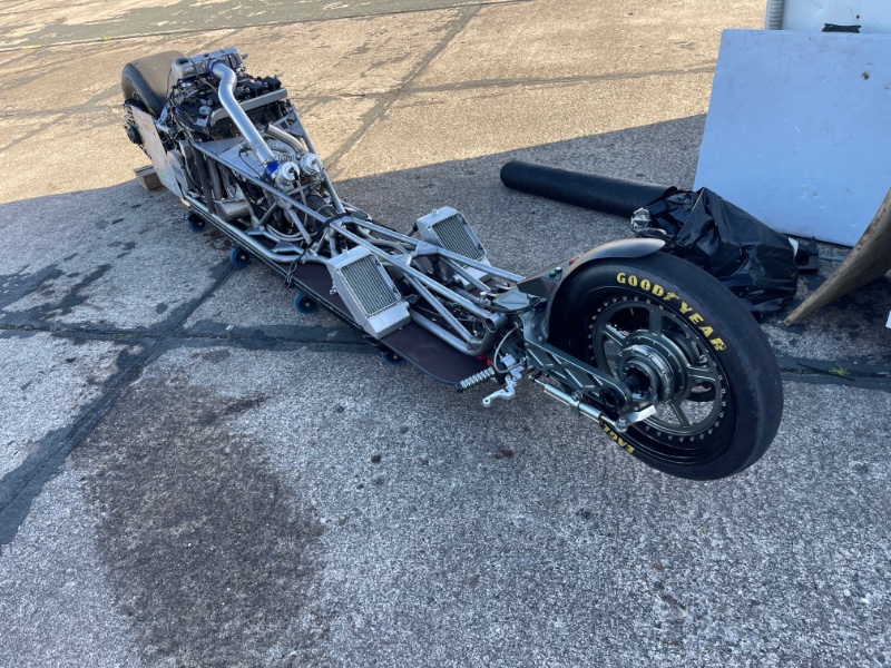

I have got this fancy suspension tuning tool using data logging to help tune the Air suspension so that needs work.
:read2:
Unfortunately on the last run, i will a bit heavy-handed on the downshift in the braking area and managed to grenade another gearbox and lock the rear wheel solid again. :pale: It was low speed 20mph and the bike is very stable so no drama.
Learning lots :D

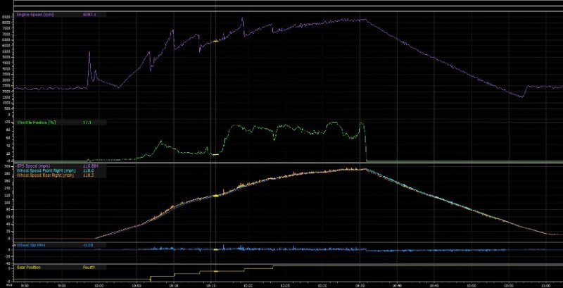

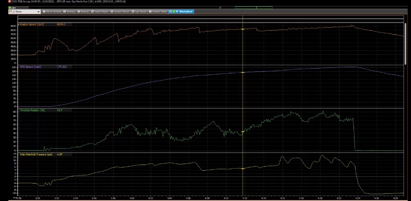

Off the trailer shakedown run
Click watch on Youtube
Adjust resolution to full HD
Ride along and enjoy a full 360` 5KHD
Log from the run below.
Watch the rear brake :lol: time to fit the parachute :D
192mph Log.JPG (56.46 KiB) Viewed 14144 times
I'm impressed that you can see the Slick wear indicators at 192mph!!!
Well done!

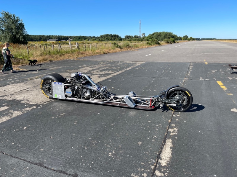

Hello, all hope everyone is well.
Still hammering away this!

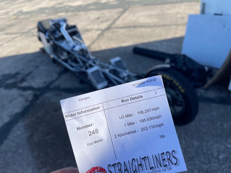

End of 2022 managed to just get out for the last time mainly working on gearbox control software which for once seemed to work well.
Stuck Guy on it and after a few .. laps of the Carpark the boy did 203mph with 180hp @ 40% throttle :rr:
The comment from him was your brakes are f@&king Bananarama! :D
But was very impressed with how straight and stable the bike runs
So plan for 2023 is to get the parachute system on the bike and get to the pod and try and put the gearbox control through some hard testing.
