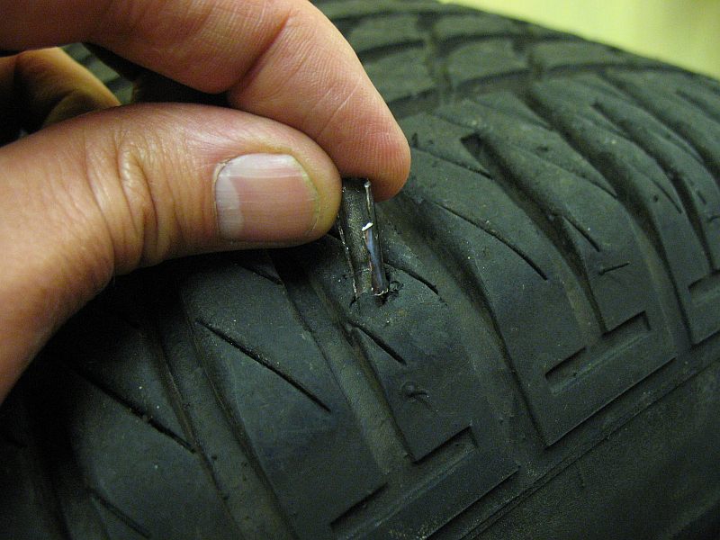

Found why the tyre went flat on the M1. Dug this out of the tread. :roll:

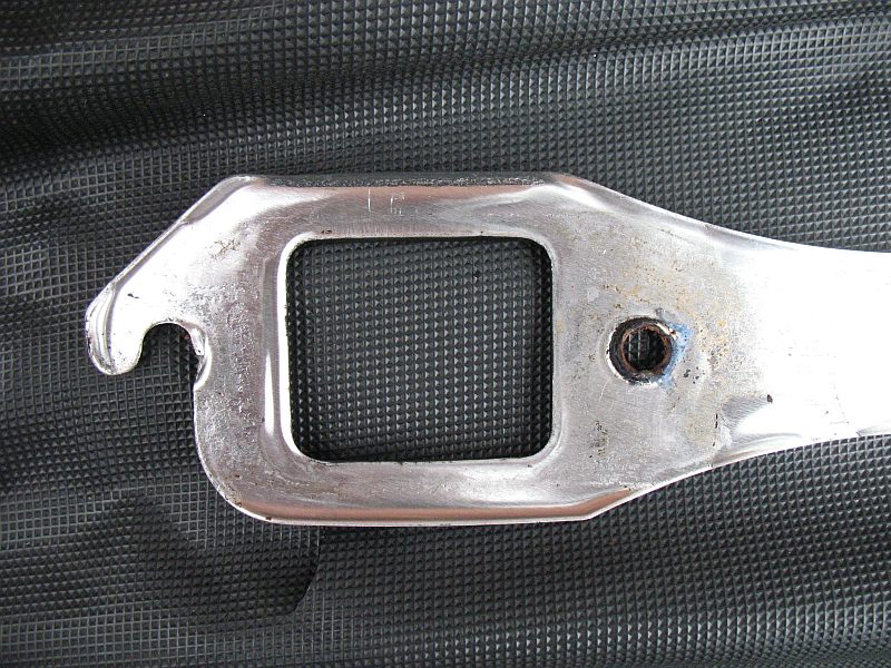

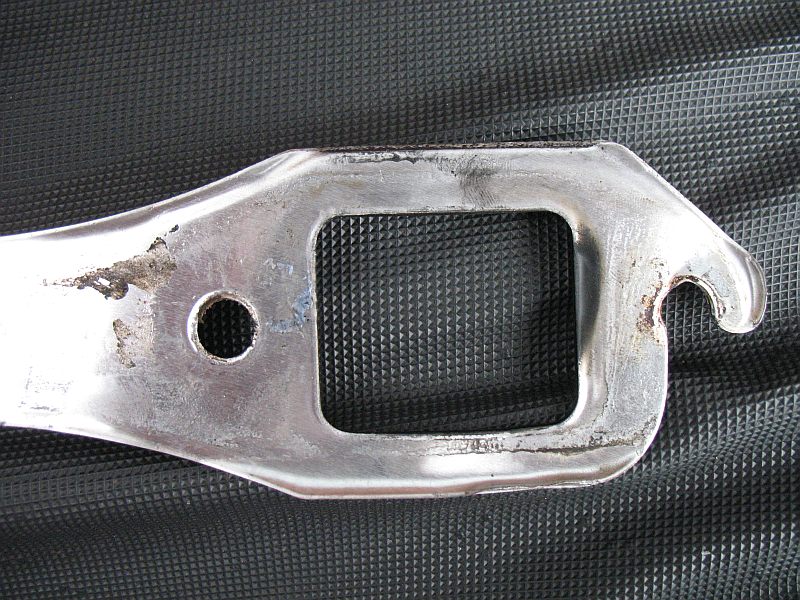

This is the inside face of the header gasket. The side that faces the head.
The two outer ports have no sign of any kind of leak from the port or bolt hole.

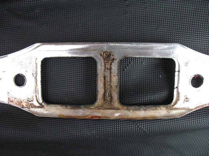

Post by Dave-R »
This however is the area I hear water boiling. There is no staining around the bolt holes but lots of staining along the bottom edge and between the ports. There is rust along the very bottom edge.
