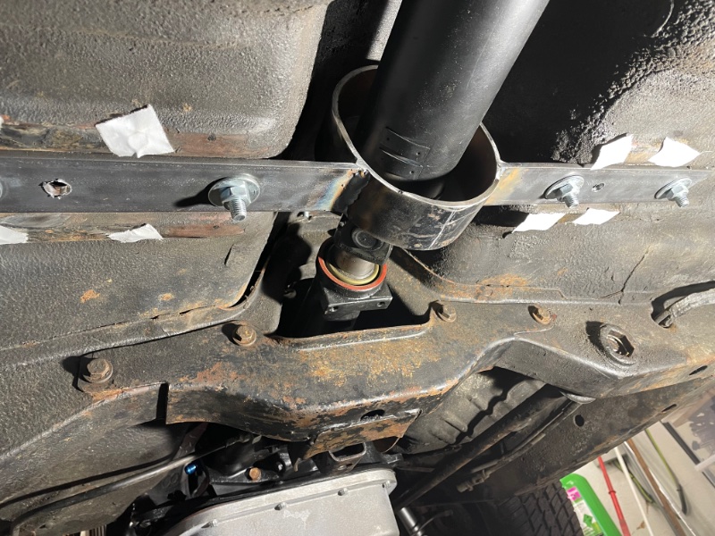

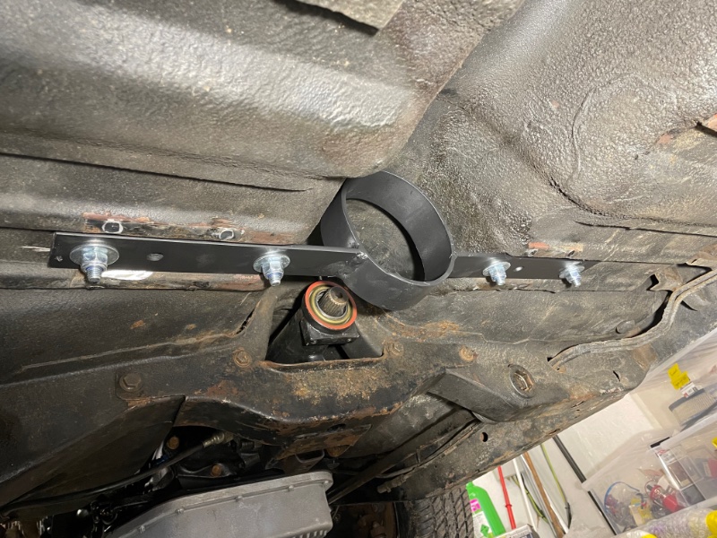

Prop loop made and fitted, bolts are tacked in from the top for easy removal. I consider this an essential if you are going down the track, certainly saved some damage when my yoke let go.
Posts: 6743
Good idea on welding the bolts, saves struggling when trying to take it off in your own :thumbright:

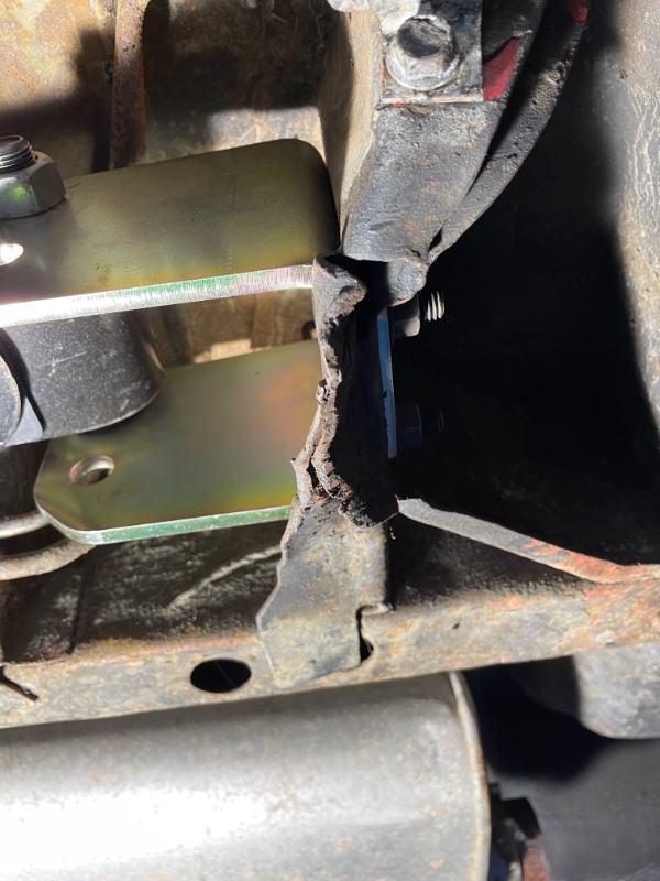

Posts: 14502

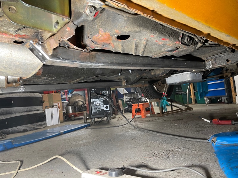

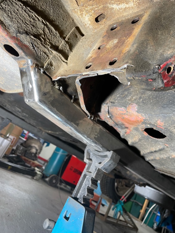

It’s a nice rust free car but it has been in the wars as it turns out. Rear drivers chassis rail had taken a hit and was properly mangled. Section cut out reworked and welded back in, still looks a bit Frankenstein until I properly Bananarama!.

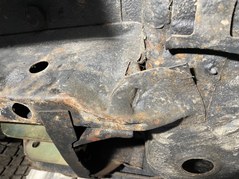

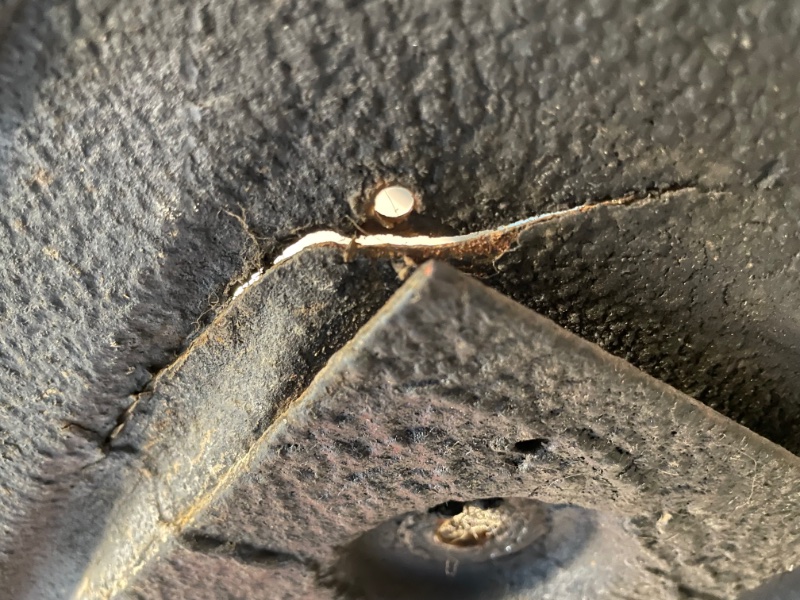

Posts: 14502

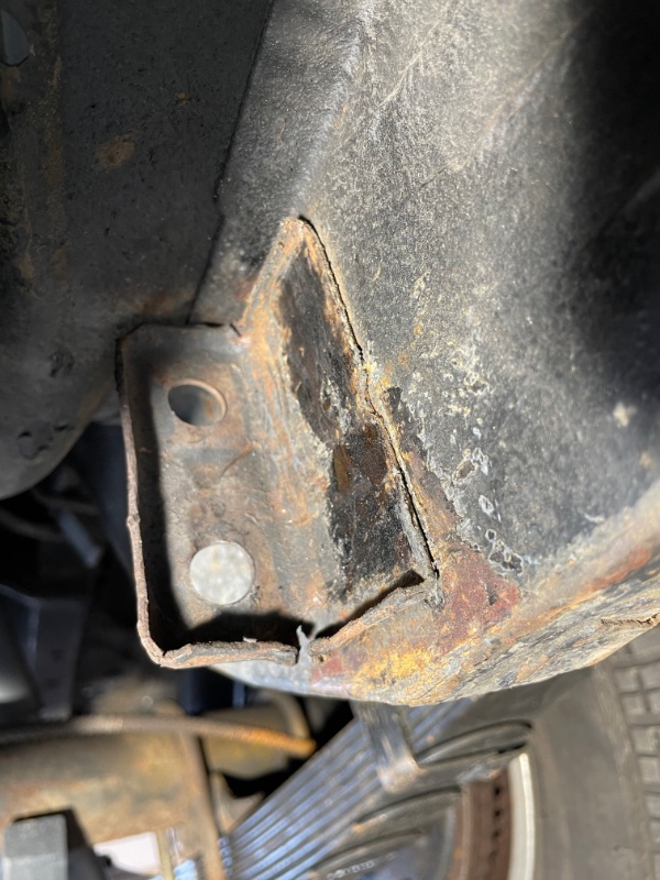

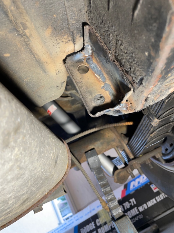

Floor pan and handbrake cable mount both split..

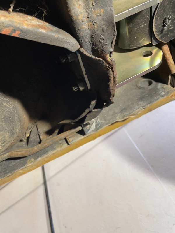

Posts: 14502

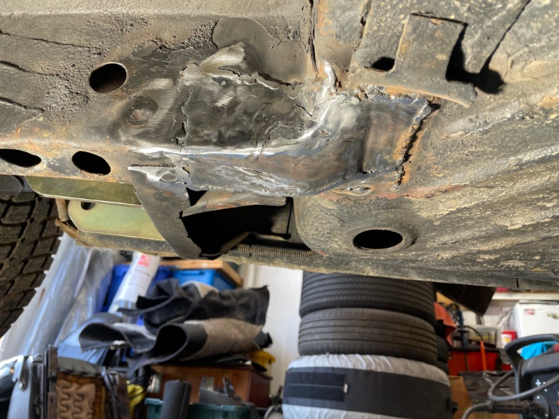

Passenger side spring mount has also taken a hit so that will be attended to in due course.

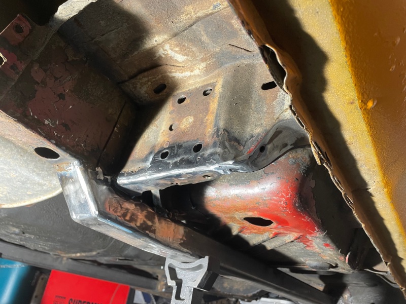

Chassis ties in, spring mount damage to fix next.

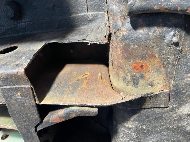

Posts: 14502

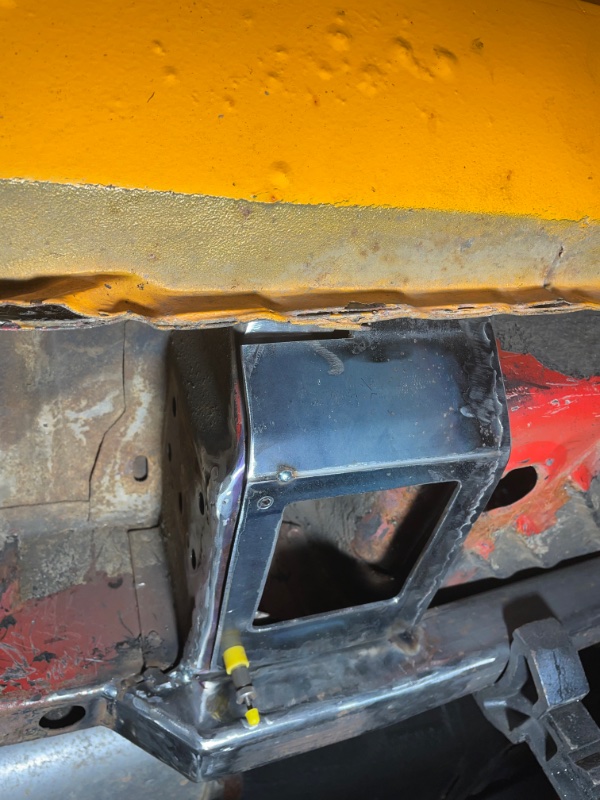

Damage chopped out, bashed straight and welded back in. One Torque box made, just needs final trimming before welding in.

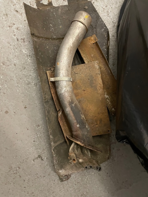

Posts: 14502
Removed a bit of dead weight…

Be careful Stu, he's started on the weight reduction...could be some more holes coming .. 8-)
Posts: 14502
I’ve just ordered a large box of holes….
Posts: 7133
Behave. :D
There is strategic weight loss, but no big holes.
You might be shocked, it’ll still have a heater! ;)
