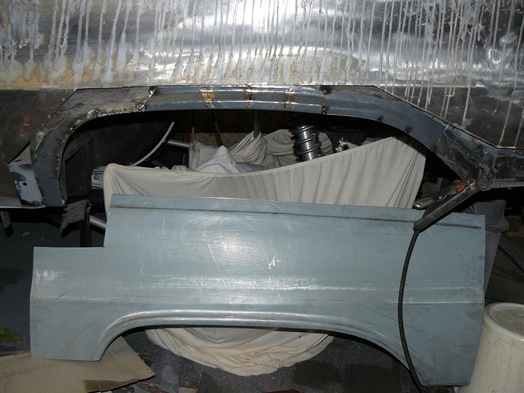

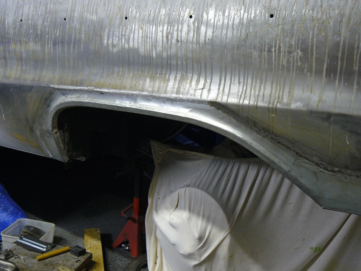

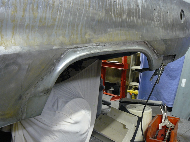

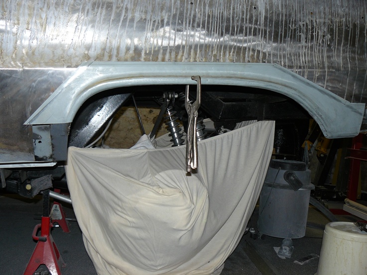

I made up the last couple of sections and finished tacking the inner arch today. I drew a grid on the good side and transferred the measurements onto this side. It's pretty damn close now :thumbright:
I trimmed most of the waste off the new outer but it's gonna need a LOT of fettling to get it to fit and look ok :evil:

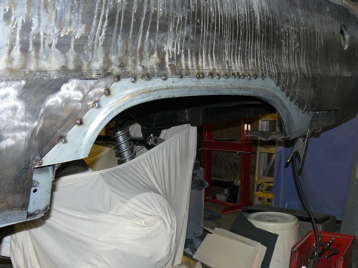

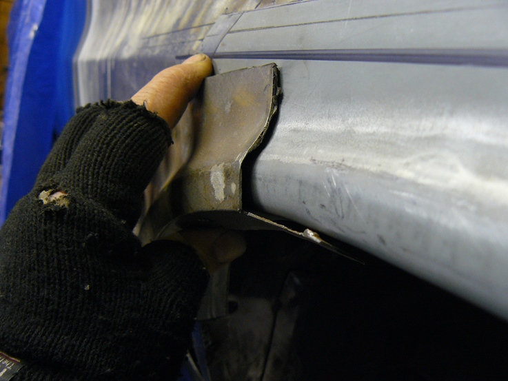

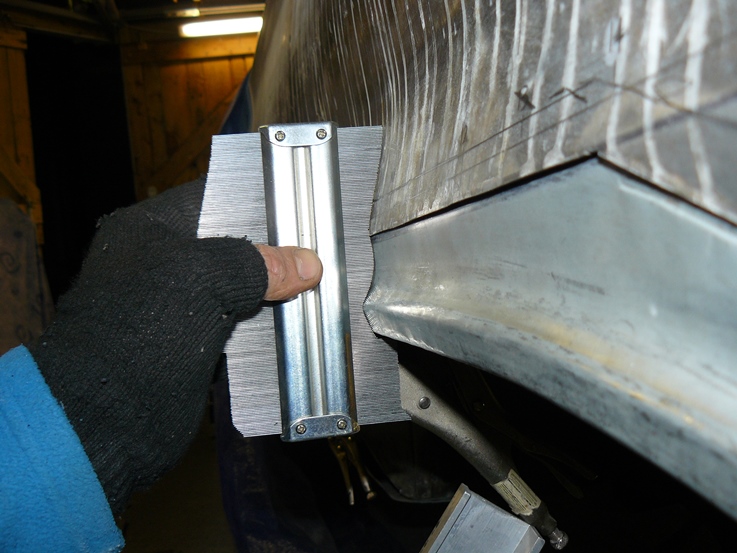

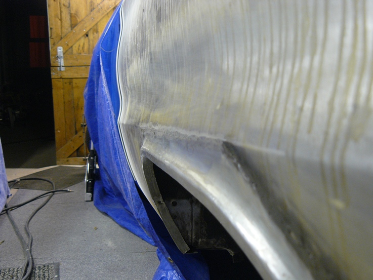

Well I reckon I'm as proud of this job as any I've achieved on this car!!
I've had several goes over the last couple of weeks at getting this crappy arch section to resemble the original and to fit the hole I made.
Each time ended in frustration and misery as I felt I was eiether getting nowhere or making it worse!
I cut it to shape with 1/2" overlap, then used my home-made stamp to re-shape the lip. This of course distorted the whole damn panel even worse than it was :?
I had the bright idea of using my profile tool as a guide from the opposite arch and I realised where I was going wrong.
02 Wheel arch profile from good side.jpg (176.75 KiB) Viewed 1431 times
01 Wheel arch, old and new.jpg (156.69 KiB) Viewed 1431 times
Posts: 8369
Eventually it all sort of came together and there it is, actually pretty damn close :thumbright:
06 Wheel arch fitted.jpg (169.64 KiB) Viewed 1425 times
05 Wheel arch fitted.jpg (172.43 KiB) Viewed 1425 times
04 Wheel arch fitted.jpg (177.13 KiB) Viewed 1425 times
03 Wheel arch tacked.jpg (199.4 KiB) Viewed 1425 times
