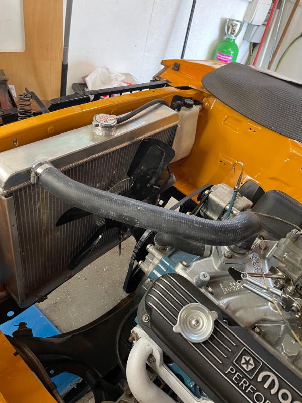

That’s the cooling system buttoned up, gotta have original moulded hoses, I can’t be doing with those universal elephants trunk things…
Posts: 7202
Couldn’t agree more! :thumbright:
Had to get used to ordering later hoses, though, the ones listed for 70 at Rock auto don’t fit!
2001 Dodge Ram Van
Posts: 14640
Just need to find a suitable shroud as a finishing touch.
Stu wrote: Wed Apr 10, 24 5:07 pm Couldn’t agree more! :thumbright:
Yes, they're not long enough.
Posts: 14640
I had to shorten both the top and bottom hoses a touch but the fit is perfect now.

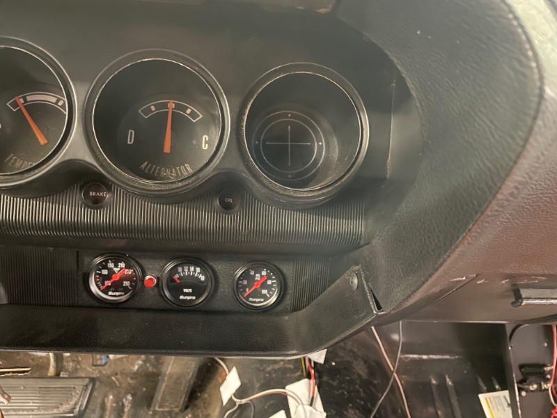

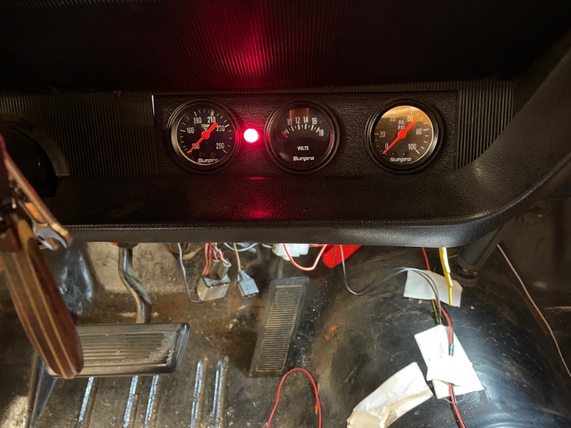

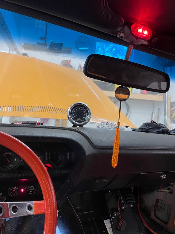

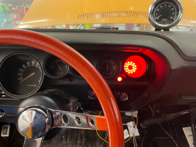

Bit of warning light action. Low oil pressure warning light, tucked out of the way but in line of sight, shift light disguised as a clock blanking plate, and a charge/ ignition light as the Denso alternator has provision for it.

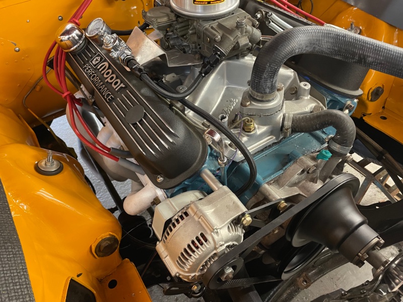

Fuel system boxed off, Carter HP mechanical pump with regulator and Teflon lined hoses. 75 vac sec carb for now until a suitable double pumper can be sourced.

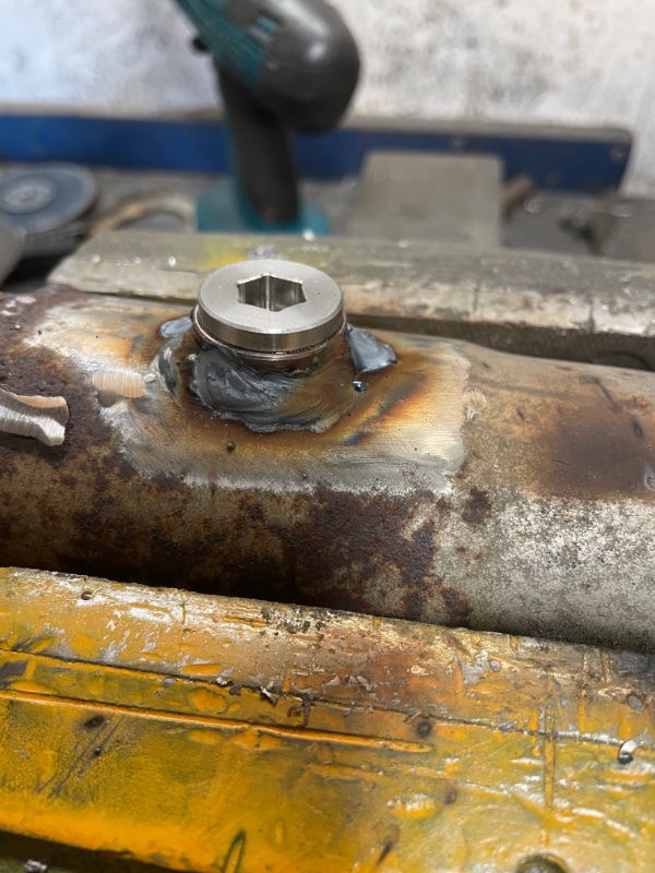

I always weld in a Lambda bung into the exhaust so you can tune with an AFR meter.
