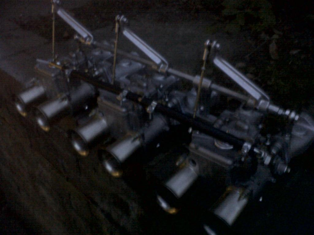

induction
standard 6 cylinder linkage was poor quality, the arms on it twisted round the cross bar under spring tension
R U B B I SH
AND it was impossible to get the carbs in sync
this problem traced to the centre carb studs not being aligned.
Right hand end of centre DCOE was 3 mm higher than the left end
left end aligns well with left hand carb and both ends of RH carb
so all carbs converted to left hand actuation- more money on bits i shouldn't need
original linkage junked
weeks of research on carb linkages
long email conversation with a certain Mr Ingless who does weber installs for chevys and fords AC cobras in the states...very nice man
confirmed i was on the right track
spent my lunch money on bits from VW places SCAT and CB performance
ended up with a Bananarama! cross bar linkage off a VW1500
rose joint on out runners
hex bar drilled and tapped 2 inches into each end
long bolt and locking nuts used to keep in place
CB performance arms and throttle pull grub screwed on
CB performance left hand a right hand rose joints and lock nuts attached
drop links were too long so invested in brass bar and some left and right handed dies
now have brass drop links with left hand thread on one end and a right had thread on the other....
need a hand knurl machine to Knurl a grip on the unthreaded section but otherwise can now twist 1 way for longer and 1 way for shorter.
result is the poor quality picture below

- IMG00272-20120226-1747 (Large).jpg (62.02 KiB) Viewed 3086 times
yeah hardly subtle...but robust
function over form
ideally levers would be lower but shorter drop links exacerbate the off plane angle of the brass rod in relation to the lever on the carb producing a kind of variable action on the peddle travel front per % open for throttle
ideally like to keep it linear otherwise throttle action would be tres odd
options for hacking bits off later and re threading if necessary.....
need to set up suitable throttle cable clamp as well
original mounted on 2 cylinder head studs
mine never had webers so i have all bolts....
need to bodge something up on the rocker cover until new engine with studs takes over....
function over form

Most carb systems have a non linear opening rate when you think about it. The primary blades open 50% before the secondary side and the secondaries open all the way with the last 50% of movement.
Of course they share a common plenum which is different but I don't see a problem with a non-linear opening as such if it made things neater or if it was needed for clearance.
no neither would I
but a weber with a strange none liner opening might be good...but might not...
most OEM setups are carefull to make sure actuating lever on linkage and on carb are the same length
that the only bit i couldn't achieve if i wanted the full peddle travel
hence all attempts to keep the action of the linkage arm directly parrallel to the carb lever motion at the mid point resulted in the arms sticking up in a odd way
a right old fiddle
might set it up so its starts out parrelell and gets worse as we go on as most driving is done at a smidge of throttle.
